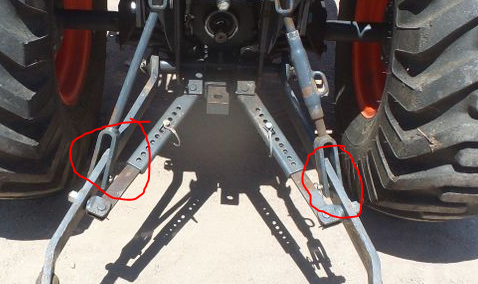

This is not your tractor - but the rear may be almost identical .........
Notice where the lower arms are pivoting - sometimes there are another set of holes that can be utilized by moving the pins - this will allow the 3 point to raise up or down a bit more DEPENDING on what holes is being used
Yeah sadly it is already using the set of holes that enable it to go higher.
