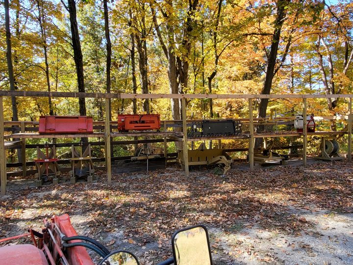

2 - 2x4's across the center, like floor joists.
If you can put 2x6's across the bottom and buy steel wheel casters, the racks can be pivoted from the wall for loading and then swung back.
Working on a "Kubota toybox" myself

Greetings to you and your 4 year old post regarding attachment storage. I saw and like your outside rack type shelving. If you are still active on the forum, would you mind telling me about rain and winter coverage? Are you throwing tarps over everything? Or do you put them in an enclosed spot for Winter and this is only your Summer storage. I don't really want them exposed to the weather, but this may be how some do it.
I will need to figure out something for mine: Shovel, Grapple, rear blade, pallet forks.
Thanks. If you are doing something new and better, we need updated pics!
