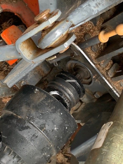

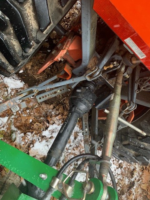

I have a B3030HSDC. We got our first snow today and it took me half an hour to connect my rear mount snowblower to the rear PTO shaft. I cleaned/lubed the splines (twice), tried to use a crowbar to coax it and made sure to pull back on the "collar" to release the ball detent while installing.
It's an awkward spot with your arms stretched out and working sideways with limited hand access due to guarding.
I finally got it by laying on the ground and using my anger to push the shaft into place. I'd rather not get to the point of frustration every time.
Any suggestions for making this very simple process easier?

I ran through options with my Dad a month or so ago on his M7060. He was having a hard time getting the PTO shaft engaged with the tractor, and hooking up links.
1. You may need to grease the inner tube and sheath so they slide easier. Take that apart and check for anything that might catch (ie metal burrs, etc). YOu can add a bit of grease to help them slide before you put back together.
2. A quickhitch makes it easier to hook up the top and lower links to implements. Make sure you have appropriate bushings if you arent all CAT1. If you are, then a QH10 should do it.
3. We went with a PTOlink. https://tractorptolink.com/. Here is how I made it easier. I used a tie down strap that you wrap around the top link shaft and the PTO shaft. This will suspend the PTO shaft in the air so you dont have to hold it up yourself. Then you merry the male/female pto link pieces, rotate to lock into place, then add the 2nd pin. Honestly I dont think for me (im in 50s) the ptolink is easier. But for my 80+ year old Dad it is a game changer.
