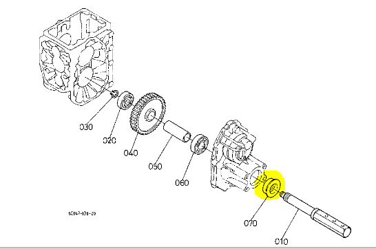

The rear seal on my 1999 B2100 has developed a slow leak after some vines got wrapped around the shaft and some of it worked its way into the seal. I carefully removed the material but it must have slightly scored the seal.
I'm considering using some ATP-205 Reseal to see if it stops this leak rather that the tremendous cost to replace the seal. ATP-205 gets rave reviews by many and is a plasticiser that is completely safe for rubber. Problem is... while it is great for rubber seals, it can apparently soften and degrade teflon/delrin/plastic seals, etc.

I wouldn't suggest using any sealing agent of any kind.
A simple cheap seal replacement could cost you thousands in a hydrostatic trans replacement.
Replacing that seal is a very simple job, and a person with limited space and skill can do it, there is not anything complicated about doing the job.
And I wouldn't call $7.34 for the seal and $6 for Anaerobic Sealant a "tremendous cost". ;)
Drain hydraulic fluid, Jack it up put it on stands, remove tire, unbolt housing, remove one E-clip, remove gears and spacers, remove seal, replace seal, reinstall parts, refill with oil and done.

Doesent look like a difficult repair. I would consider that over the additive.
