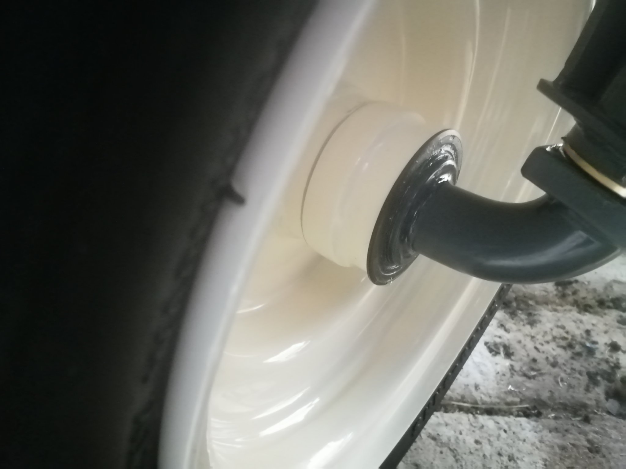

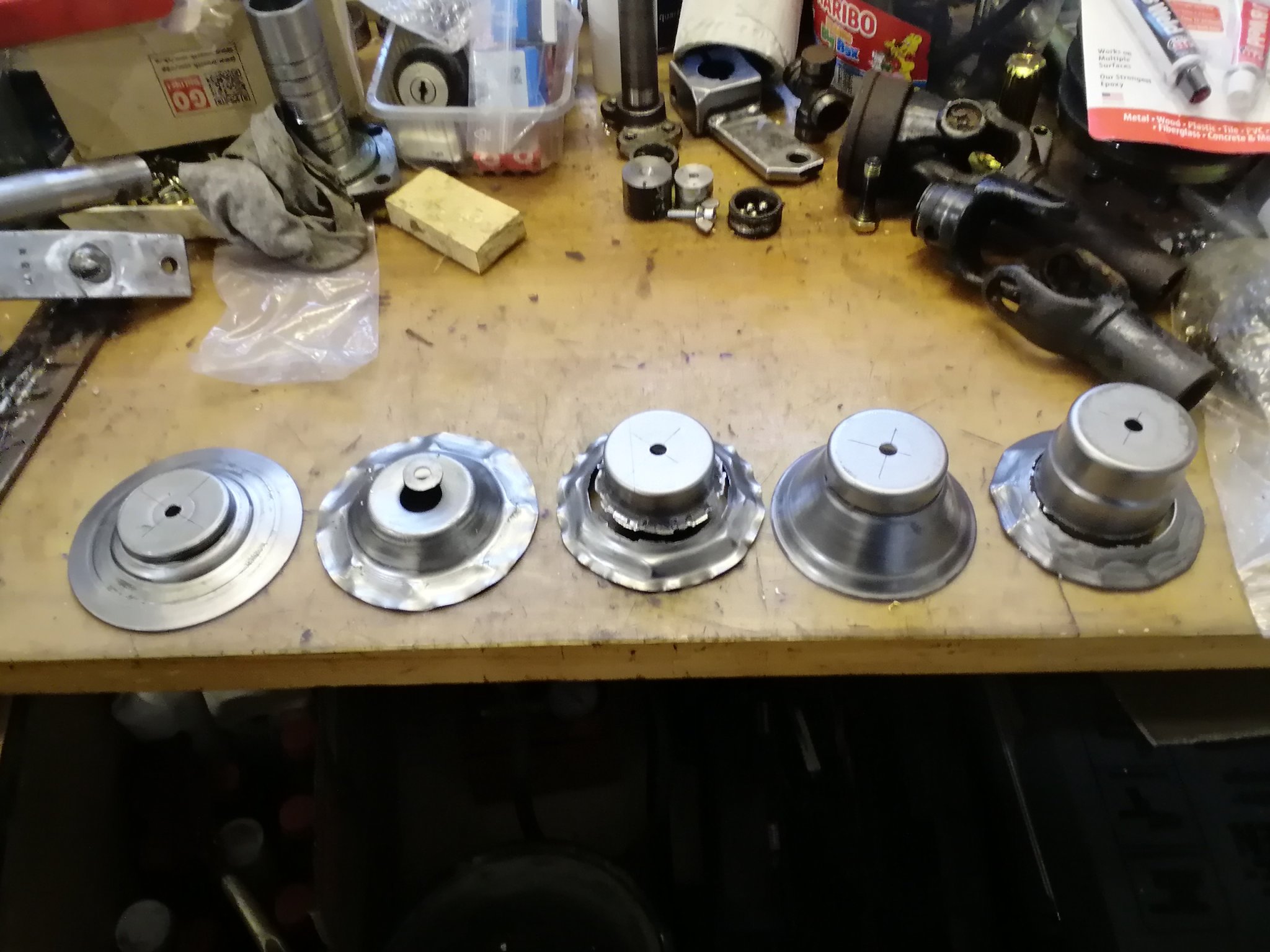

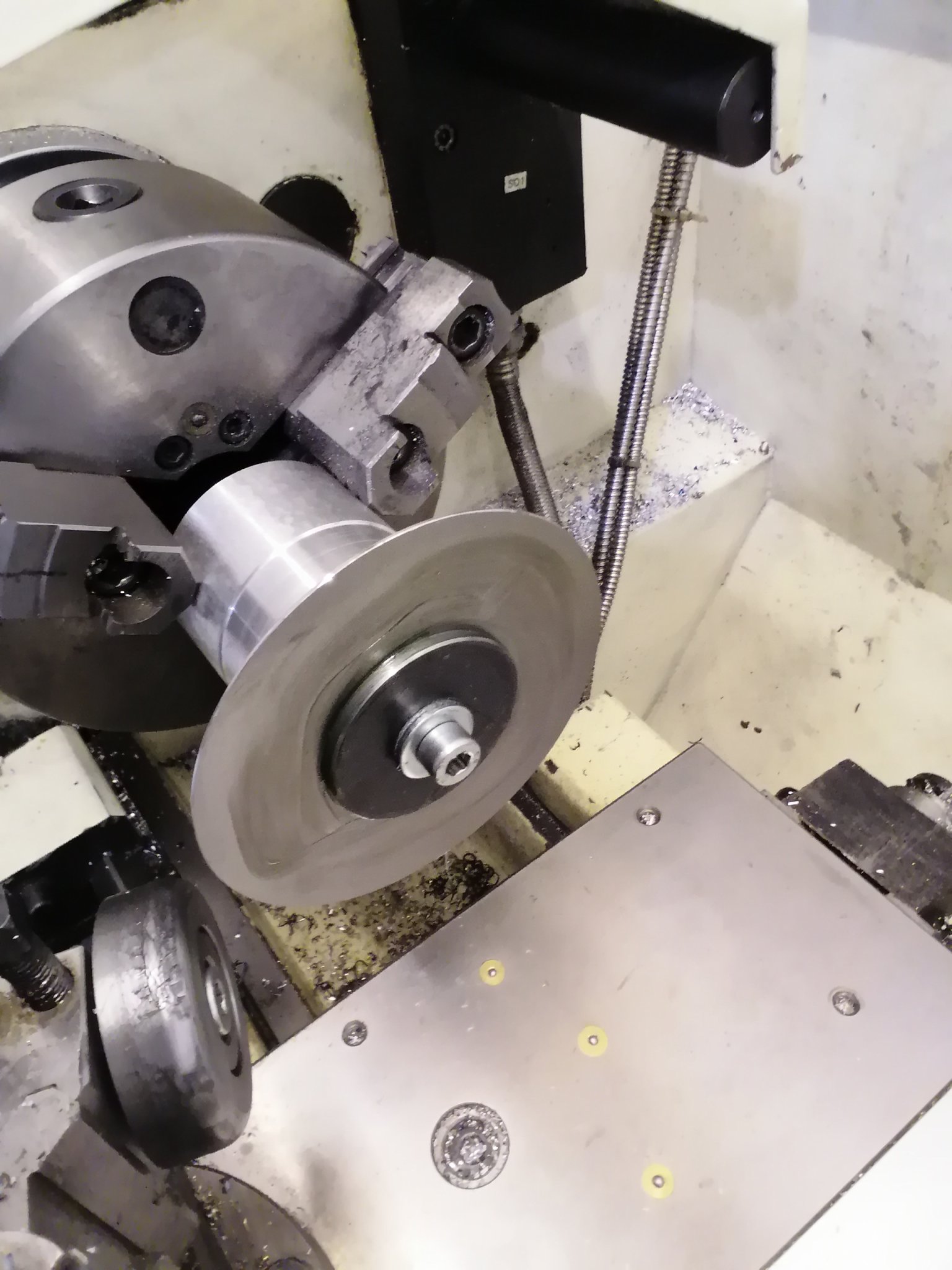

Did some parts myself recently for my G1900. Would not be as good as your man in the video but after a few attempts I got the parts made. First pictures are seal ring adapters for the front wheels and the last one is a hub cap for the front wheel.
