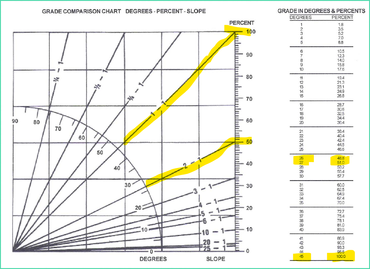

No way this is safely going up that, regardless of the tires.
50% maybe?
I wouldn’t consider taking a wheeled machine up any slope greater than 35%.

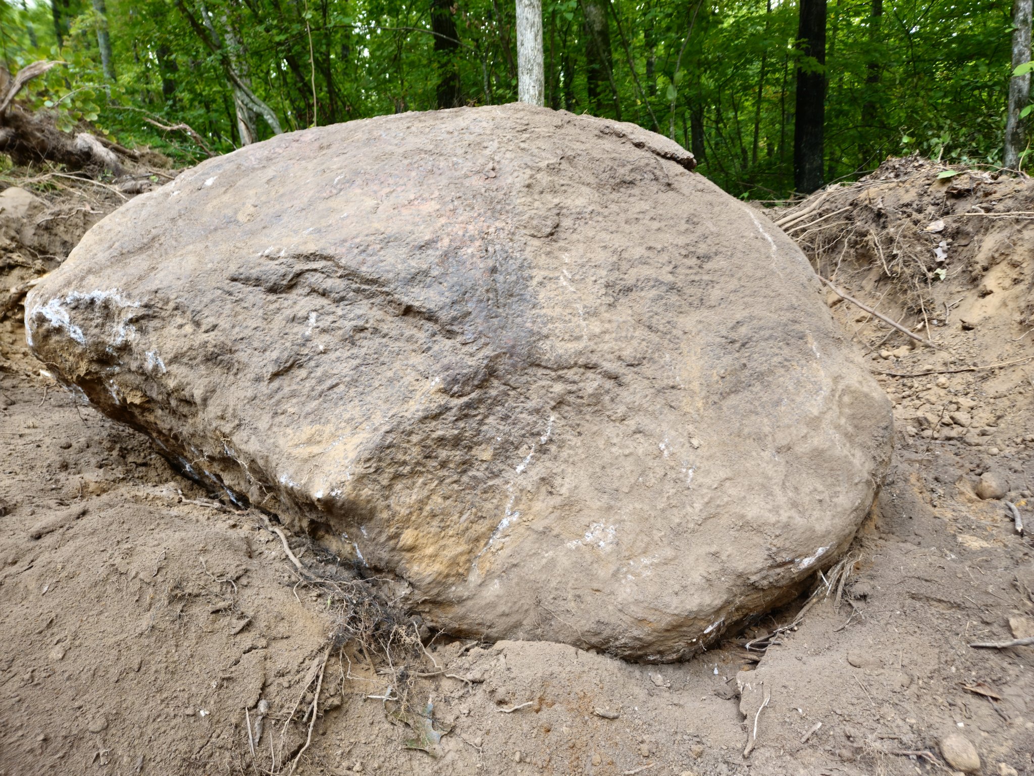

It also depends on the type of rocks. Like in Texas we in Wisconsin have granite too, and I advise not smacking into it with a tractor.

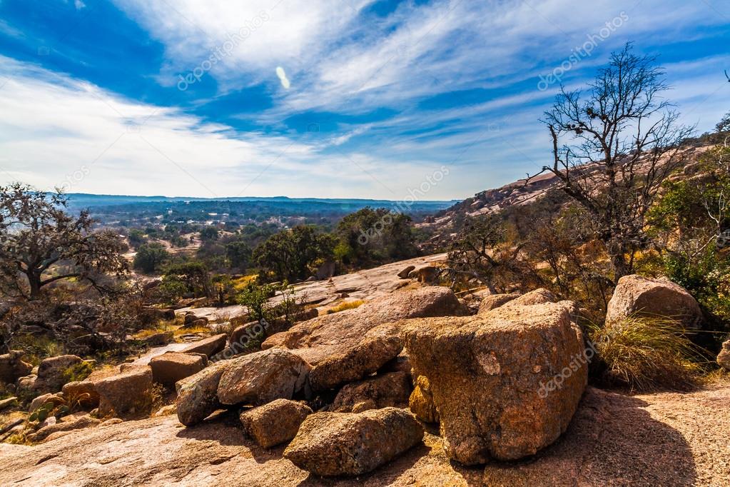

Texas granite
Wisconsin granite, from under a maple tree,
about 4.5' H x 5.5' W x 6.5' L
(and more than the BX can move :()

A 35 degree/70% slope is steep even for a 4WD tractor, and never sideways. If I couldn’t traverse grades that steep, I couldn’t access well over half our property. 4WD with R4’s handles it FAR better than 2WD with R1’s and causes less damage to our dirt trails. We don’t have rocks. Ability to go up and down safely depends on a variety of factors. There are some pretty good threads on here discussing the issue.
