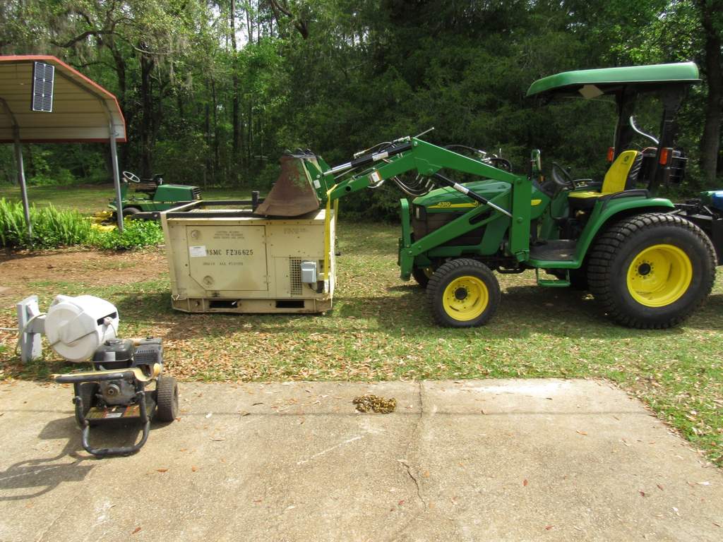

Depending on your frequency of need and budget you might get by with a set of clamp on forks. I've seen some worry about them bending buckets but you should be able to add something to spread the weight to prevent that.
I have used a set of clamp ons with straps to move my 1100 LB dry weight generator without bending the light duty bucket of my John Deere. I did put the rear strap around the loader frame to limit the pull on the forks but more than half of the weight was on the tip of the forks. I also only picked up just off the ground so I wasn't trying to load it on a trailer or anything.
If you have bucket hooks you can strap the front of the load to those. If you don't have bucket hooks you need them.

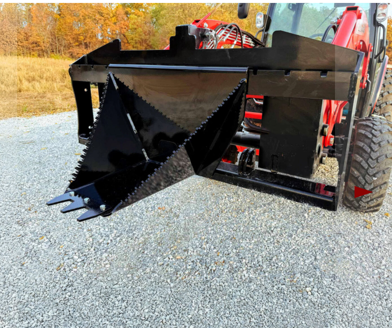

GoodWorks has what they call VersaFork, which is SSQA and 3PT, has an assortment of hooks, 2” receiver and something they call a “wrecker” (shown)
I just pulled a big stump, and THAT would have been useful.
With the wrecker bucket I didn’t plan on and 42” forks , it looks like around $2k.
Yeah, that’s what I went with.
My reasons
1: Three point compatible is a big one. My B7500 doesn’t have a FEL. It is a dedicated lawn mower.. I like having the ability to use it with that.
2: The 2fer with the “Wrecker” stump bucket. I have a couple stumps the Titan puller couldn't budge. Digging them out will probably be first use for it.
looking around on the internet, this has a lot of extras.

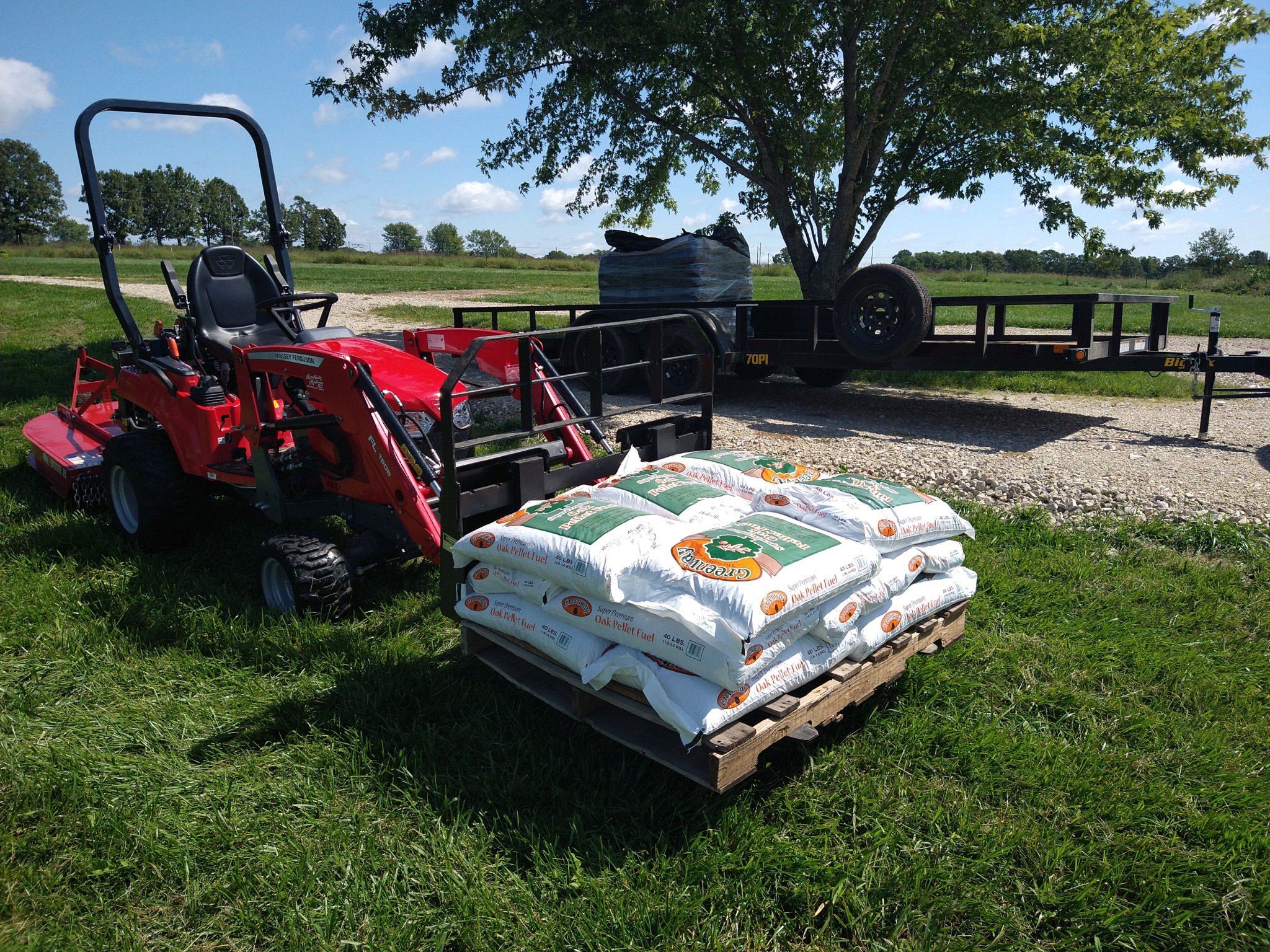

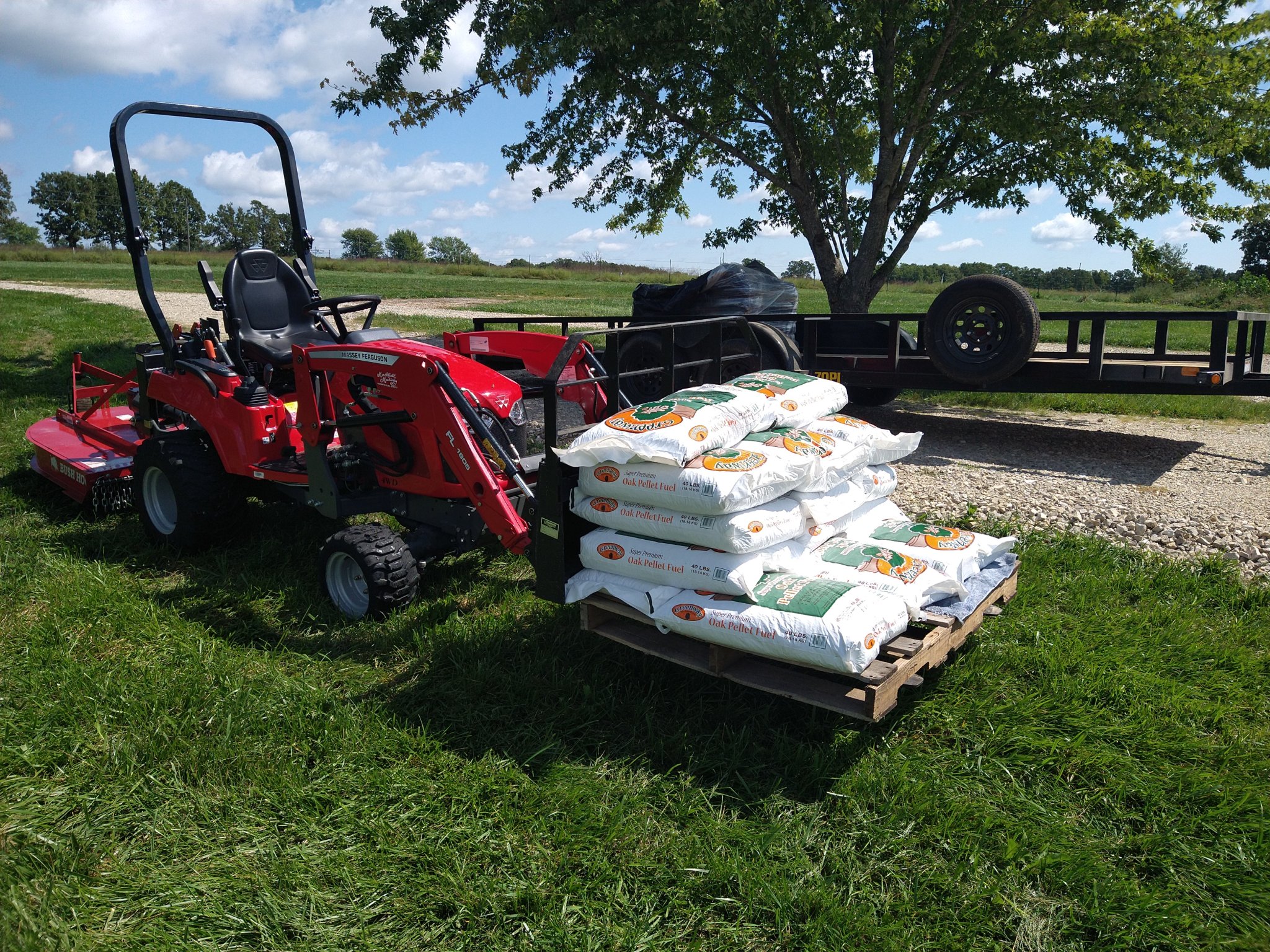

With limited lift capacity, like stated above ... The closer your load is to the pins, the more you can lift ...
This is as high as I could lift this load.
That's a "standard" 40" X 48" shipping pallet, grabbed sideways ... Since my little tractor couldn't lift the whole 2,000 Lb pallet, I had to restack these ... Next load ... I got an extra one on!
I bought mine during the "supply chain COVID crunch" mine are rated at 4,000 Lbs, and are 42", but all I could find at the time. (Way too big and heavy for my Little SCUT!)
