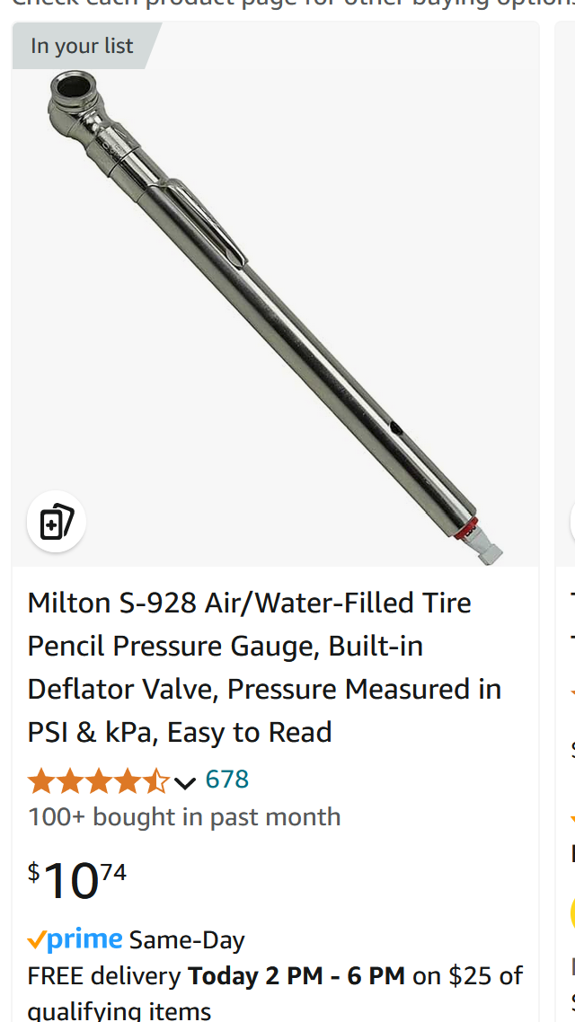

If the tires are filled, make sure the valve is at the 12 o'clock.
As @Tarmy said, there are pencil gauges made for filled tires.
Simple to take apart when/if they get clogged.
This is one I have
