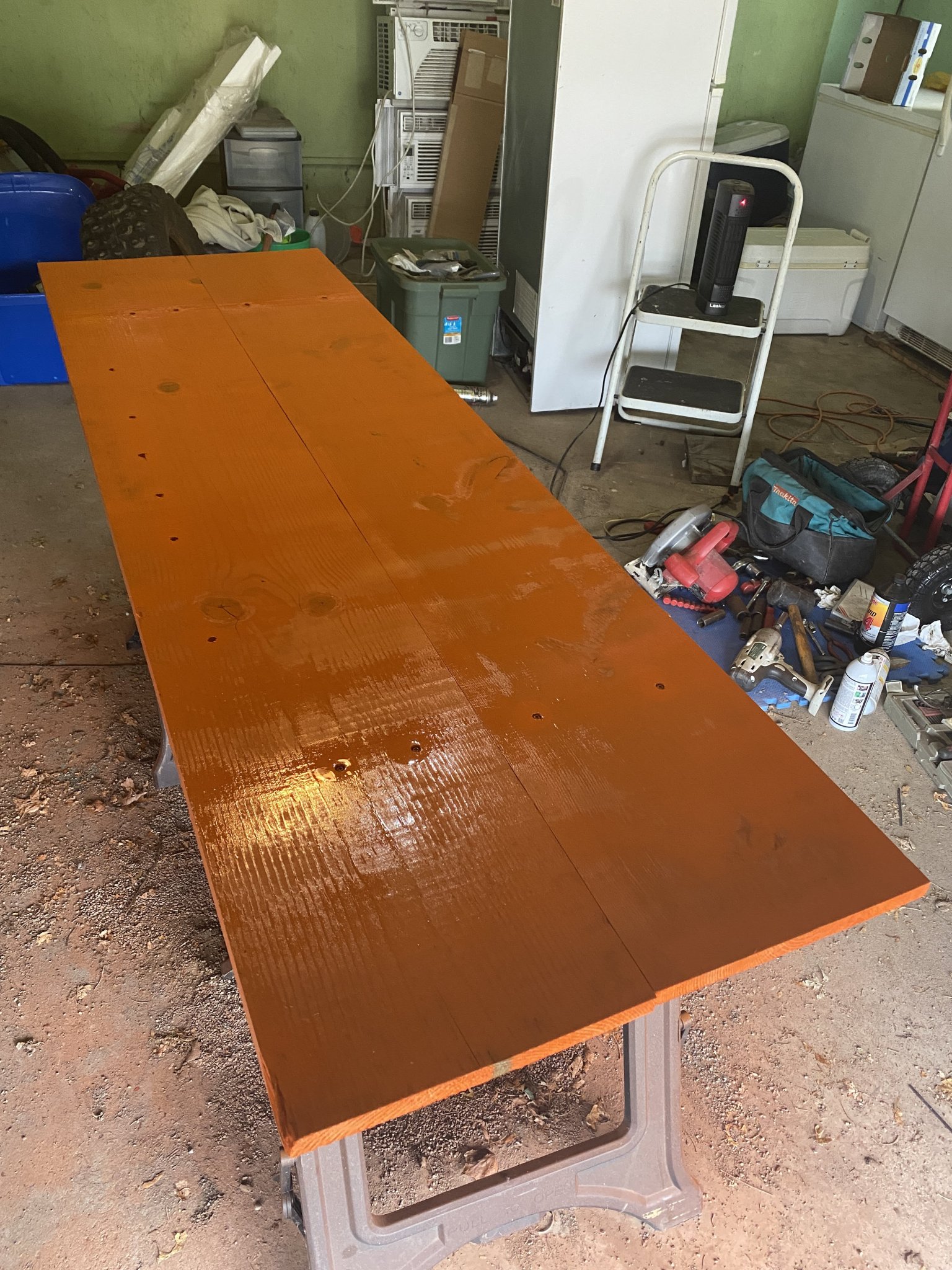

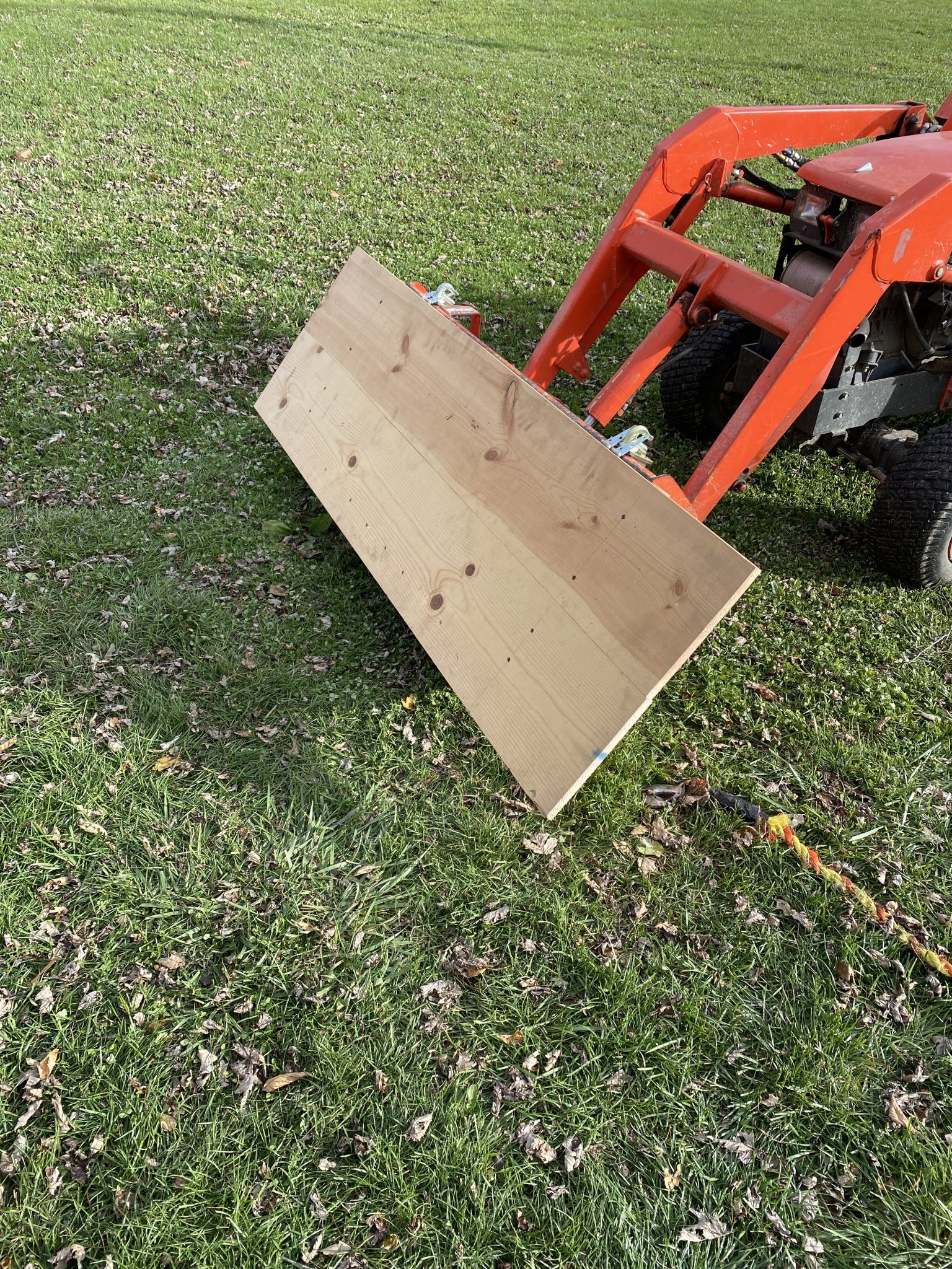

This is a project I started a while back. A snow pusher to attach to my bucket. It is still sitting the the garage not completely done. We didn't get much snow last year. Biggest problem is figuring out the best way to attach it to the bucket. Brief testing showed it pushed well, but would come lose fairly easily. Still need to add some corners to it with maybe do large aluminum angle and need to use something on the bottom as a skid surface. Maybe we will get a lot of snow this year and it will encourage me to finish it.
