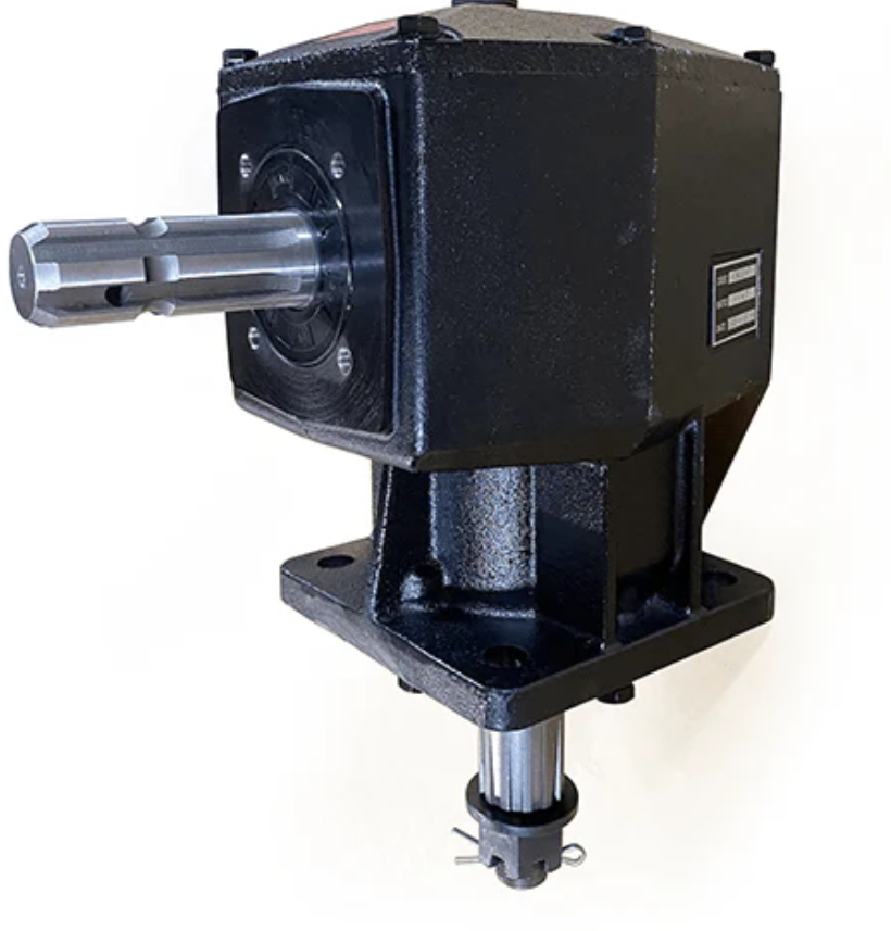

I accidentally done goofed and cracked the gearbox where it bolts into the mower. I was thinking about either welding it back together or buying another gearbox.

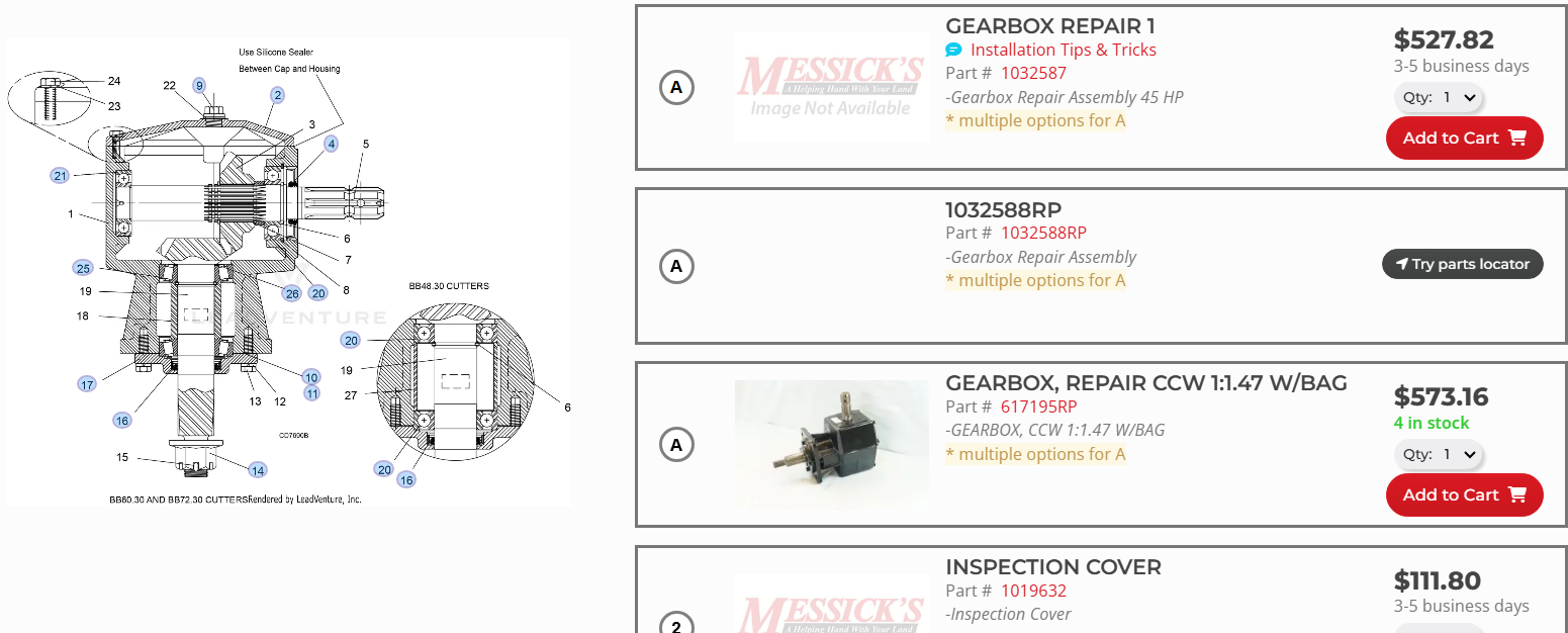

Ive been trying to do my research regarding my 2019 bb72.30 but I cant find any gearbox HP specs for the 2019 model. I see that the 2025 model is 75 hp but I dont think mine is that high.
I found a seller with a 45 hp gearbox and just want to see if that should be good for a replacement.
mower going on a kubota m5660
thanks
33,696
8,913
It's not a 45HP gearbox, if it was your 50PTO HP tractor would be too much for it.
It's a minimum of a 75HP gearbox.
