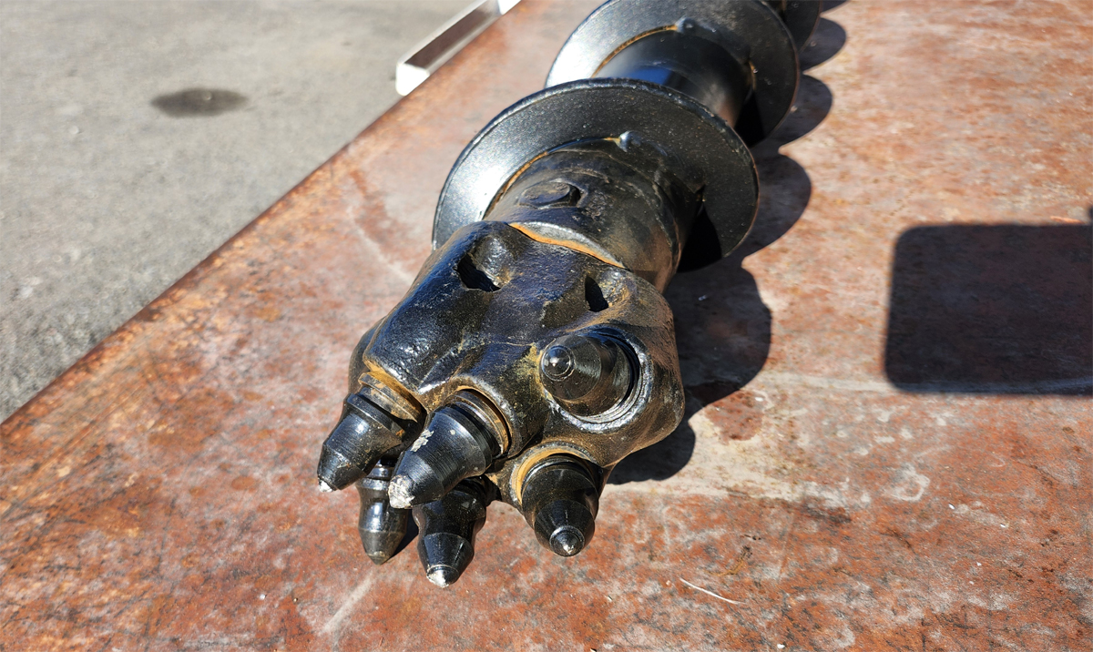

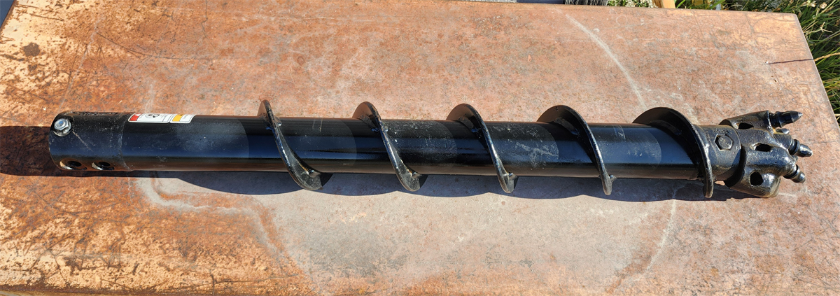

I picked the rock auger up yesterday. Here are a couple of photos. The cutting "teeth" are replaceable.
