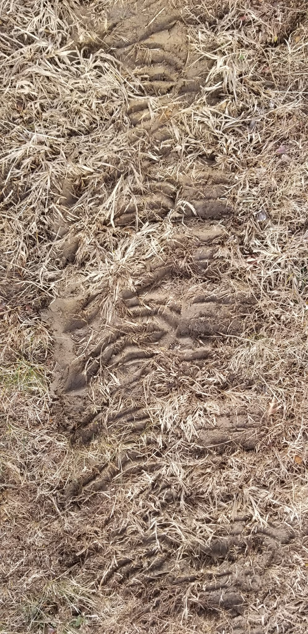

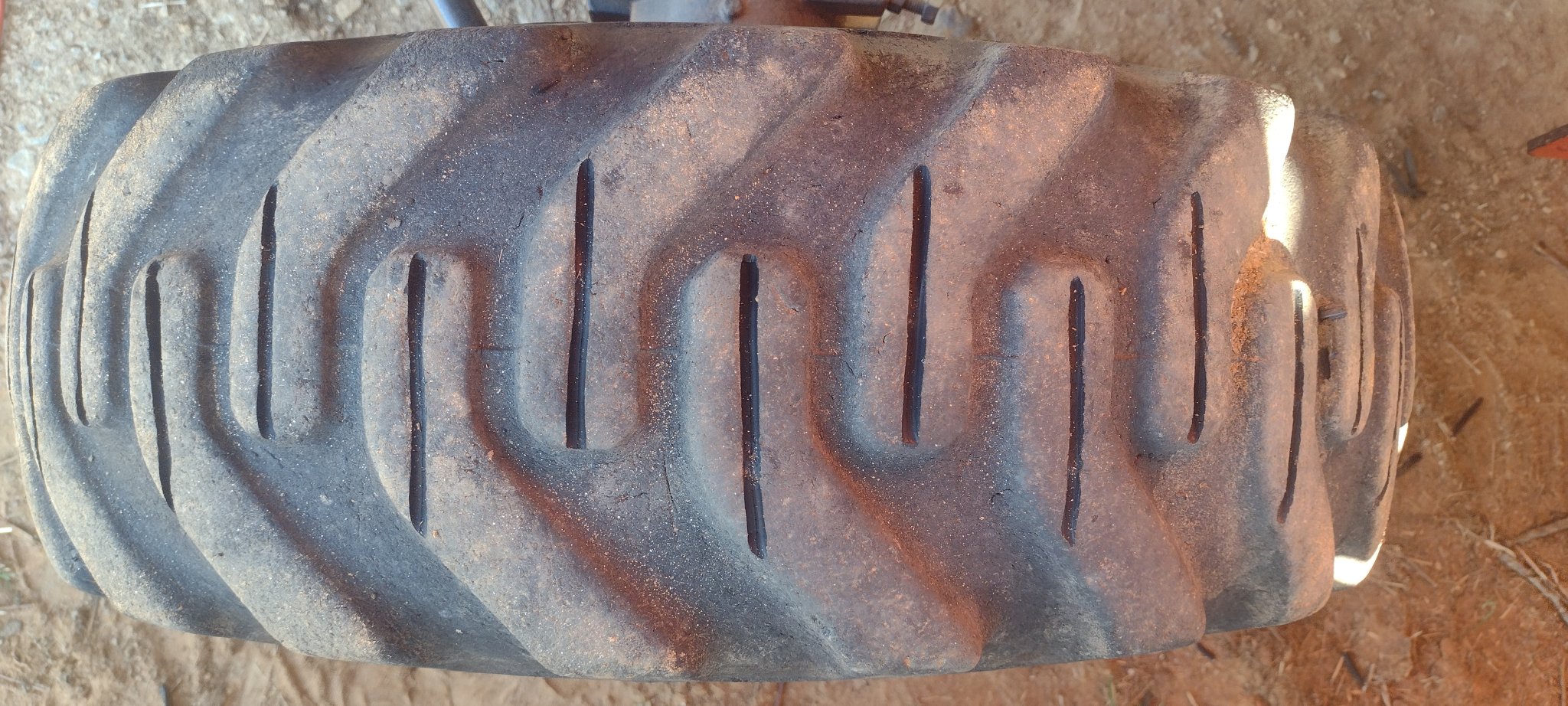

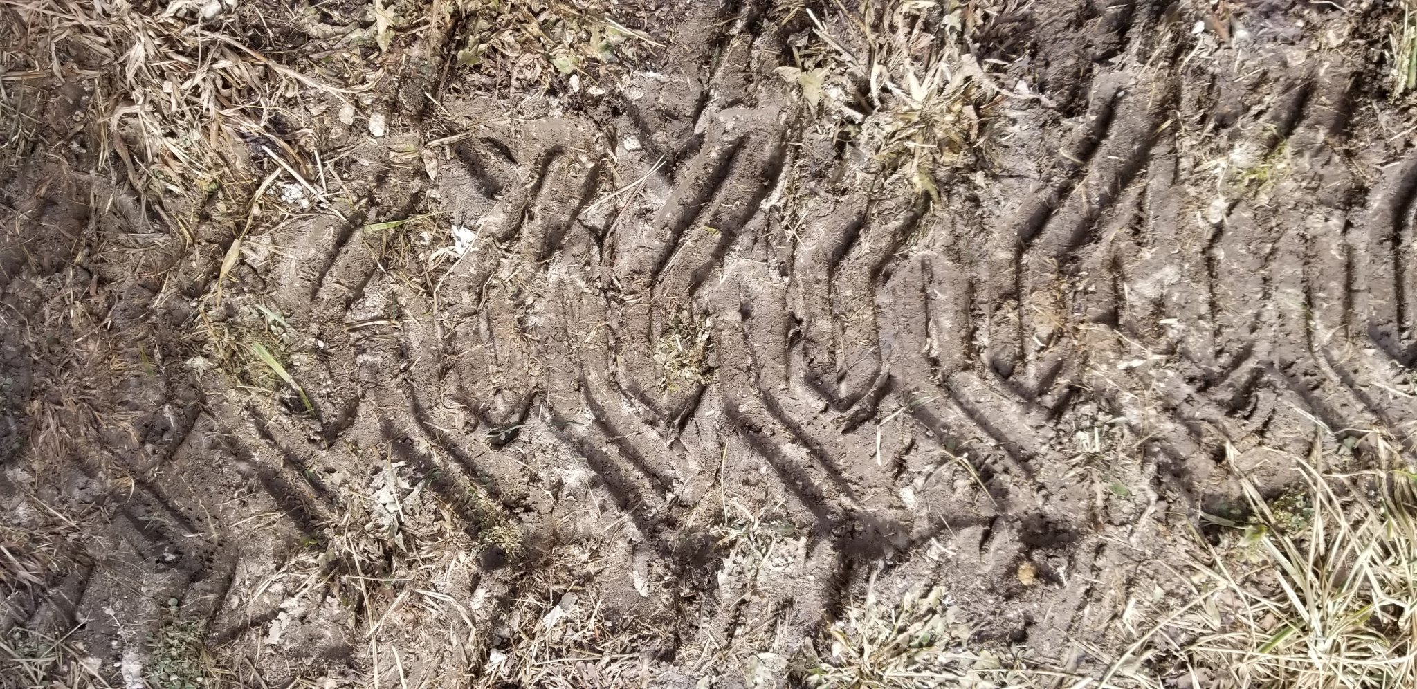

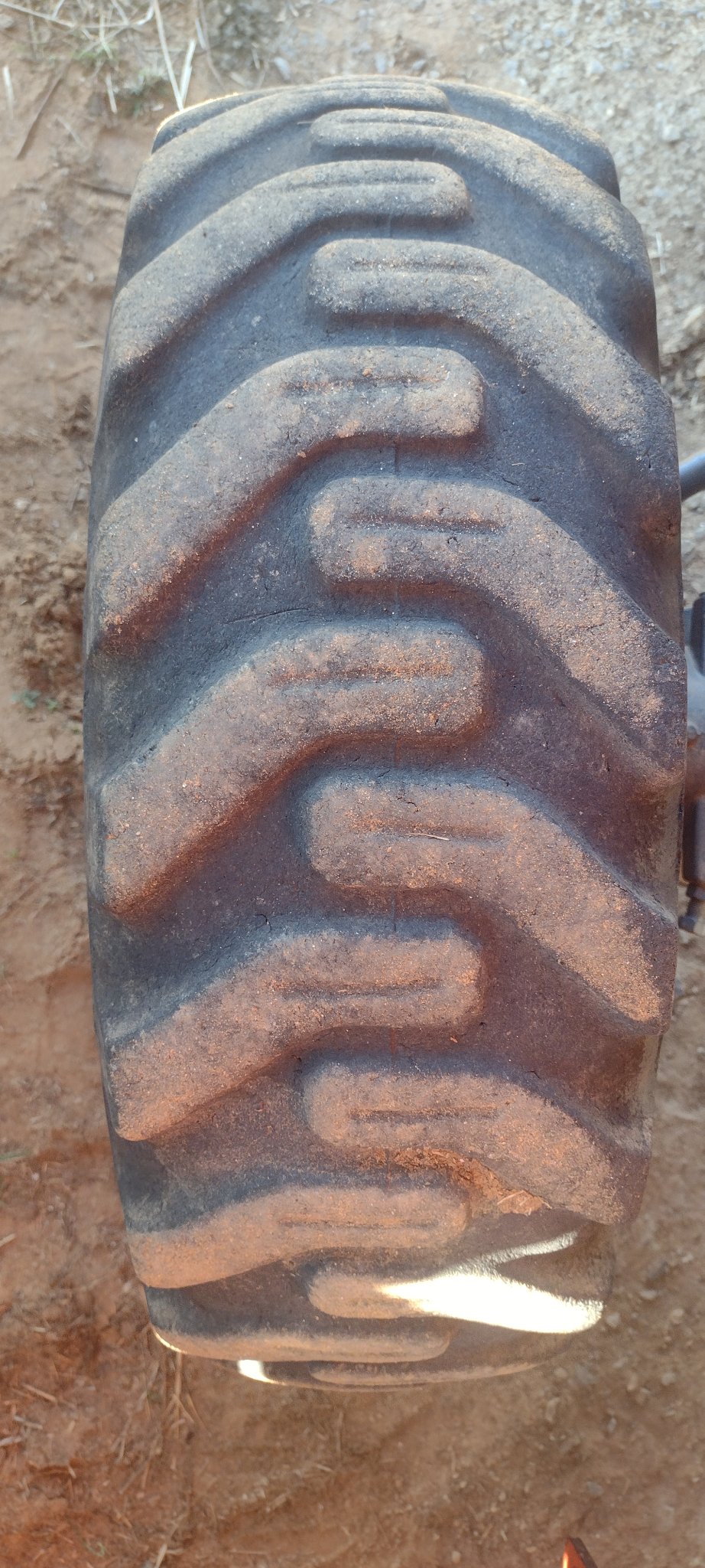

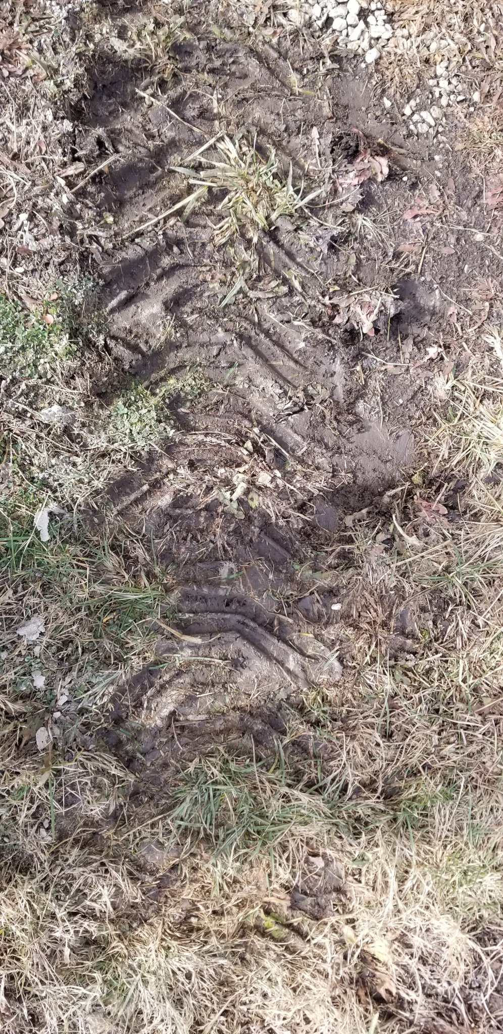

Here's an example of how grooves in R4s help grab. This was in slightly damp soil, but the same results in snow. These are well worn tires so I start in about 1" from the outside to help protect the tire on turns.
