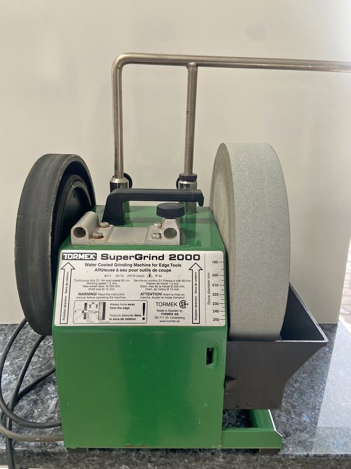

I picked up this Tormek 2000 machine yesterday
looking forward to learning how to sharpen up some long overdue kitchen knives and everything else.
It came with a bunch of accessories and a book so I need to read up.
Of course first hand knowledge tips are welcome.

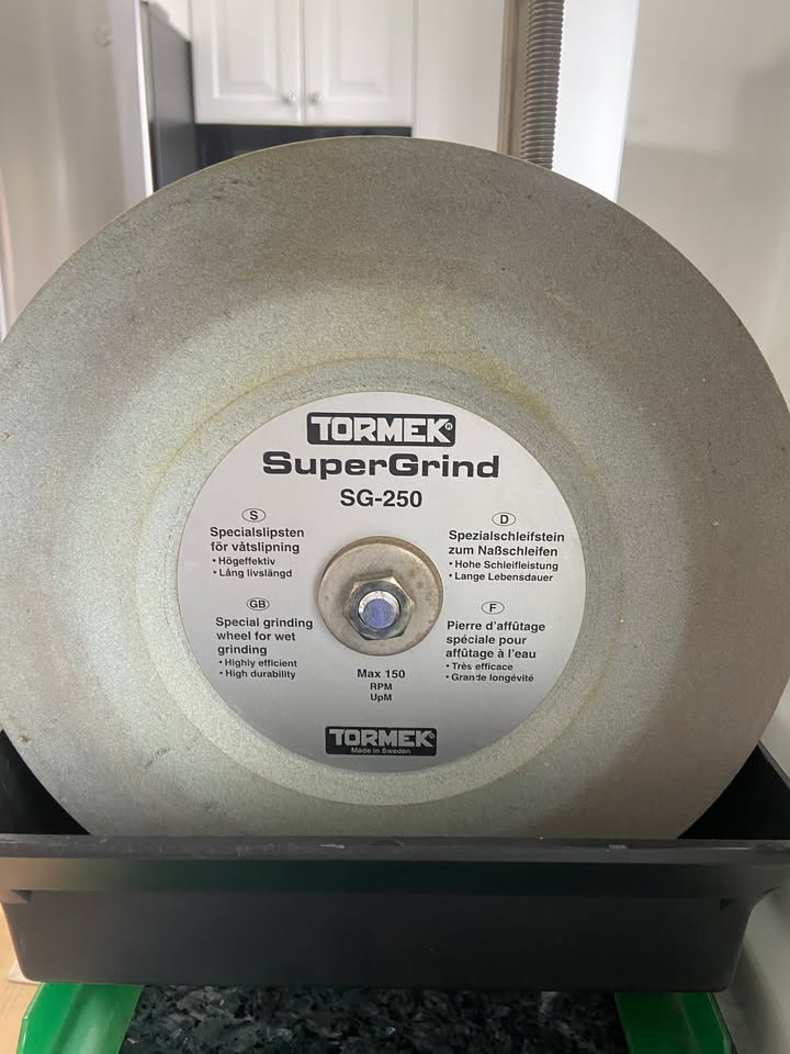

I've had the Tormek since 2000, and am on my third stone, having worn the first two out. It's a great system, but the accessories are pretty pricey. Good news is that the parts and accessories for the new ones still fit the old ones, so they're readily available.
I've sharpened hundreds - maybe thousands - of knives, chisels and plane irons on mine, and a few jointer blades, scissors, and axes. It's not the fastest grinder/honer, but the results are worthwhile.
