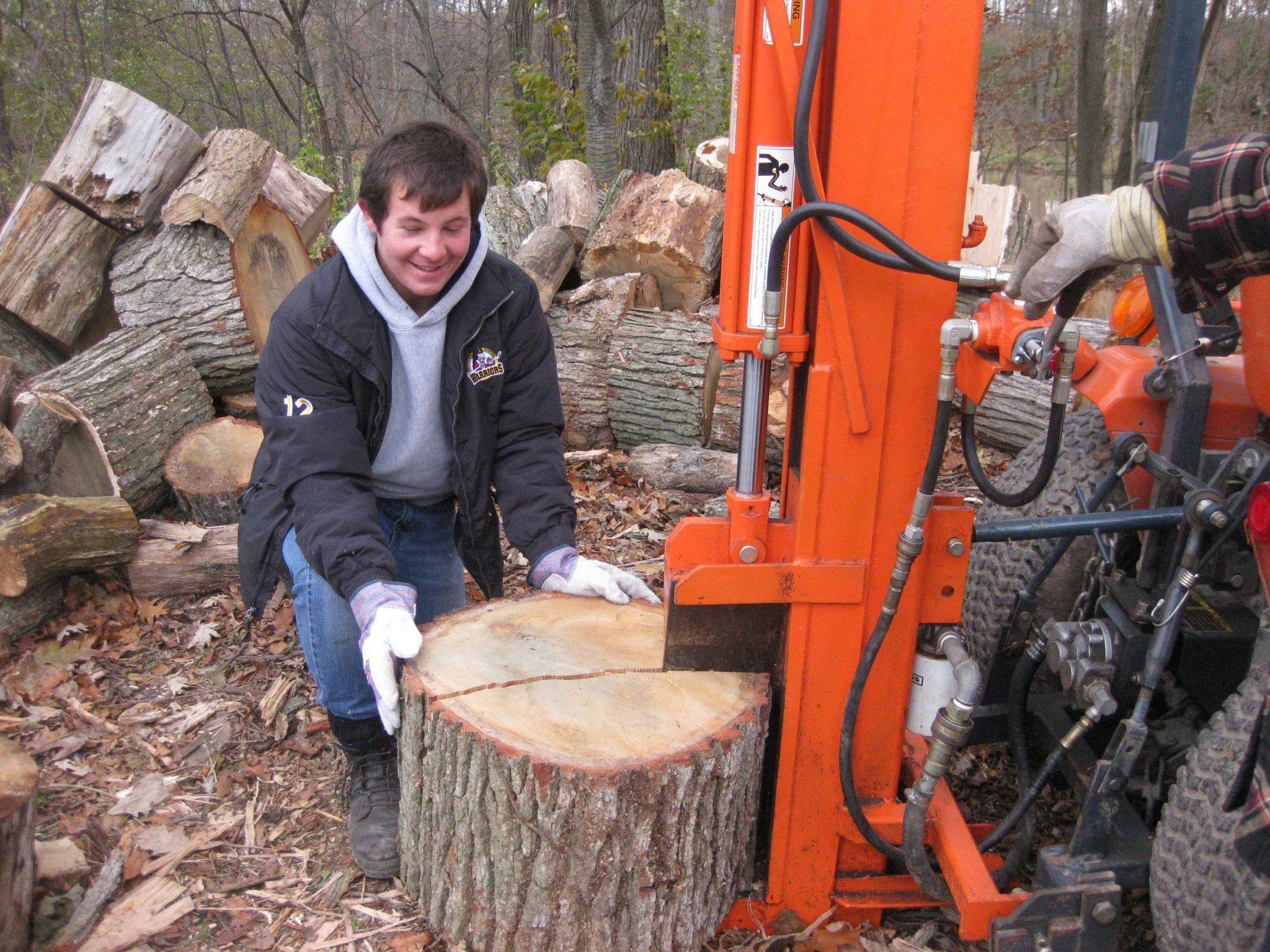

When I was searching for a two stage PTO driven hydraulic pump there was virtually nothing available in the 540 rpm and 11 gpm range which is all I could put on my 19 hp PTO. I ended up with a single stage 11 GPM pump which works great and gives me good speed. Any greater GPM would bog down the engine and not create the designed pressure of the pump.
The first picture is of my splitter on my old B7200 and second picture shows the new 11 gpm pump on my LX2610. The pump required a 4" extension to fit the PTO.
Mine is a vertical splitter as lots of my logs are quite large.
