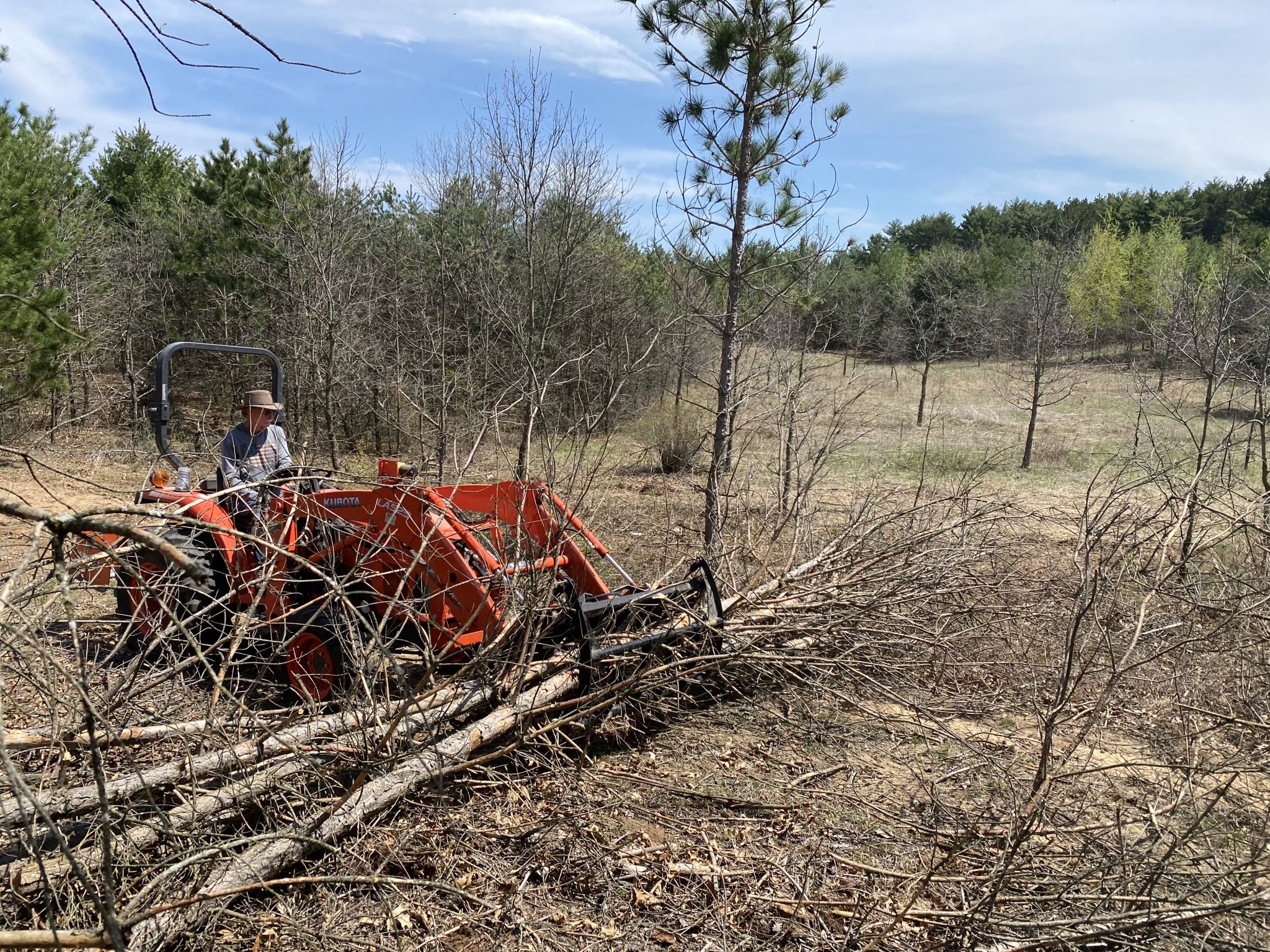

I think your spot on with being a bit of a learning curve and you will quickly get the hang of using your grapple! :).
That being said I pick up a LOT of smaller diameter dead scot pines that range from 2 to 5 inch. Of course I pick up much larger trees and limbs.
The technique that works really well for me is that I will come over the top of the tree or branches with the grapple in close to a full curl, drop it down so the fixed tines are just at ground level then close the top grapple lid. I will adjust my curl and loader height as I close the lid to do as little ground disturbance as possible. My grapple is a Landpride SGC06 which has short lower fixed tines.
You can see in the picture I still have a lot of curl in the grapple but have already started to raise the loader arms and curl back.
