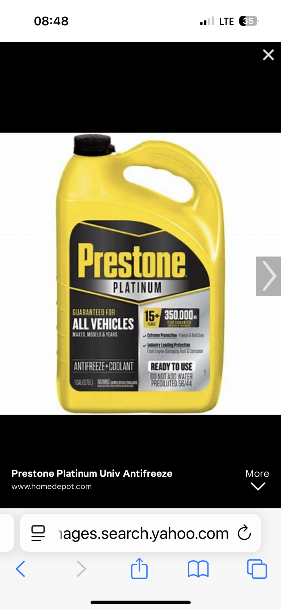

Color cannot be relied upon to determine what is “correct”…. as there is no actual industry standard followed.
The best resource is your owners manual. Unless recent changes have occurred…. ordinary Ethylene Glycol is what Kubota has recommended for many years. ( Prestone is the Ol’ Reliable…and hard to beat.)
