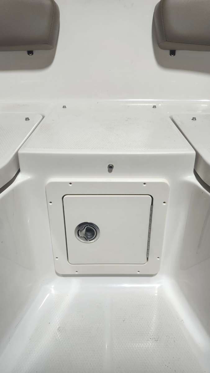

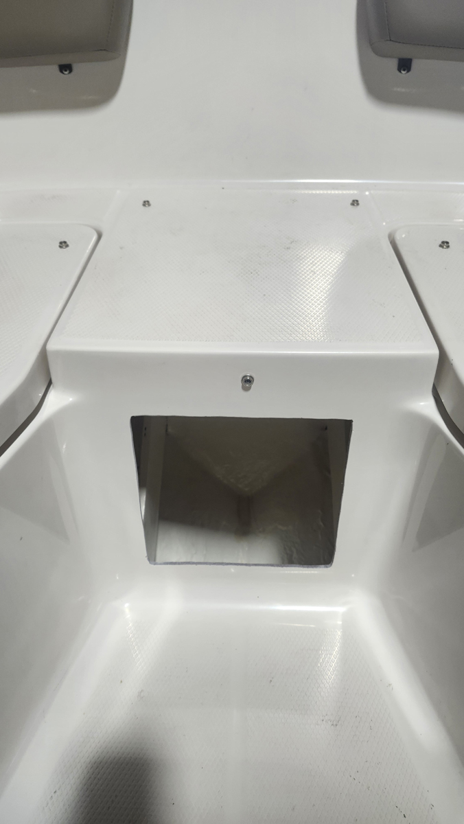

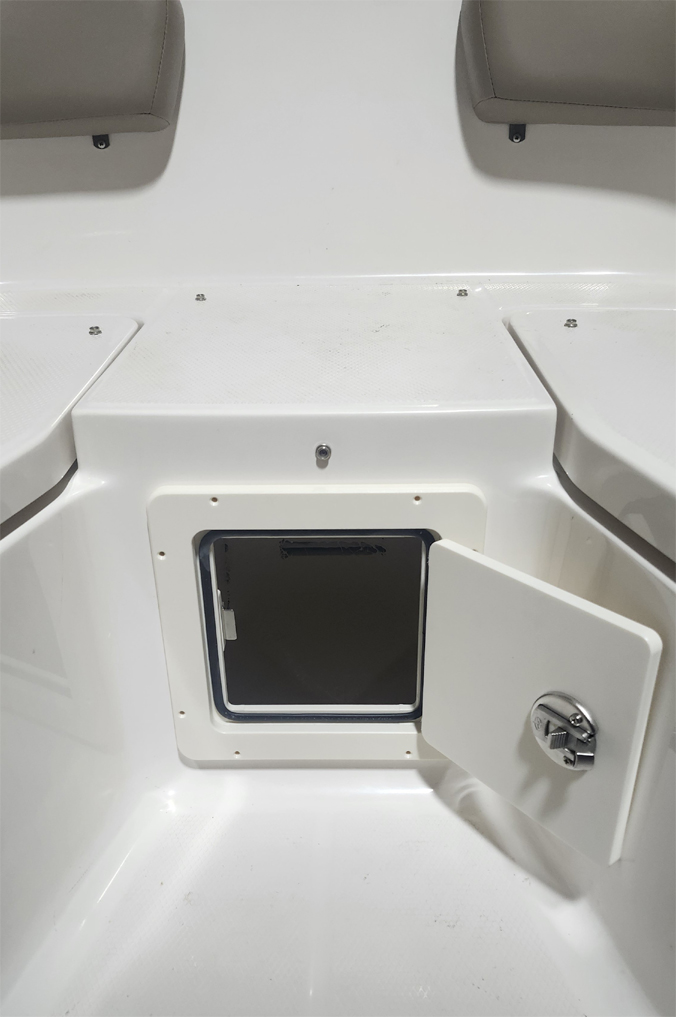

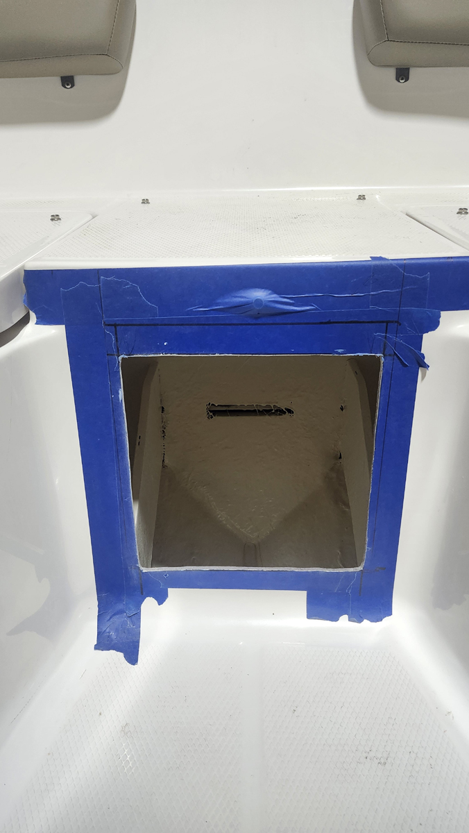

If you've ever owned a small boat you'll know that storage can be a problem. I wanted to get a little more storage as well as gain better access to the inside of the hull for inspection purposes. I recently bought a Klein Tools camera that connects to my phone and wasn't able to snake it into some areas so figured this access door would help.
It's felt like spring here so I took the chance yesterday to stop by the boat storage facility and check another upgrade off the list, well almost. I'll need to use some 5200 to seal the door to the fiberglass and buy some stainless steel machine screws to finish the installation of the access door, but the hard work is done.
I learned recently that boats over 20 feet in length don't need flotation foam in the hull so it makes sense why this Robalo is 20 ft and 7 inches long!
Here's the before photo showing the location of the new access door. It's in the bow area and directly below the small square shaped seat cushion.

Sweet upgrade:

From one Boataholic to another Looks great, good work!
As owning many boats (lost count after about 6) there is never enough storage until you get to over 40ft, then it might be iffy.

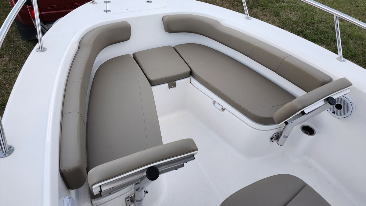

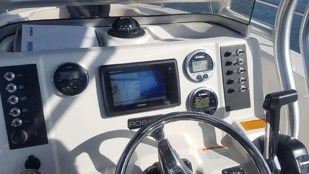

I was expecting the same. Was that not done with the instrument panel?
Yep. I created a custom center console arrangement last year and it was a brutal and stressful job for a fiberglass novice. The problem was the lack of a large enough flat surface on which to mount the new electronics so I had to build up the center section with sheets of CSM and biaxial fiberglass. In hindsight it would have been easier to buy a large piece of acrylic, but what you find with mass produced boats is that a lot of corners are cut and the attention to detail isn't very good. I was able to address other issues that really annoyed me, for instance, the cut out for the binnacle was a disgrace, but I rebuilt the area and upgraded the binnacle and now it's how it should have been from the factory.
I have some other upgrades to complete, but I can take care of them incrementally, and not lose two months of boating time as I did last summer.
From this ....
... to this. :)

Nice hatch install!
