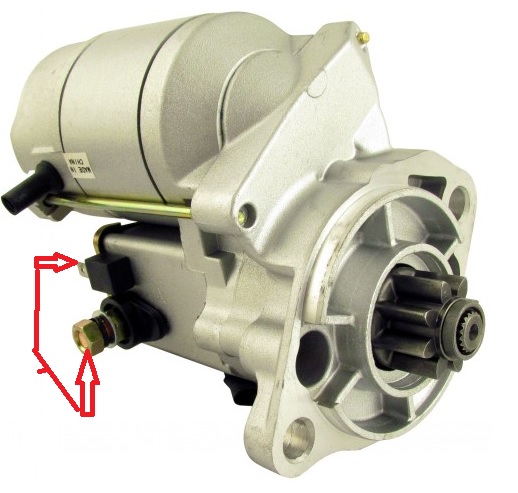

Alternatively, you can jump the starter. Remember, doing so bypasses all safety features so be extra careful and even consider having someone in the seat with a foot on the brakes.
Remove the wire from the small terminal on the starter. Use a piece of wire or even a screw driver to jump between the small terminal and the battery positive terminal on the starter. Expect a small amount of sparking.
If the starter engages immediately then you have ruled it out as the problem.
