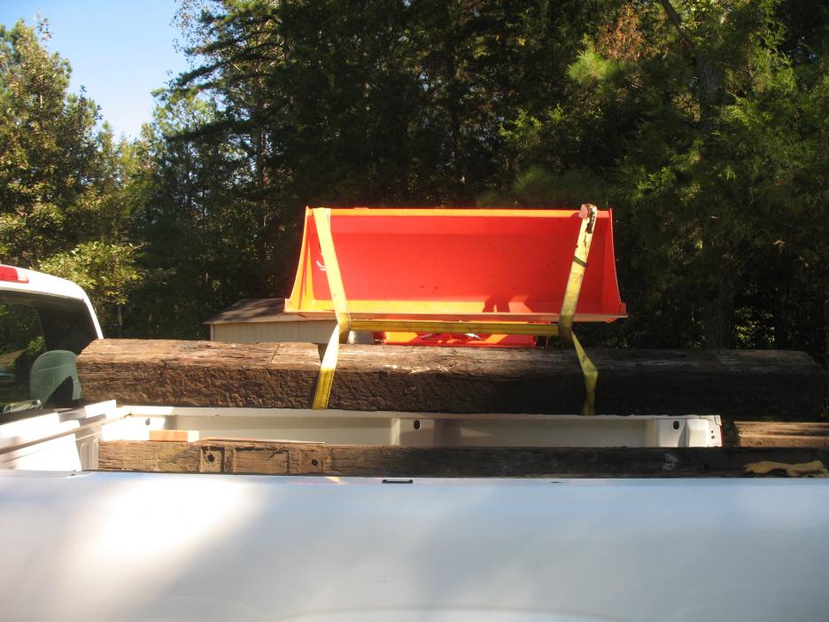

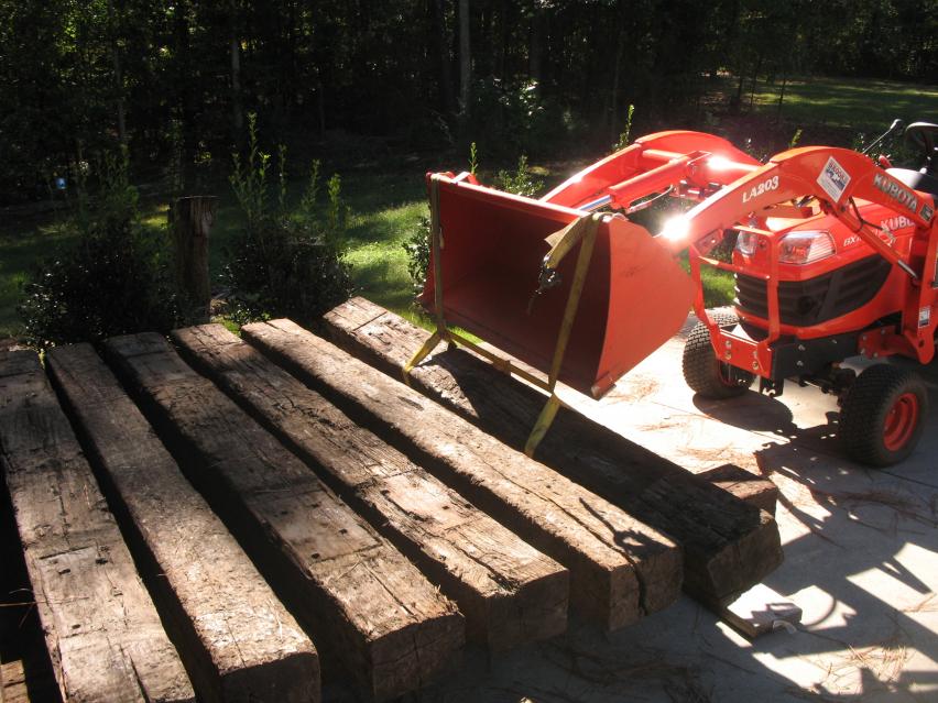

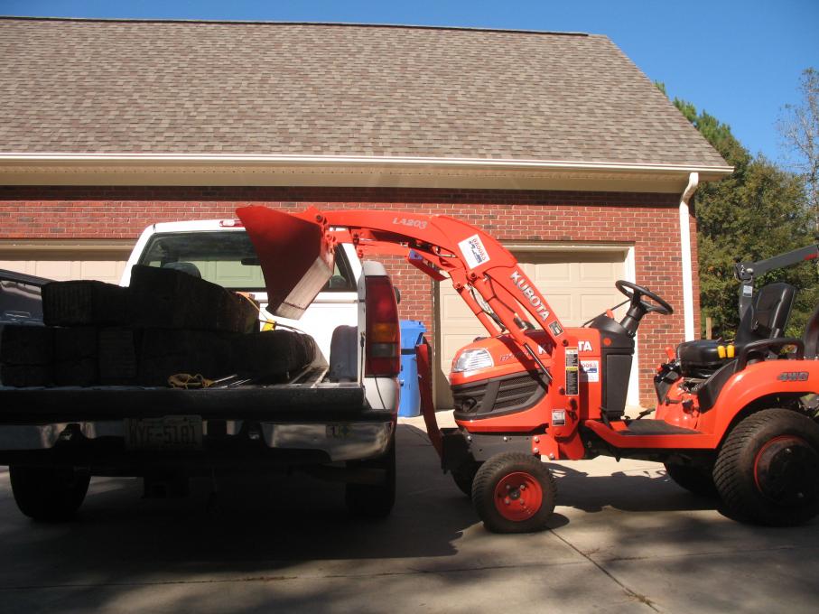

Here is how I did it, demonstrated with photos. We all like photos.

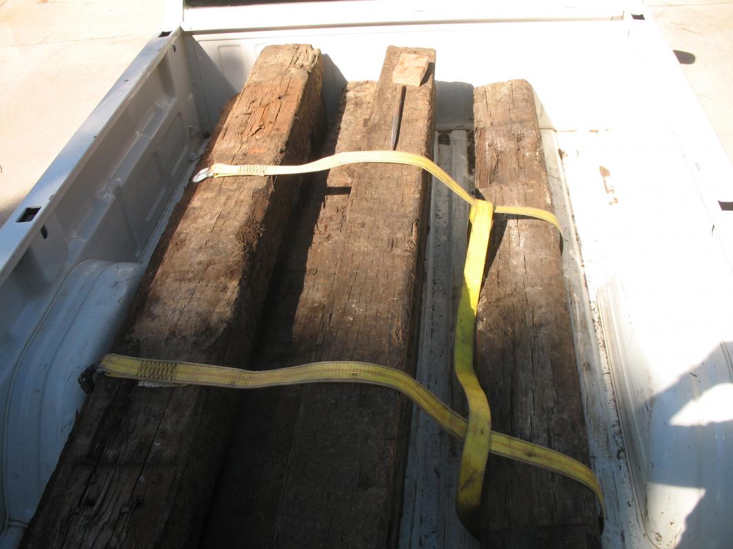

The first thing is to loop a heavy duty tow strap around the tie. Bring the tractor in to where the strap can be attached to the FEL, using the weight of the tie to "bind" the strap.
The tie is then very easily lifted up and out of the pickup bed and then deposited on the growing stack of ties. It was as effortless as can be; the only thing that was tiring was me climbing in and out of the pickup bed. In the end, I unloaded a total of 28 ties this way (multiple trips in the pickup to ACE hardware for the ties).

It is just one strap about 15' long and rated (if I remember correctly) for about 5,000 lbs. It is made of thick woven nylon; I've used it on occasion as a tow strap - which is exactly what it is. I lived in Latin America for many years and frequently needed a tow strap and have had this one for at least 20 years.
In using it, I simply lay a loop over the RR tie, bring the two loose ends into the loop and then bring the loose ends through the 5/16 hooks welded to each upper end of the FEL bucket. (I think the first picture shows the layout of the strap before attaching it to the bucket.)
I then pass the loose ends under the strap - when you begin to lift the bucket, the straps tighten onto the loose ends and hold them very securely. The more weight that presses agains the loose ends, the tighter the connection.
Rotating the bucket upwards also brings the entire weight of the RR tie to bear on the straps. In depositing the RR ties, I simply lower the bucket and then rotate it downward - this takes all the pressure off the straps and I can then pull the loose ends out of the 5/16 hooks. No need to make knots at all... just let the weight of the load secure the load.
