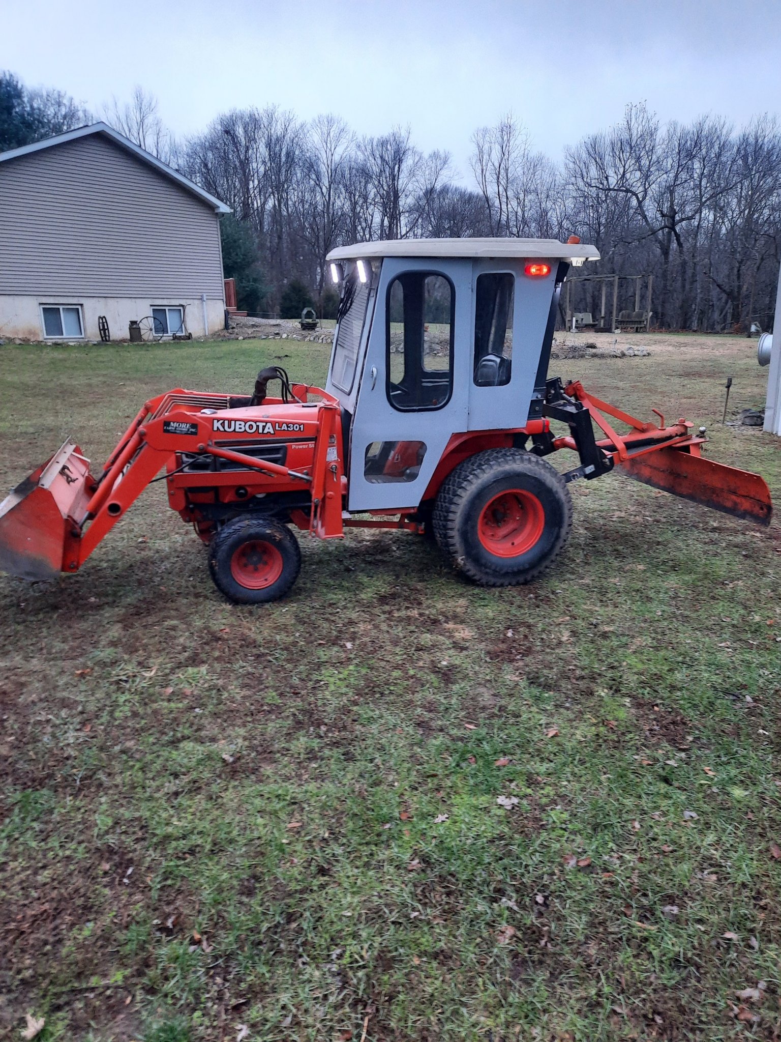

i decided I was tired of being cold and wet while moving snow. I purchased a garden tractor cab stripped it and enlarged it to fit my b2100 not quite done but it will keep me dry and warmer this winter

Nice.
A cab makes the whole experience so much easier.

That looks great. What was it originally made for?
Was told it was for a wheel horse
View attachment 51927 i decided I was tired of being cold and wet while moving snow. I purchased a garden tractor cab stripped it and enlarged it to fit my b2100 not quite done but it will keep me dry and warmer this winter
The enlargement was 8" wider and longer. I gave $80 for it. I figured I couldn't go wrong I didn't have to reinvent a cab just make it larger. The windows it came in it are safety glass. A manual wiper and a pioneer stereo and speakers. I used a golf cart roof that I had already. I have less than$200 in it so far
