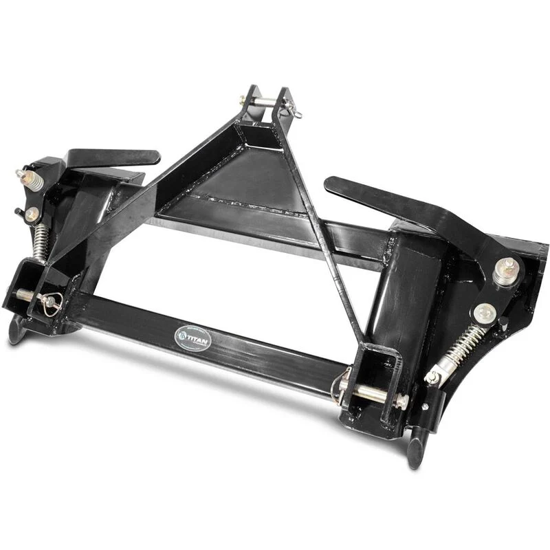

That is good to know as I thinking about building a 3point SSQA adapter. Thanks
12,786
5,574
yikes..$1700 but a ''welder /fab guy ' could make nice one, I bodged one from 6 years ago. Buying the premade 'clamps' would be money well spent.

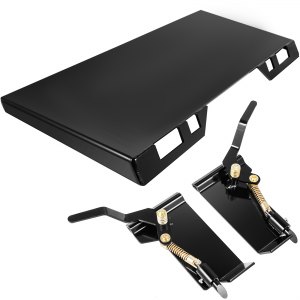

Those plates are junk, I bought that set way back for my first loader build on my b7100 and they are even too light weight for it.
The one for $1700 is also bulky.
