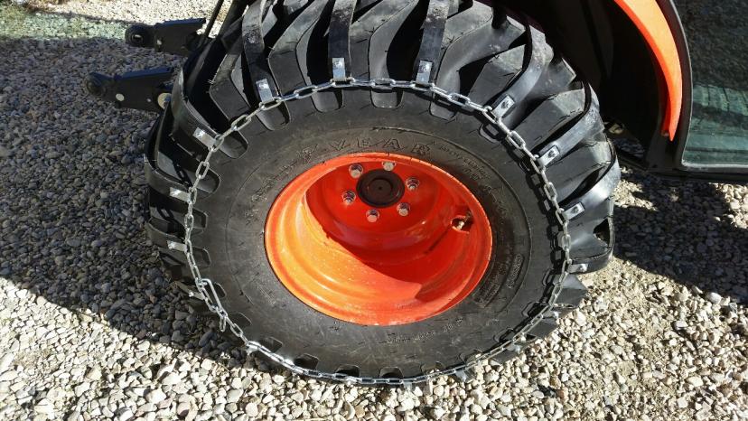

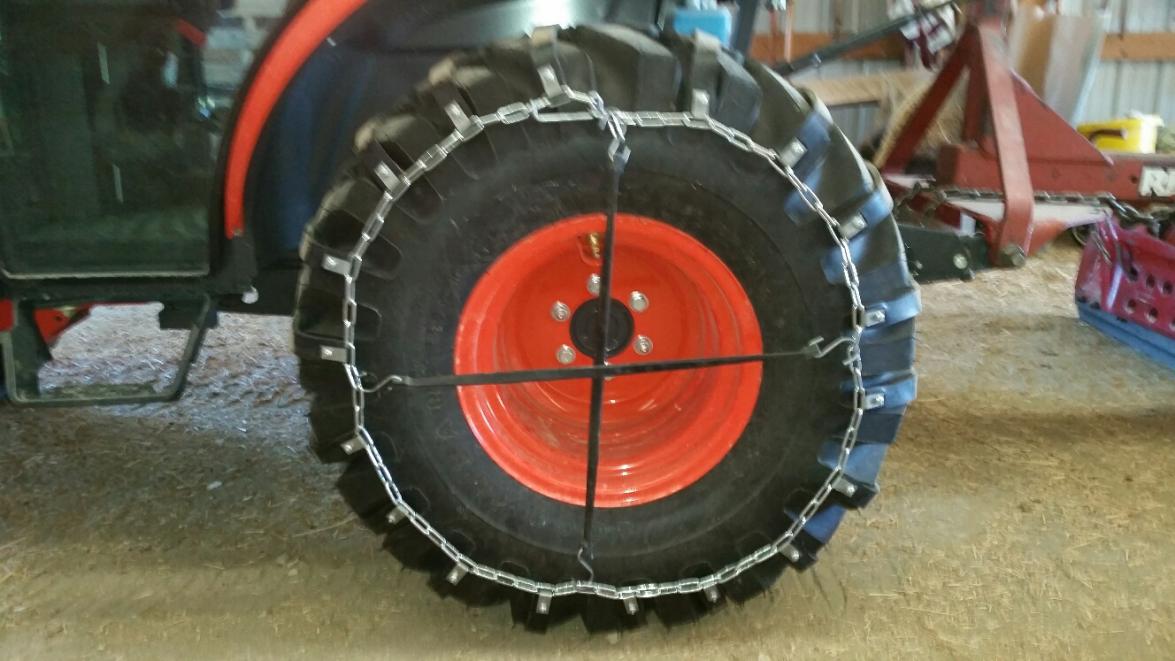

My B2650 manual says the pressure should be 20# rear and front 35#, these are R4s. On the tires it gives these values as max pressure. Before I put on my rubber chains I checked and the rear was 17.5 and the front was 29. I have never run the max on any tire before so wanted to check and see what other folks are running compared to max.
Installed the rubber chains, now need to test them in the snow. Today was like summer, had to take off my sweatshirt and was working in just a tee shirt and it is almost Christmas.

Unless I have a lotttttt of FEL work, I run my front end about 5 psi below max - only shocks you have are the tires, so I like a little softer ride.
I would lower my rears, place chains on them - then bump the psi back up to "normal" - this way the chains pull tight around the tires.
I used those rubber bungie straps for a while, until the winter cold caused them to snap.
I got a cheap set of ratchet straps from walmart, cut off almost all of the excess and used those, as the chains stretch, I give it another click!

So I am actually in the norm as far as pressure, good to know. I did deflate the tires to put the chains on and just pumped them up to where they were originally instead of max.
Good idea about the ratchet straps, the rubber ones do tend to deteriorate over time. I also have some spring type tighteners that I use on my ATV chains, may try them on these just to see how they do.
