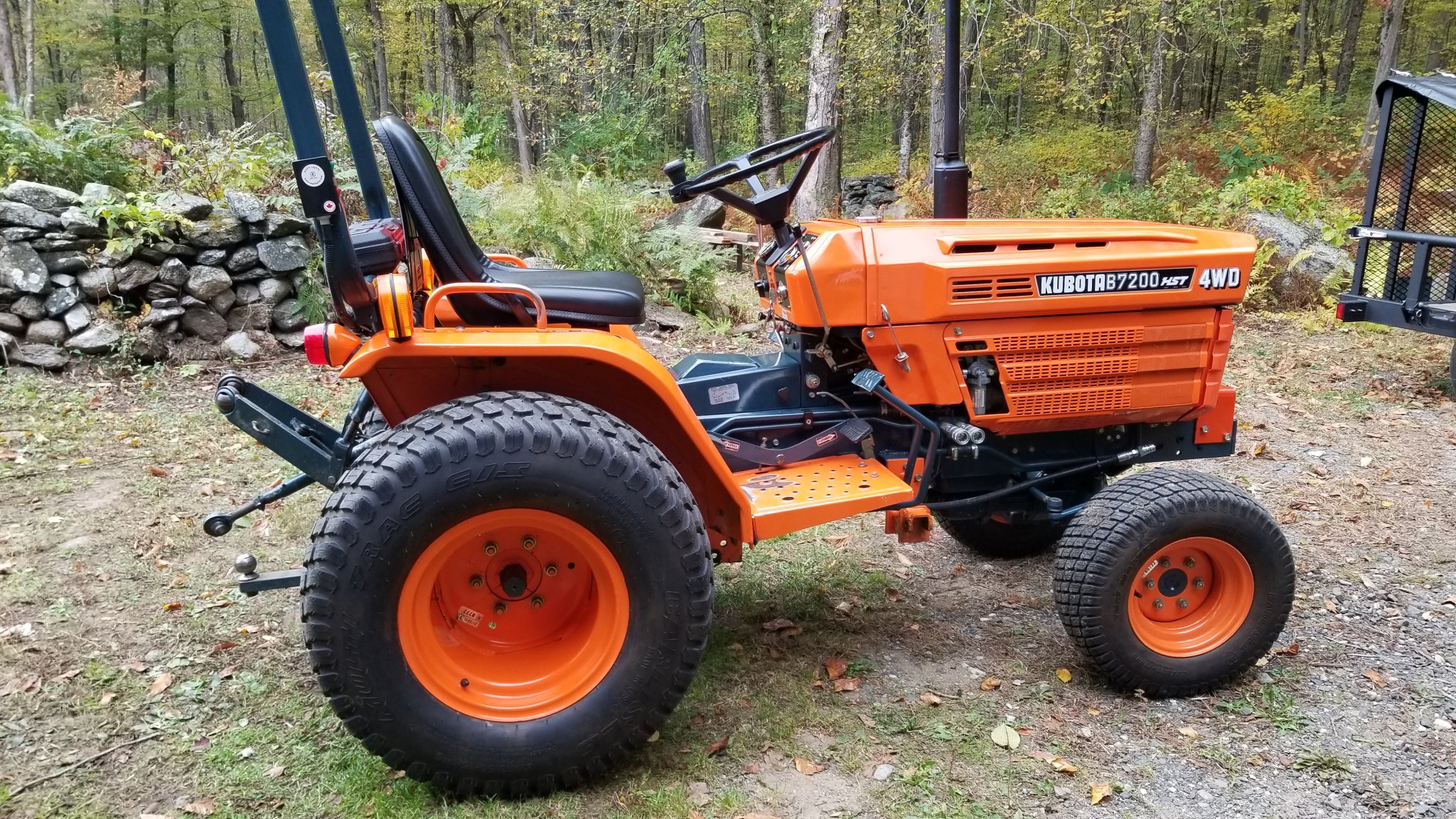

Hello everyone looking to swap over to so Ag rims ad tires for this sweet B7200 I just picked up. 1300 hrs in excellent condition . It came with a mower deck and 2030 plow.
I would like to pick up some Ag rims and tires s I can put chains on it and plow this winter. Looks like they still offer front 6-12 #70000-00441. The back rims though I am not sure about. Looks like I could go with a 8-16 or a 9.5-16.
Anyone know what my options could be? Thank you!

There is no 8-16 used on that model.
The 9.5 16 is the only option.

Okay thanks. Now the hunt.
I'd try chains on those first ...
Thanks for the input. Yeah I considered it. I was told that Chains on turfs is not ideal due to shifting, My property is a bit rough and I think the ags will be bette5r for my situation. I do want to keep the turfs so I have both options.
