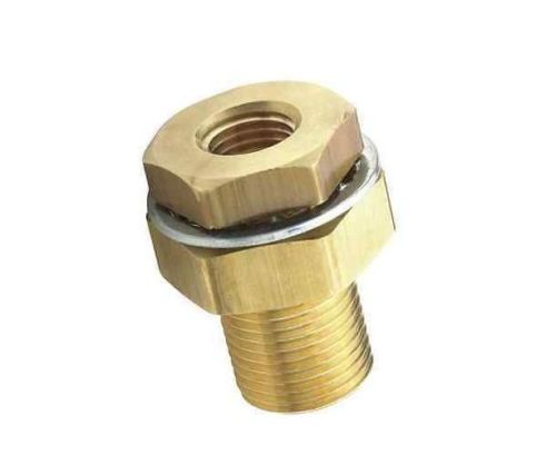

this is the best $10 you can spend.....but there is a one problem, the threads are 1/8" NPT, finding a gauge is tough as hell with 1/8" sensor now for some reason,

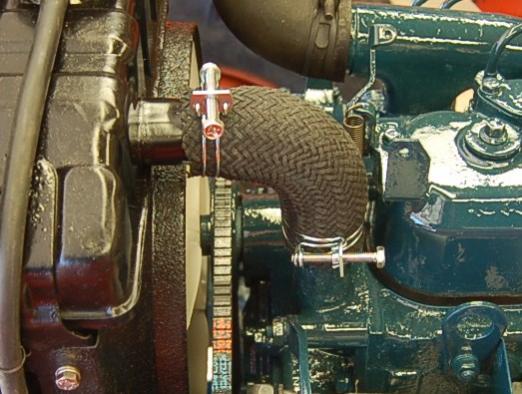

I bought this :
https://www.amazon.com/gp/product/B00KYE842S/ref=oh_aui_search_detailpage?ie=UTF8&psc=1
and drilled a very careful hole, forgot the exact size and then used the 3/8" npt brass adaptor and "threaded" the aluminum hosing. Worked like a charm.
The adaptor allows the "sensor bulb" to be pulled back a hair too - so the bulb does not hit the back side of the T adaptor.
this the gauge set that I bought too:
https://www.amazon.com/gp/product/B00UM9X1EQ/ref=oh_aui_search_detailpage?ie=UTF8&psc=1
The hose "Way" is an easy out, there is NOT a lot of allowance for error as to where to cut - but it is not hard.
these pictures are from round one:

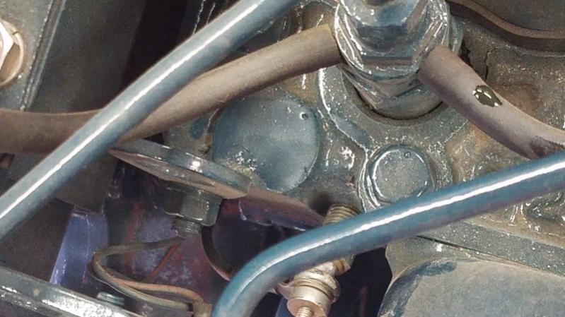

i have drill and tap the head of my 1501 without problems,
is a very strait forward job and easy.
the place that i had tap is the original place that kubota places the temp gauge.
why not to try it..
you can check it here and here

Well the "Proof Of Concept" seems to work Okay :);
Used an older hose I had lying around, did not want to experiment with the Kubota one.
Need to move it up a bit, washer hits the non-thermostat housing and goes cock-eyed a bit.
With what I had in the shop could only get a washer on the inside.
The one on E-Bay is 1.5" in length, mine was .75"
Worked well box bladeing the drive, tomorrow we will do some mowing.
Temp only got to 190°
