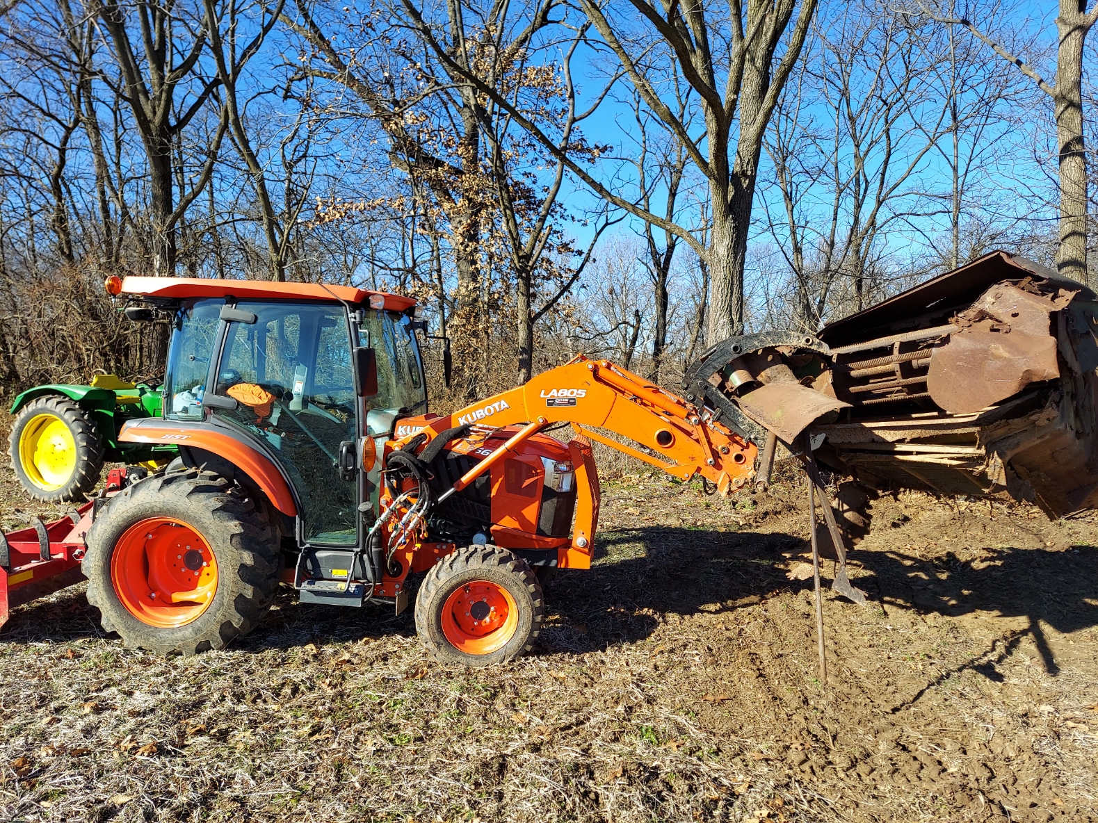

We have 80 acres. I have been using my L3560HSTC to clear some of the land and expand the fields that we share crop. I have a grapple and mower. The tractor has done well with both. The HST+ transmission is very nice and gives you more flexibility. If you are going to be doing a lot of PTO work, then the more horsepower the more options you have PTO equipment.
