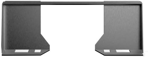

If you have a welder you can buy QA plates and weld them on your bucket. Just cut off the pin-on flanges.
that's exactly what I did with an AE Root Grapple I really really liked.
It was pin on and when I sold the tractor I originally bought it for I just couldn't give up the grapple when I sold the tractor.
Cut off the mounts and welded on a plate like this.
