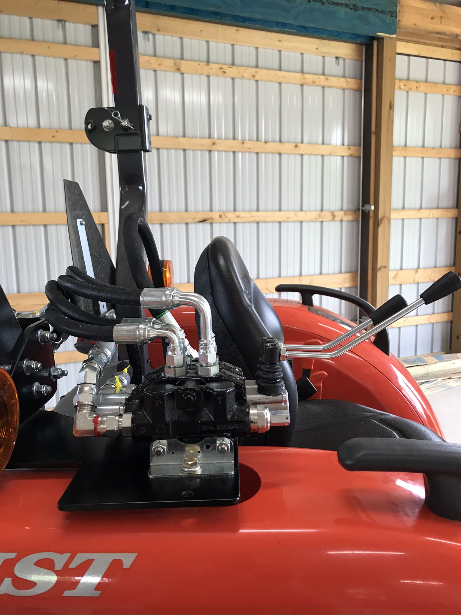

I got a kit from FitRite Hydraulics that was the valve and the top and tilt cylinders. He makes the cylinders custom to your tractor model and fabricates a mounting bracket for the valve. On mine he left the hoses for me to purchase locally.
I highly recommend him if you have the time to wait, but the valve can be done yourself with a little knowledge gained by asking questions and reading about the equipment. He will sell just the cylinders or just the valve as far as I know, I just got everything at once for simplicity.
