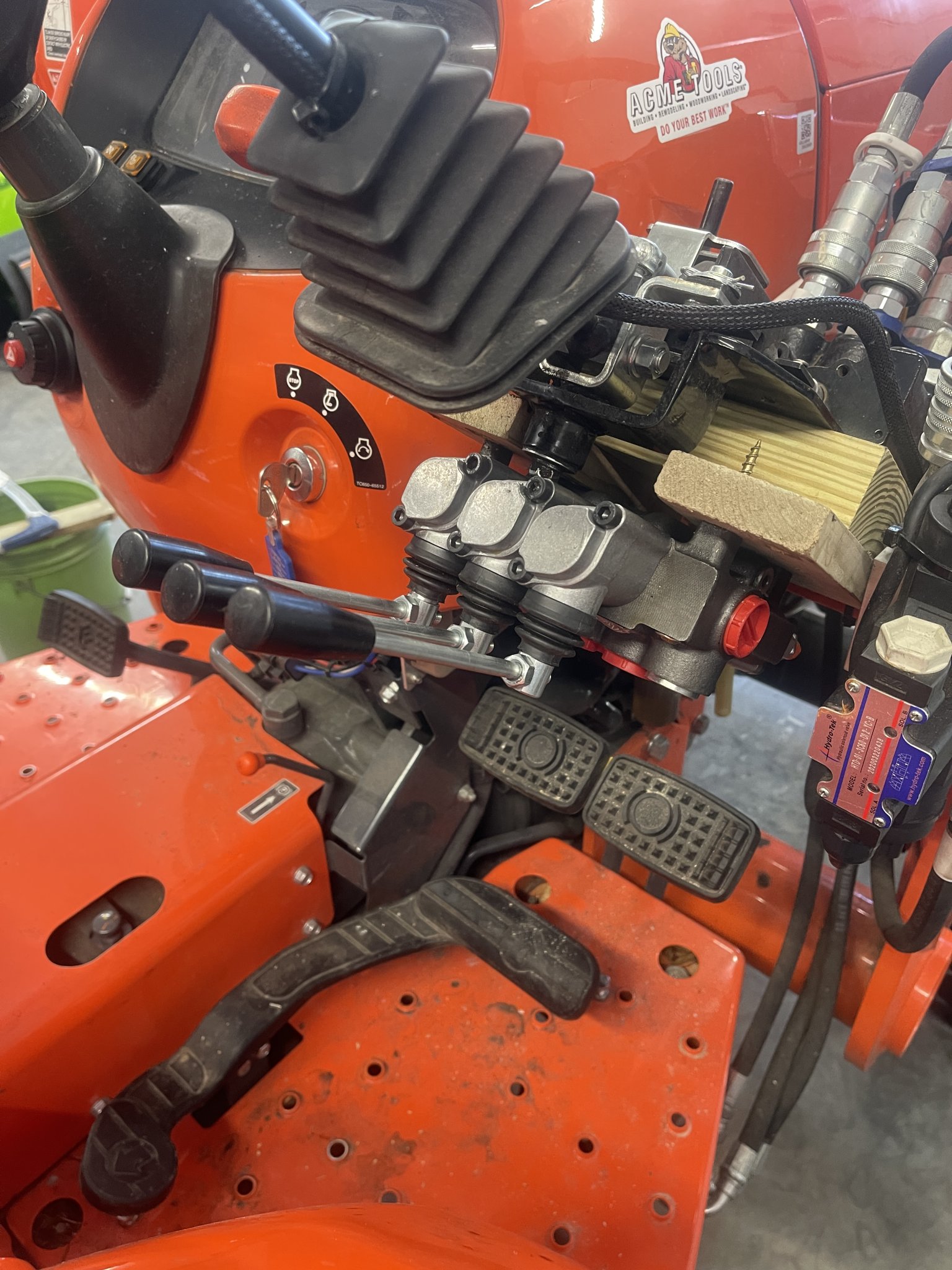

when running six 3/8 hose voids fill up fast.
Im trying to find 7/8-14 (SAE 10) and 3/4-16 (SAE 8) Banjo fittings to keep everything nice and tight when connecting to the valve.
I really only have need for one set right now but adding the 3 spool valve for future toys.

SAE banjo fittings are a true Unicorn.
