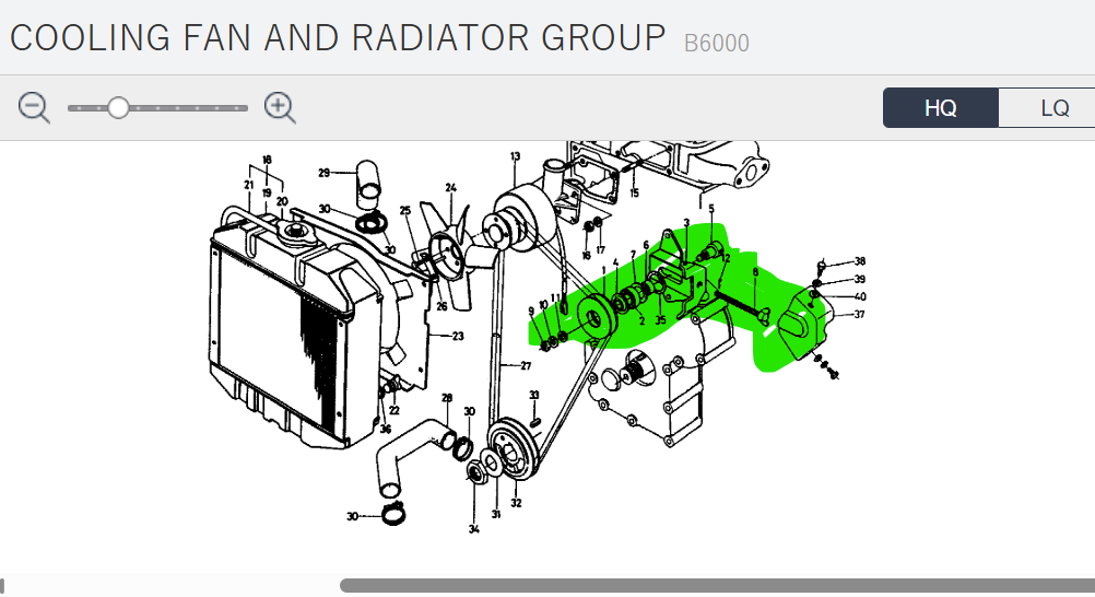

The factory designed pump on these were run off a shaft and adapter off the front of the crank, not an extra pulley.
Are you wanting to mount a belt driven pump off of it.
There are several old threads on here of people doing that for PS, but I don't think I read one for hydraulic operation.
If that's what your trying to do, you simply remove the belt tensioner pulley and bracket and replace it with a pump, no need to add a pulley to the crank.

Well that solution seems pretty obvious now that it’s staring me in the face.

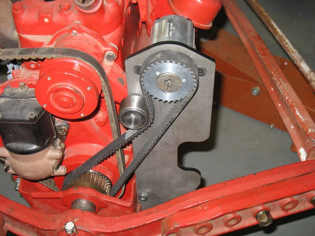

9,411
4,917
The shaft would not clear the radiator, that would’ve been my first idea but there isn’t enough clearance up front and I don’t really want to modify anything to make it fit. I’ll probably just end up going with the belt driven pump, but the side load isn’t something I thought about.
Hydraulic pumps of that suze are not fractional horsepower.. If you opt for a belt drive I strongly suggest you use a synchronous belt and pulleys. Far better torque transmission and less side loading. I have done more than a few....
