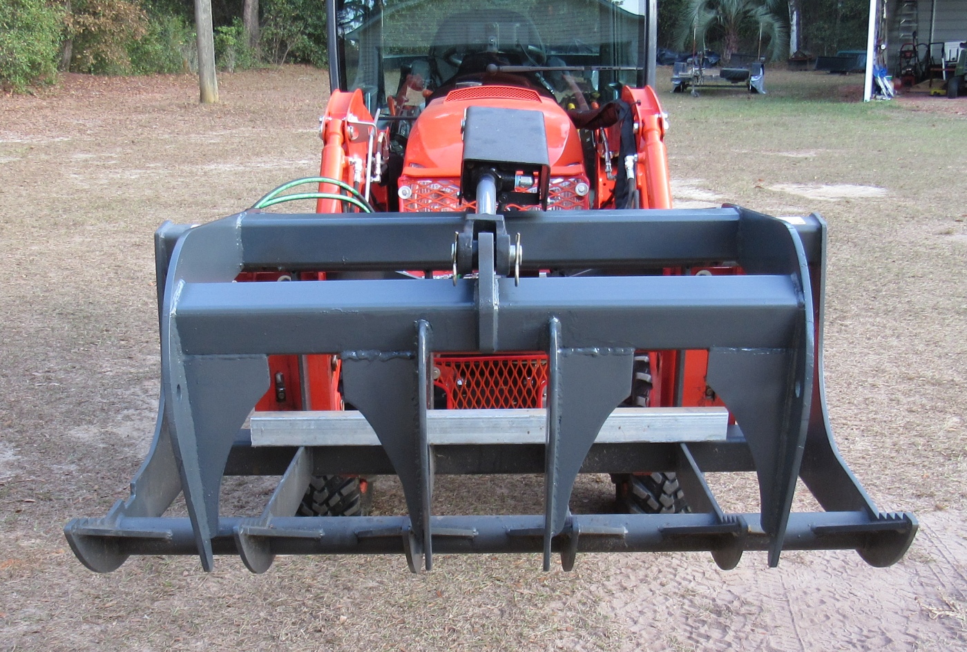

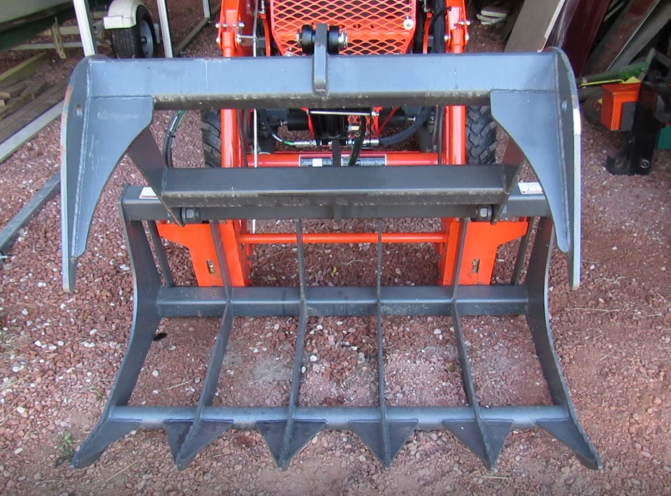

I bought this Iron Craft economy grapple a couple of weeks back. I didn't have a current need but I had a pile of small limbs I cut off an azalea bush. I tried to pick the pile up with it and they kept falling out the front. I decided at minimum it needed two more teeth.

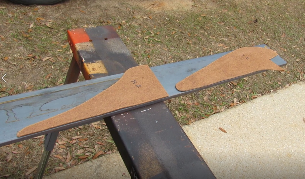

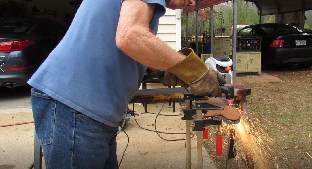

I made templates of the outer plates and gussets out of cardboard and transferred those to some fiber board to use as guides for my plasma cutter. I bought some 3/8" X 4" flat bar and cut the shapes out of that. I zip tied a couple boards to the front to act as a guide to position the pieces while I tacked them on. My welding isn't pretty but it is usually strong enough.
I might enclose it all with some expanded metal if I think I need to when I find a use for it. I didn't really need another grapple but my John Deere and grapple is on loan to my daughter and I might decide to downsize and make the Bota my only tractor.

looks good.
plasma makes things so much easier.
not sure if Id use expanded metal.... seems like it would just be a place for sticks and crap to get stuck to.
I mostly use my grapple for moving logs.
It's actually only a grapple "thumb"
works good though.

Yeah my plasma cutter is a $250 eBay special. I'm not very good with it but I have a nice DeWalt grinder. :)

Mine is just an “El Cheapo” from the Big A, and if/when it craps out, I will spring for a “name brand” model.
I highly recommend Hypertherm.
I've had my PM45 for 10-15 years..... (CRS disease)
slap on the fine cutting consumables and the possibilities are endless.
