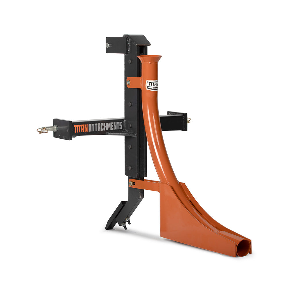

Can anyone suggest a simple Trencher that Fits 3 Point? The cable only needs to be just under the grass as it's a CAT5E about a 250 feet run.
There are a lot of rippers on amazon to pick, i can't weld so i half to buy something and it's not something that would get used hardly ever.
Welding is not a requirement. I helped a friend bury some wire for yard lighting at a hunt clubhouse. We used 1" sch 40 PVC pipe, heated it with a heat gun (rotating and moving the pipe as being heated) put a bend in the pipe, WIRED it to the subsoiler. Buried 200-250' of wire in short order.

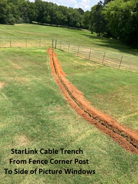

Agreed.
That is what I ended up doing recently. Rental was $230.00 a day.
Soil is hard red clay and Iron Ore. Still only took me 30 minutes to make a 100' run.
Rental company refunded me $50.00 upon return because it only took me a few hours total to go to town, trench and return.
Trencher was highly manuverable and allowed me to dig right up to
both the start and end points.
Trenched dirt was easy to backfill.

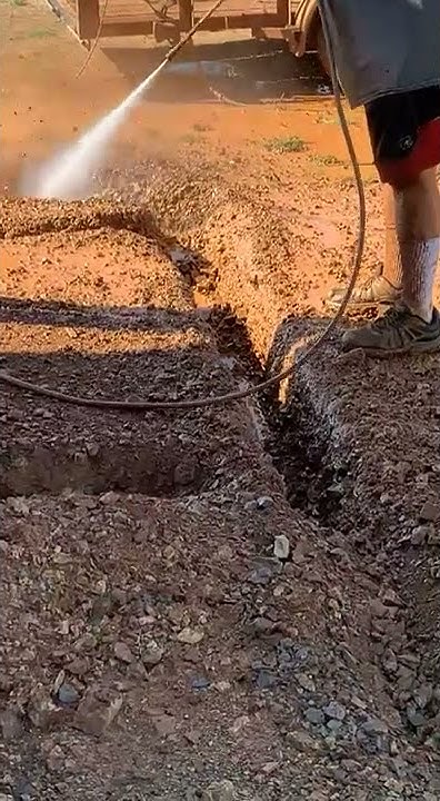

I hate you guys who can trench that fast! There are so many rocks and boulders in the soil where I am they won't even rent you a trencher!
33,600
8,841
My place is 99.9% sand so you can dig and trench as fast and as deep as you want.
But not all the property up here is like that, some places are so rocky that you can't do anything without blasting first.
