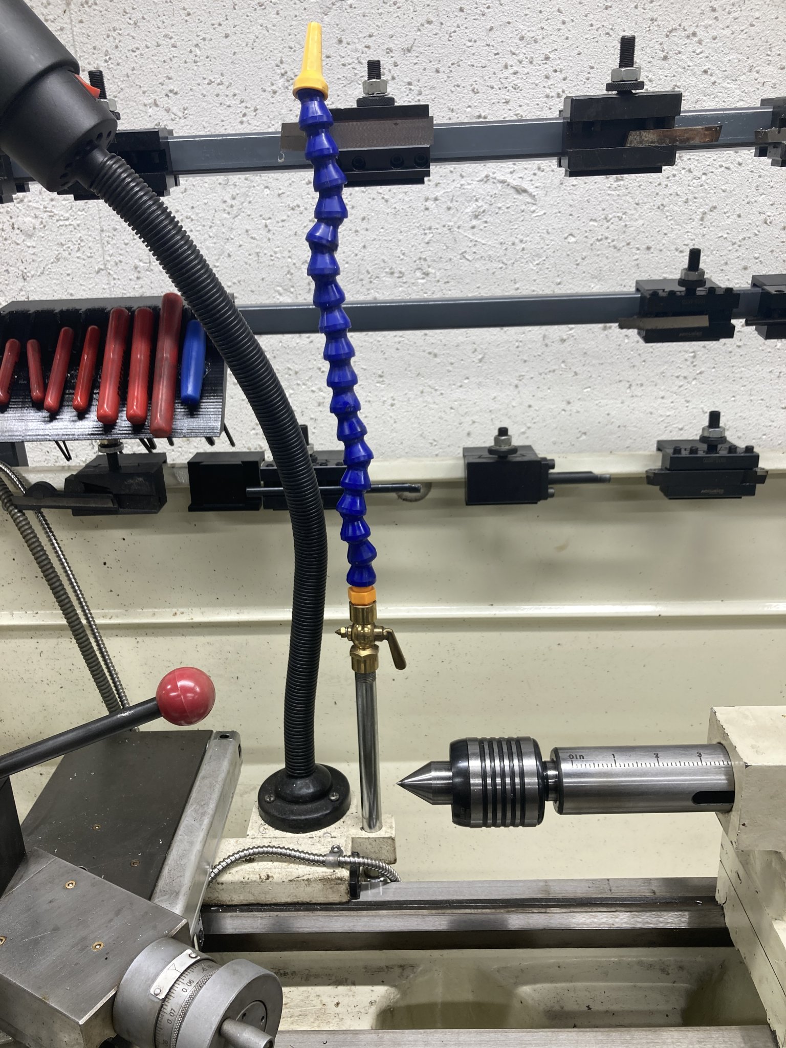

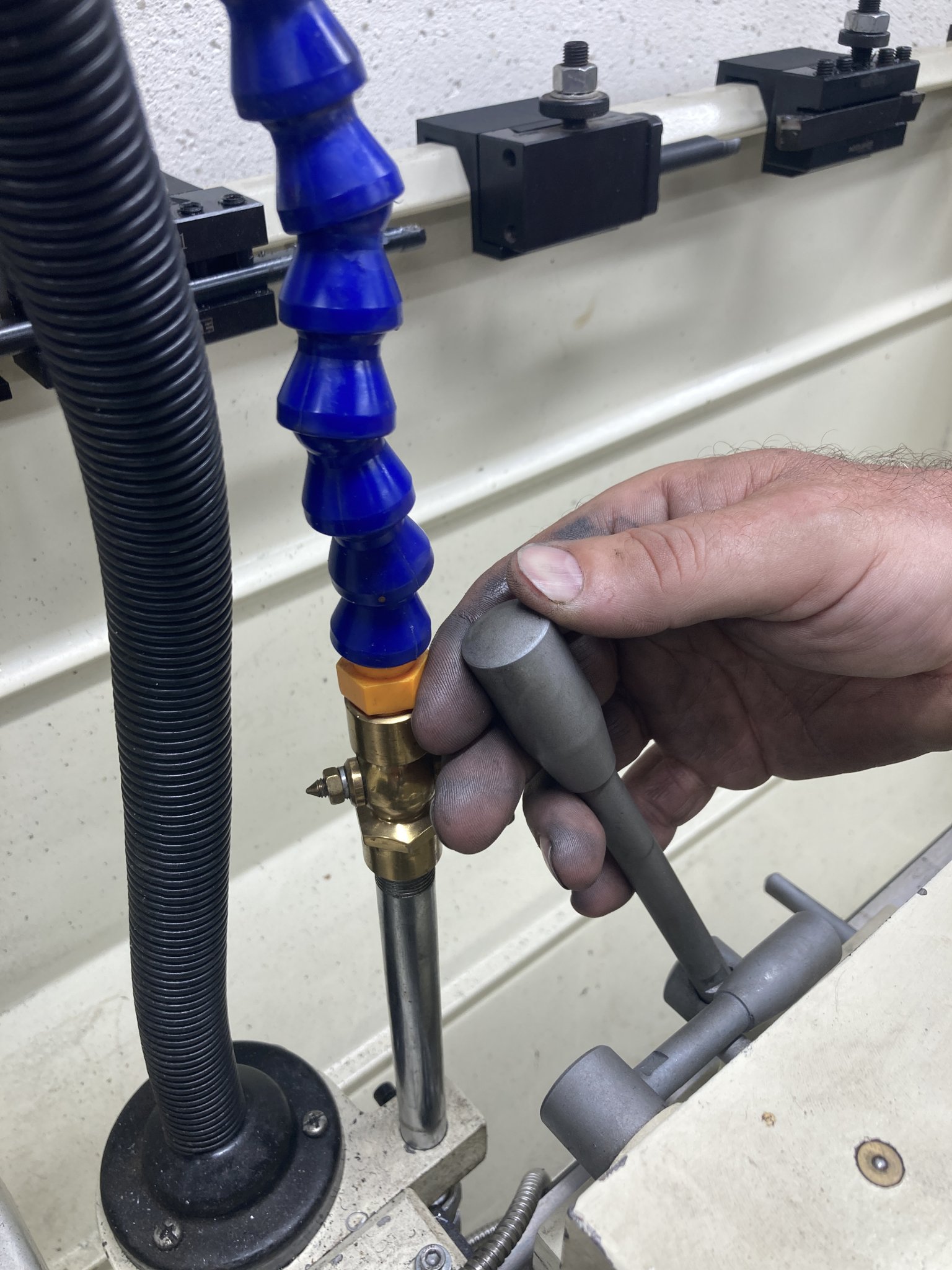

So there I am just minding my own business working on some little BS project when "BAM."
I smash my finger between this stupid "coolant dispenser" and the tailstock.....again!!! (I have actually done it about 400,000 times now and its pissing me off)
Now I have no idea if this thing (coolant dispenser) even works, I have never used it yet, so I probably should have just removed it and been done with it.
HOWEVER..........being OCD/ADHD/ADD (and my wife says "on the spectrum") I can't help but making a "mountain out of a mole hill"
So here is a pic of what I am talking about.......You can clearly see the "interference problem"....
Here is a general overview "problem area".

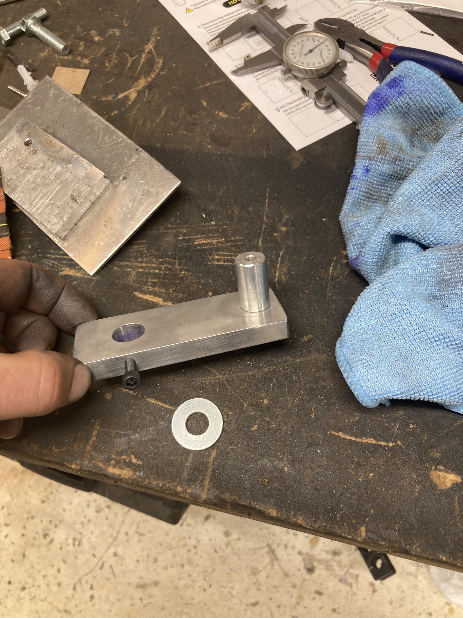

I decided it needs to be "moved back" a wee bit, so I decide to make a plate that extends it back a bit. This satisfies my stupid/unreasonable need to "keep it original" (kinda/sorta)
This also has the benefit of giving me another reason to use my lathe/mill/shop;)

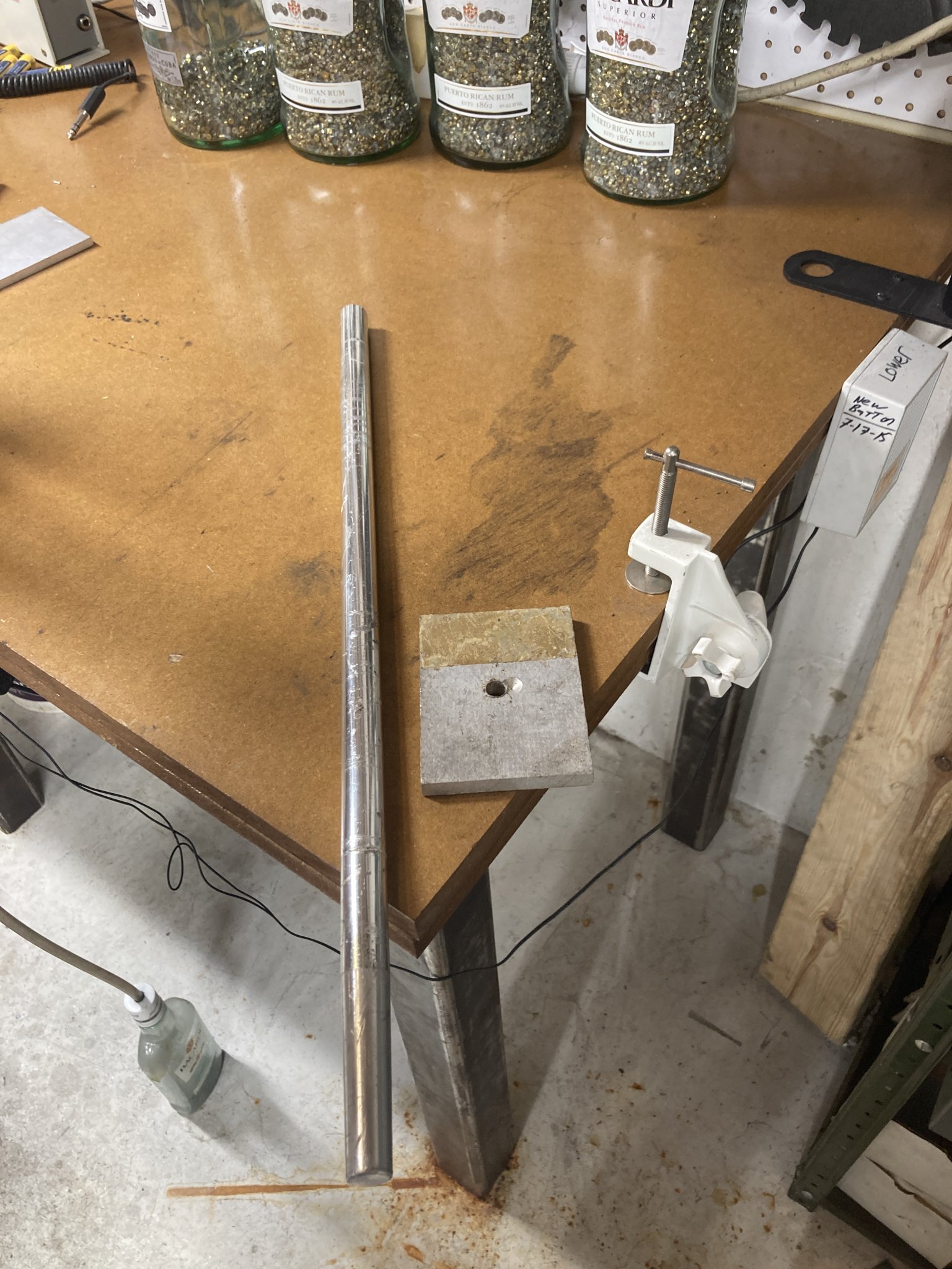

I decide that by using the original hole, I could just turn a piece that fits it, and mount a plate to that.
While digging through the "scrap pile" I find a couple of "donors" willing to "take one for the team"

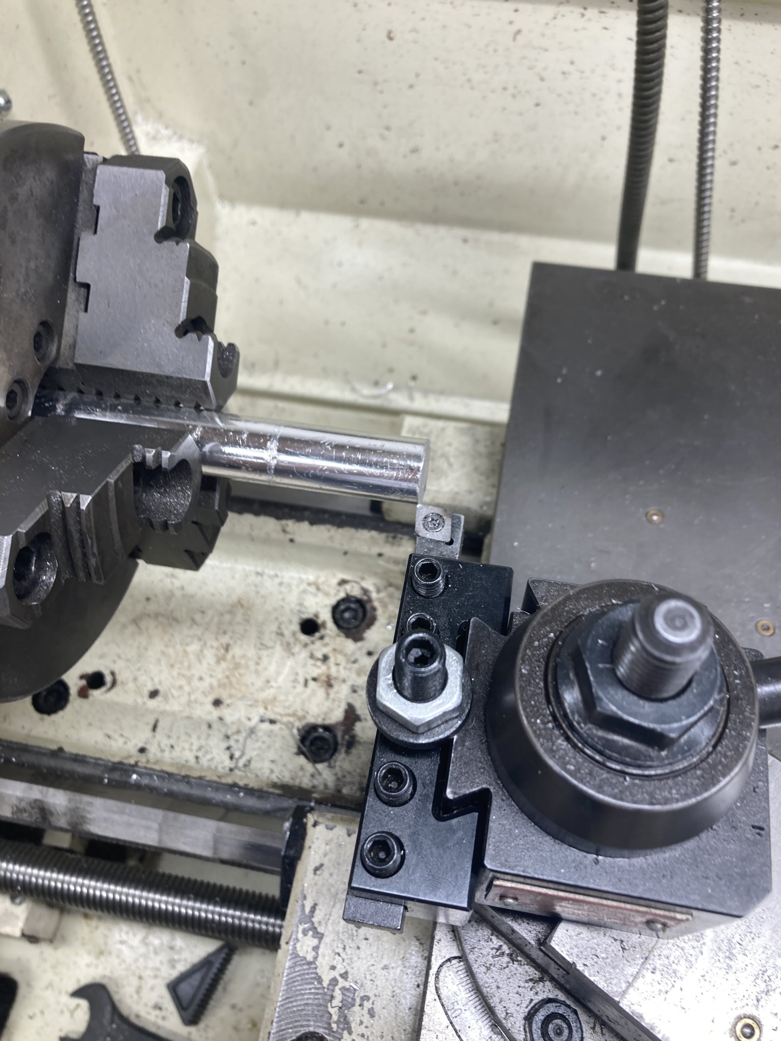

So it's off to the lathe.....(to fix the lathe? :p)
{ Full disclosure: I forgot to take some pics along the way, so some pics are "staged"}
I turn this bar to the proper diameter and tap it for some 1/4-20 screws I have had just sitting there for about 20 years.

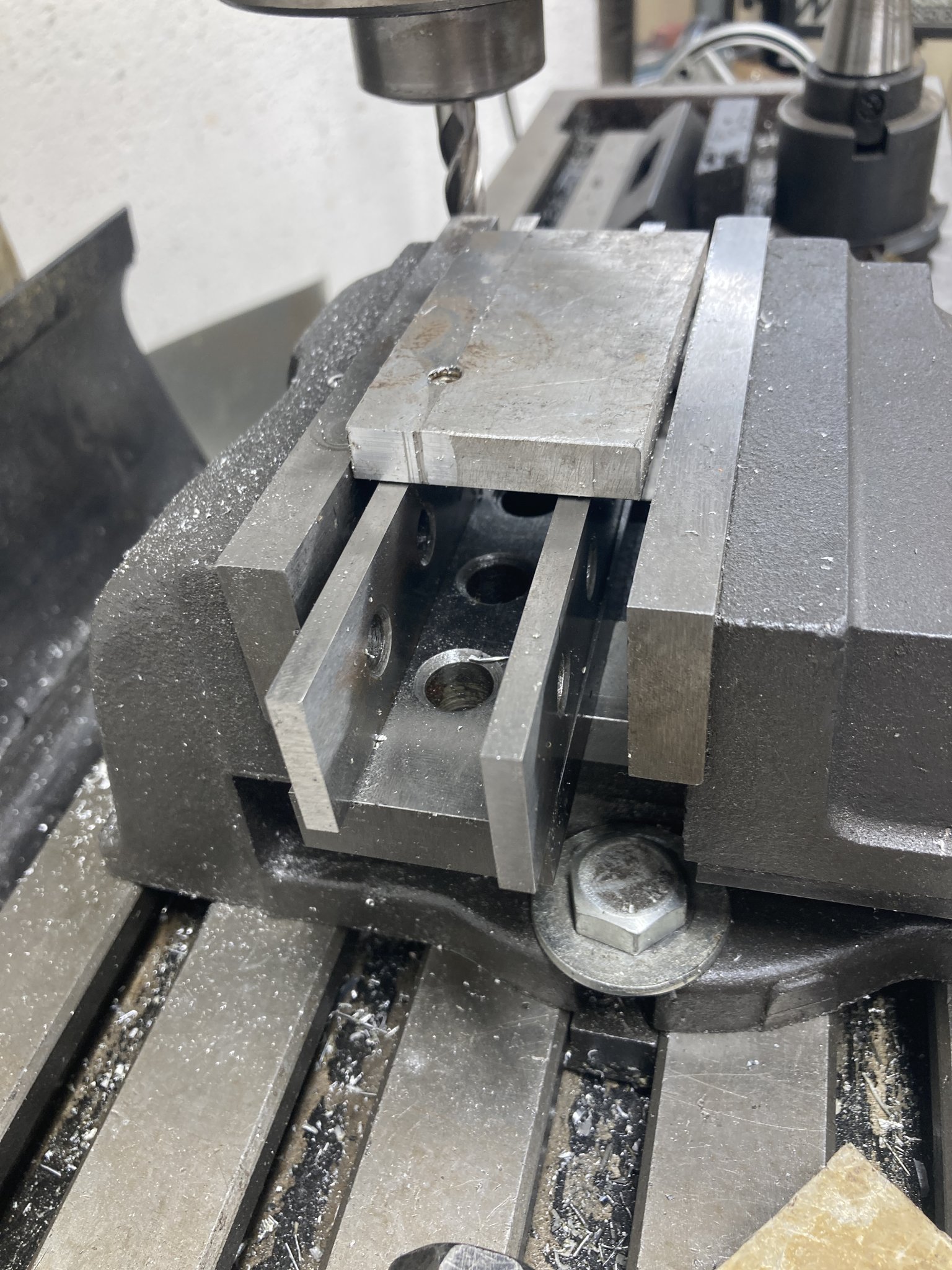

Now its off to the mill to make the mounting plate.
The original donor pieces were not very "square" so I perform a serious of what I consider "kinda dubious" moves with my Chi-Com parallel's, in order to square things up a wee bit.
After a few passes with the mill, I get what I consider an "acceptably accurate block" to work with.

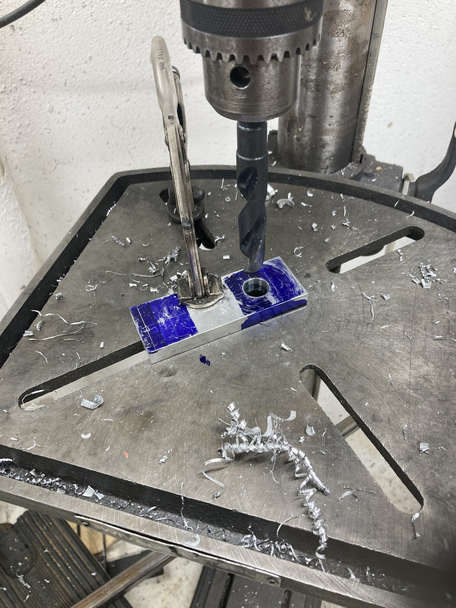

Now I have to just drill a few holes.
But "Ill be damned".....I can't figure out what my wife did with the damn 11/16 drill that I need.... ;)
(I probably looked for 40 minutes, but "no joy")
I decide to just get it close, by using the next smaller one.

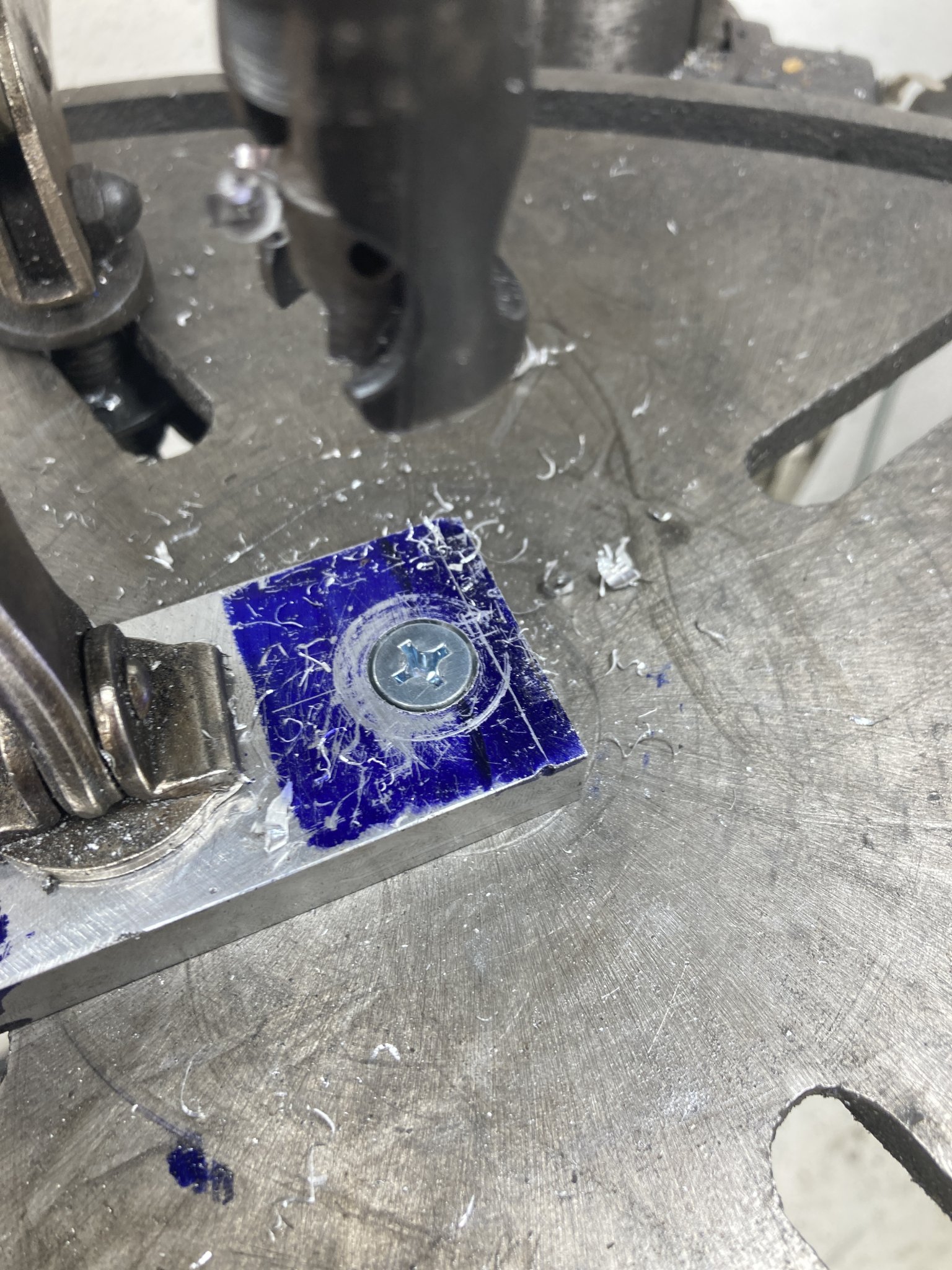

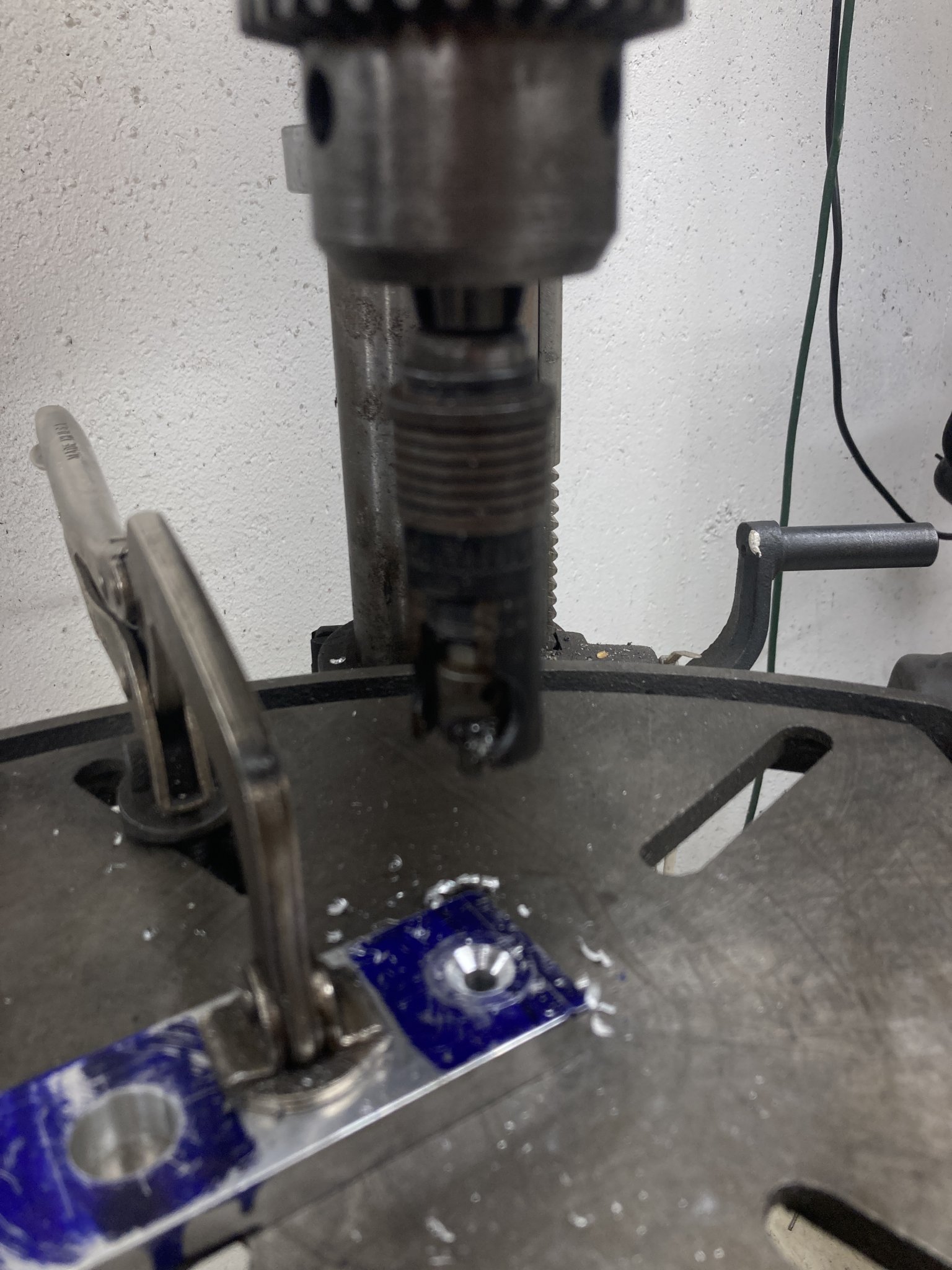

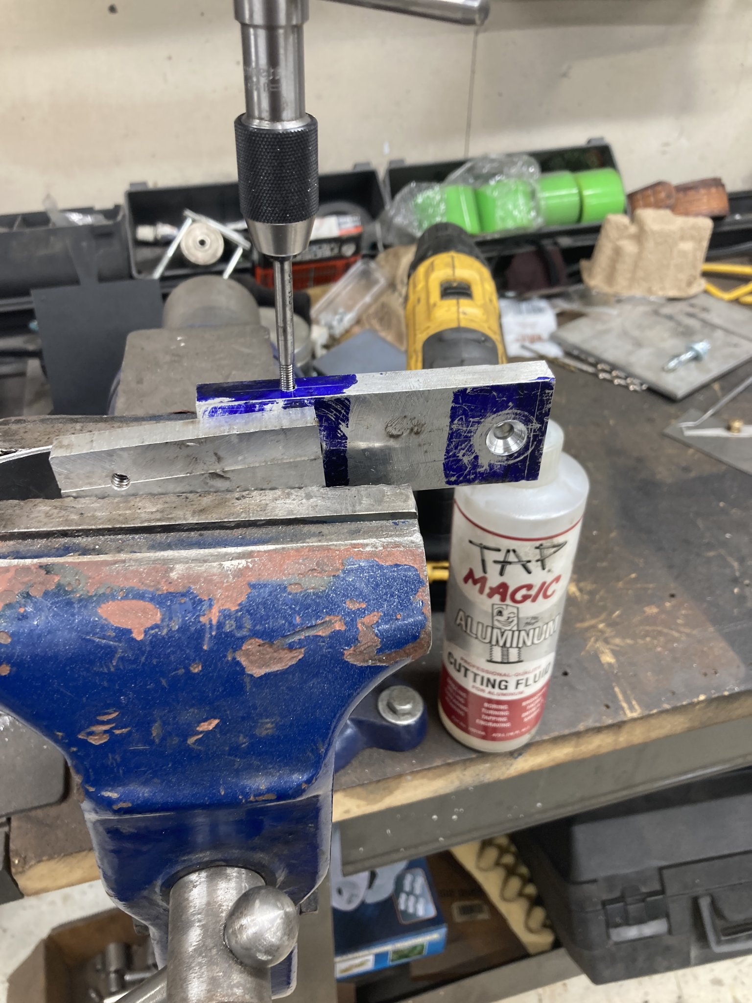

so I drill the hole for the attaching screw, and use this little "micro adjustable counter-sinking tool" from "way, way back in the day" when I was doing aircraft sheetmetal work.
Perfect!

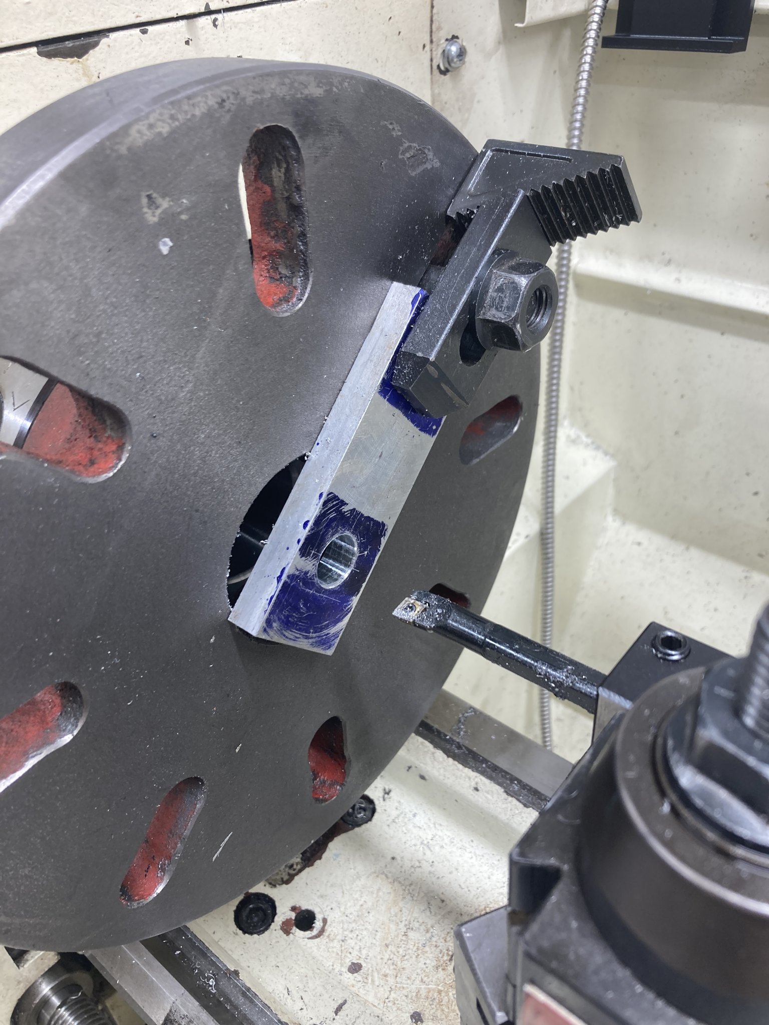

So being the "stubborn cranky Jarhead" that I am, I decide I am going use my "new'ish to me lathe", come "Hell or high water".
Just then, I look over and see this bad boy sitting there.
So I mount it up, and after trying to get it secured, this is the best I could come up with......
It's not as "elegant" as I had hoped, but there was no other way I could figure out how to mount a 2nd clamp to it.......Every configuration I tried either would not reach far enough, or it would stick out too far and hit the ways.
I reason to myself that it should hold it "good enough" for the small amount I need to take off...~.025'ish
It worked, so I tapped it for the cap screw that I will use to secure the pipe with.

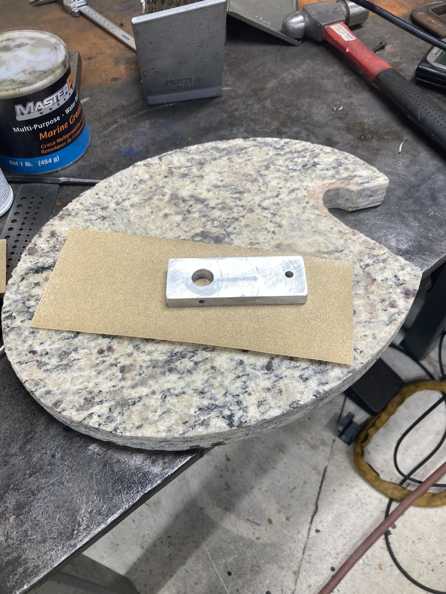

My milling skills need A LOT of work, so I have to use my "poor mans surface plate" (a.k.a a piece if granite I dug out of the garbage) to shine her up a bit.

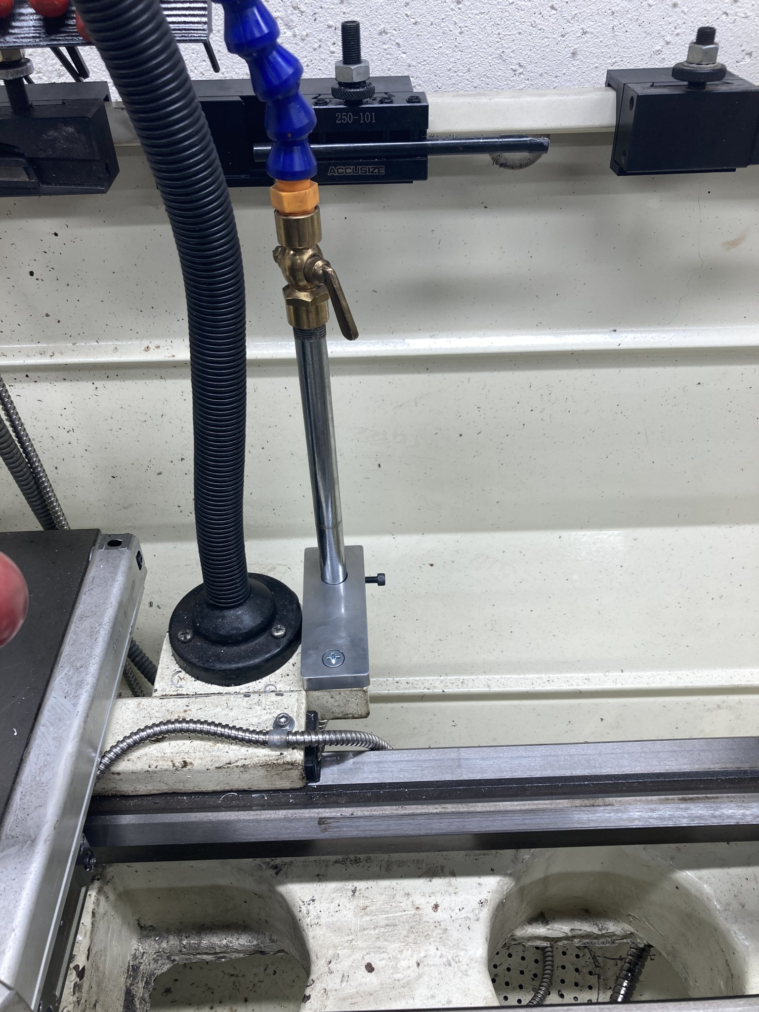

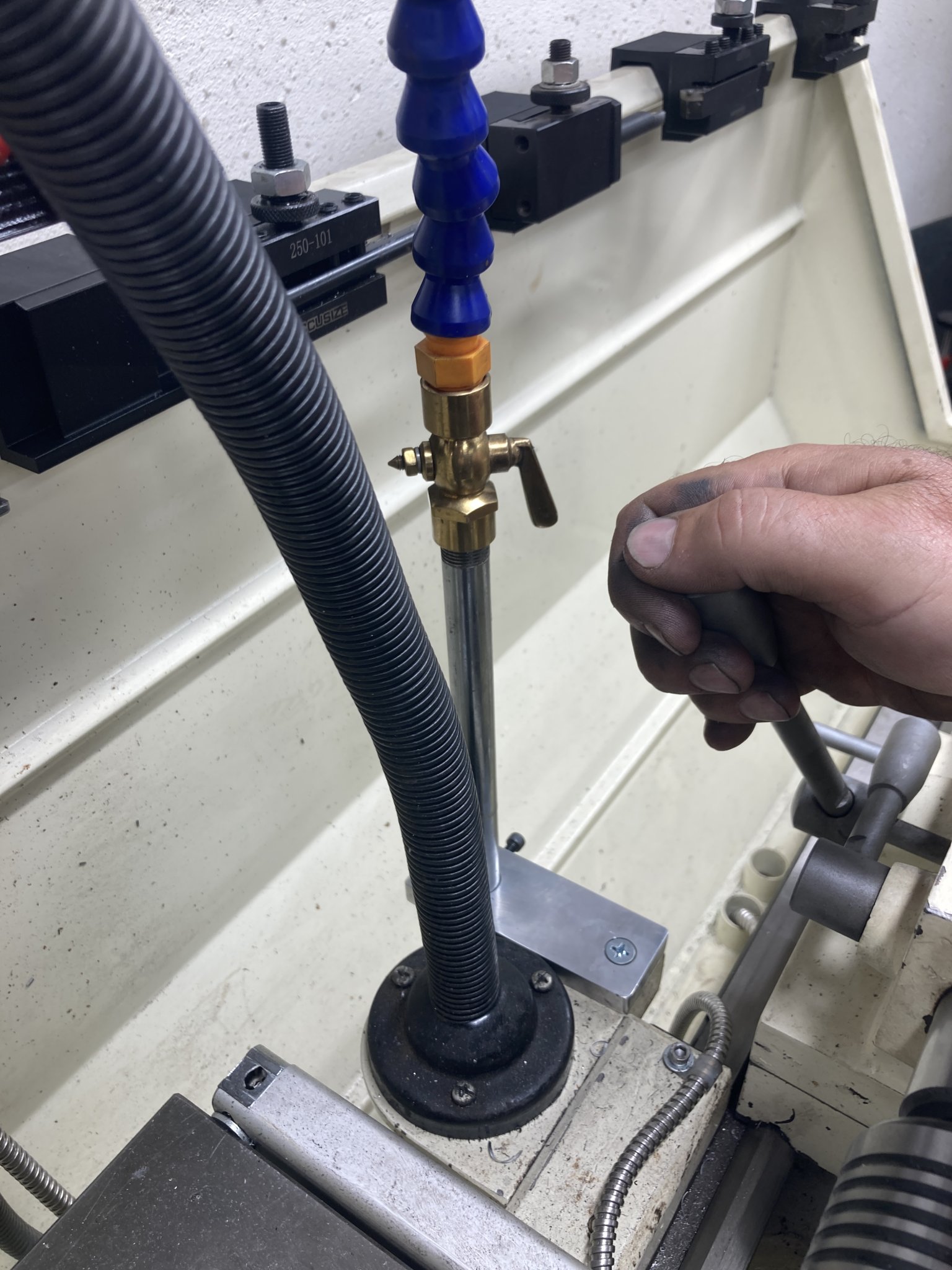

and Wa-La!!!!
Works like a charm.
No more "smashed fingers/knuckles/thumb"
Hell, you could drive a truck through there now!!!!
