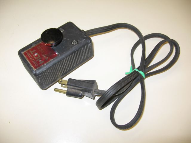

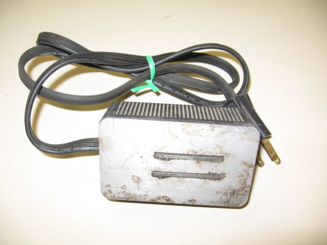

How big is the contact surface of the heater?
Roughly 2" x4" see pics. (can't measure, heater is 150 miles from here at cabin.)
