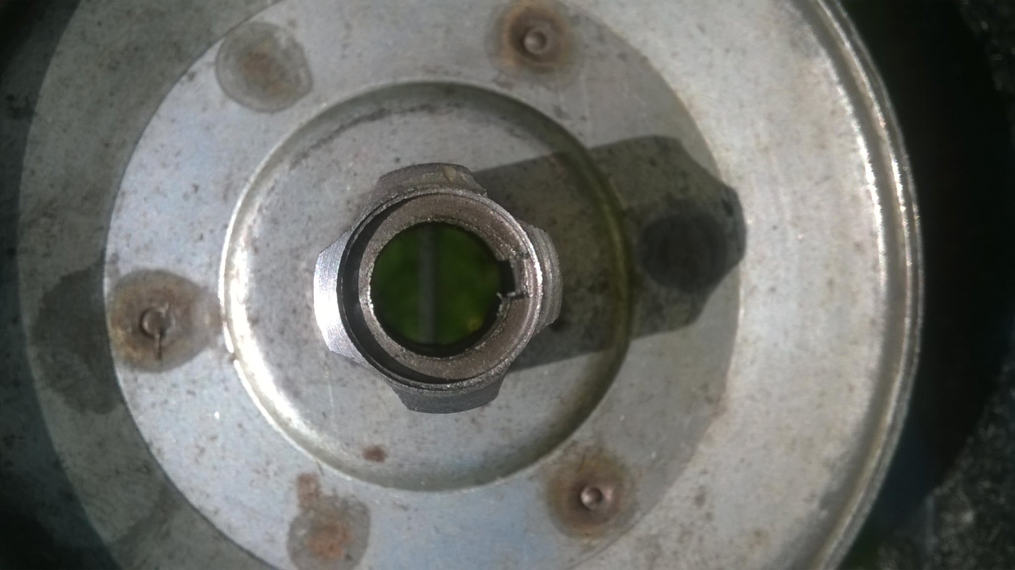

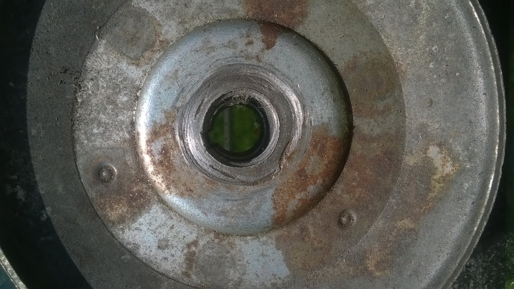

I know we have some very talented machinists on this site and I would appreciate your opinons.
My 25 year old JD lawn mower has a habit of eating the self propelled drive pulley. This is number 2. I see it might be available on the JD website but but the time I add the cost, exchange and shipping I could likely buy a mower.
So, my question - any hope of fixing this? Alas I did not buy that metal lathe 10 years ago so I am limited in my fabrication abilities but I can get pretty creative. Any hope here or just chin up and buy a new one?

First: I don't think we have any little machinists on here, I think they are all full sized. 🤣🤣🤣
I don't see what the issues is?
If it's the wear on the faces of the pulley shaft, I'm not understanding how that's impeding use?

A new pulley or pulley repair in itself will not fix your problems. You will need to replace the pulley AND shaft and determine why it is working lose to begin with.

I have never seen a pulley that has been "wallowed out" like that.
I cant imagine a keyed pulley doing that if it is a "proper snug fit".
Was it a "snug fit" when you put it on last time?

Seems like the only way the pulley would be "wallowed out" like that would be if it was spinning on the shaft. That shouldn't be possible unless the woodruff key is either missing or sheared.
You did put a new key in when you replaced the pulley, didn't you?

To better describe the issue the bore is no longer true , the slot for the key worn (at an angle) to the point the shaft slips when it tries to engage. The 10 mm shaft looks ok to me and the key itself is ok but would no doubt be better replaced.
The design is at fault I am guessing - a lever on the handle raises the transmission (and pulley) to engage the belt. It's likely not spinning on a perfect plane a good part of the time causing uneven wear on the pulley. The fit was snug to start but as I have a lot of hill work, it gets torqued out of shape over time.
I did actually buy the whole transmission unit the last time (and yes it was expensive 10+ years ago). The pulley seems to be reasonably robustly made but not robust enough I guess. Not sure if it could be trued up by drilling it out and welding in a ring with a key slot (sounds dicey) but I can't think of anything else (short of buying a new pulley).

I would say the shaft has been wore down to where the pulley is no longer kept tight to it'. Have you inspected the shaft/spindle to see if it has stepped on you. And like JimDel said; it looks like the key came out and the pully spun on the shaft. Sorry, I wish I could give you more info.

The hole could be bored to a much larger size and then a piece of bar stock welded in. Then a hole of proper size could be drilled and bored on location. Last, a keyway will be broached in.
A better solution might be to find a quality pulley the correct size, or at least one that can be easily modified, at a place like Surplus Center. That piece of tin from JD is something that should be upgraded.

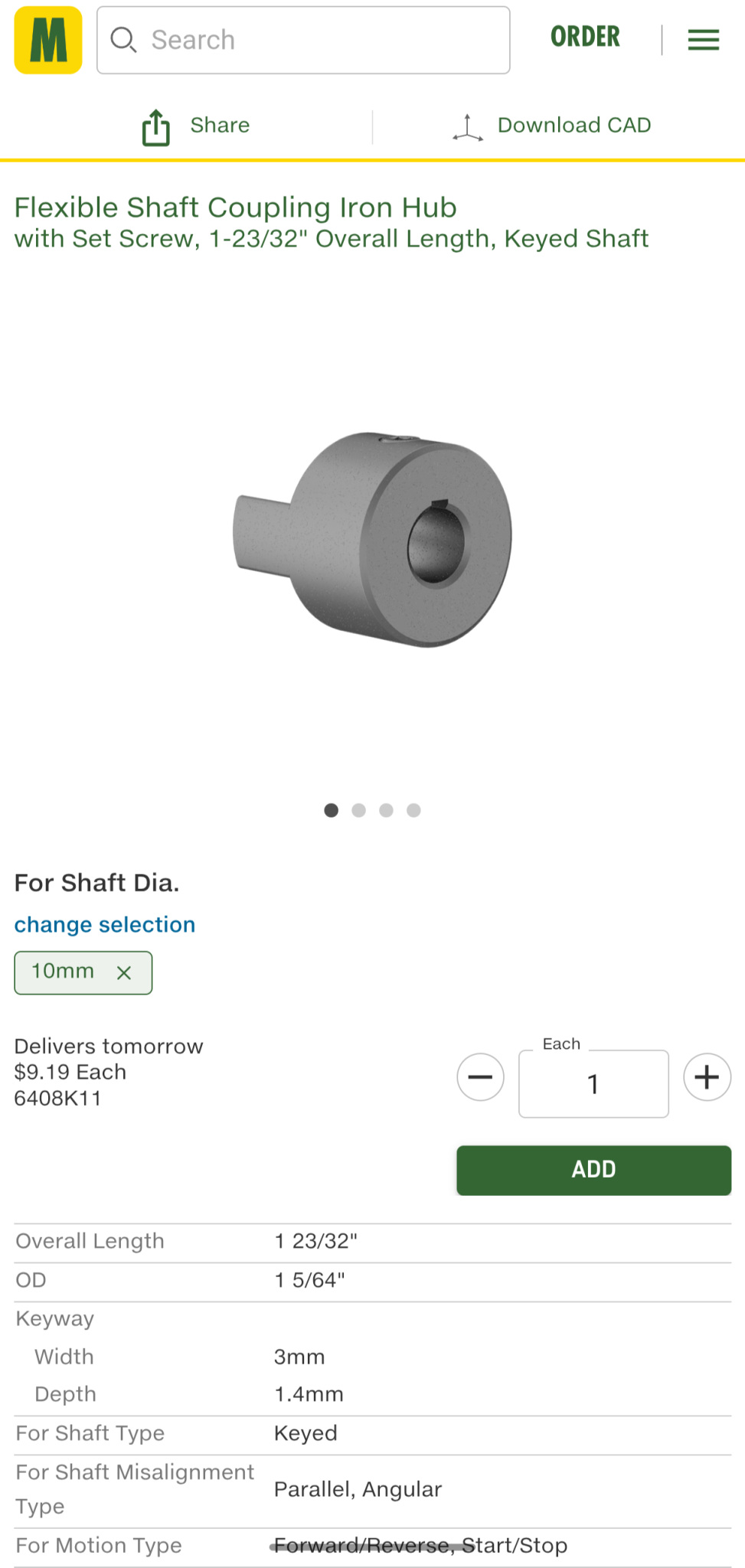

Hello Andy,
of course there is hope :)
The original design is flawed, you saw that yourself already, so no point in buying original spare parts again. What I would do is fit a locking assembly, something like this:
Since you do not own a lathe you could find a machine shop that modifies the pulley so that it can be fitted.
Kind regards,
Hugo
p.s.: you could also consider buying a Kubota lawn mower :giggle:

I could be mistaken but if shaft,bore and key fit snug you might be able to salvage and reuse the whole assembly without need for parts or precision machining.
It looks like keyed sleeve has a disc attached and relies on friction from being trapped between 2 piece pully that was spot welded together. Visualize sleeve w/disc assembly looking like cutter wheel of a plumber's pipe cutter. As that disc slipped under load it progressivly became loose,slipping.wearing then wobbling. The problem could easily been averted by spot welding pully halves to disc at same time pulley halves were spot welded together. At this point if bore can be aligned with pulley then 2-3 holes drilled through disc and both halves of pulley,tapped with threads then secured with screws. If screw heads and/or nuts cause interference, grind flush with pulley, weld,braze,solder or JB Weld tips of screws to prevent them working themselves out. Alternately if you have a spot welder, forgo screws and spot weld instead. Or if screw heads must be ground off to prevent interference, forgo screws, drill threw pully halves enough to expose disc then hit each hole with tiny rod in conventional arc welder/tig or mig.
The only challenge will be holding alignment throughout drilling,screwing , welding.
I hope all that is clear as muddy water since I was making it up as I went along. 😁
