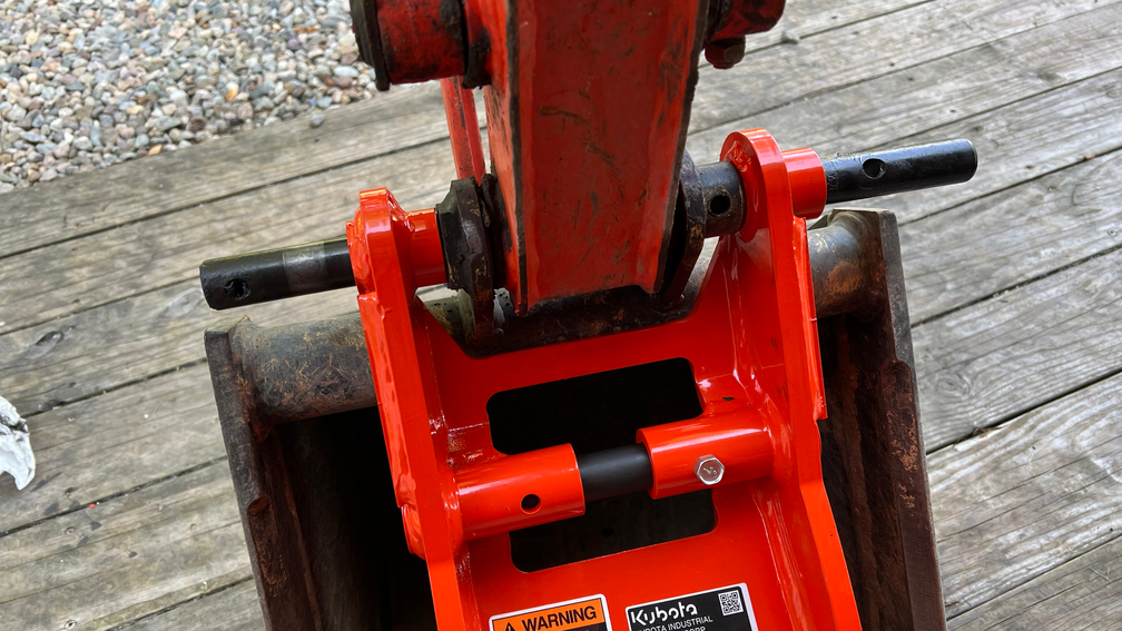

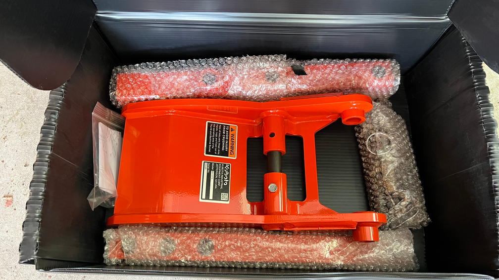

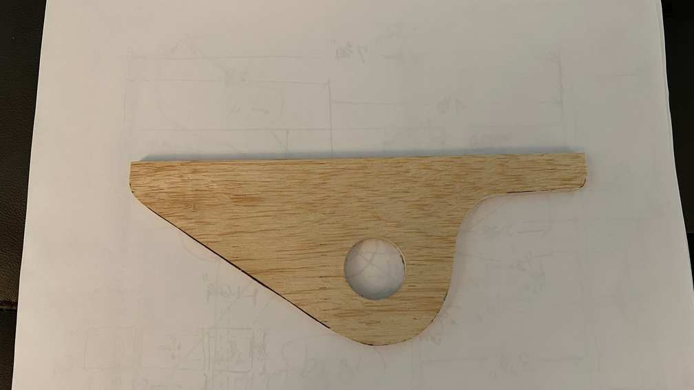

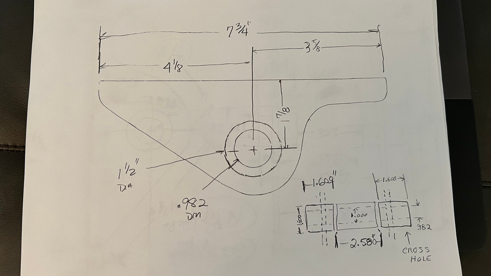

I have a B3030 with a BH75 backhoe. I want a thumb, but unfortunately, it doesn't have the dipperstick upper mount. I figured I'd start with the Kubota BH1976 Mechanical Thumb, and can always add hydraulics later. I took all the dimensions for the placement of the mount on the dipperstick, off of a BH77, and made a paper template of the side plates. I'm going to make a filler plate for the recessed area of the dipperstick, and tack everything together with the thumb positioned in the upright, non-used position.
I figured I'd throw the thumb on, and it took all of 30min...really easy! I used the old pin to hold the thumb on the outbound side to keep it positioned while I drove the new pin in.
It will be a couple weeks before I can get to this, so I'll update as I get things done.

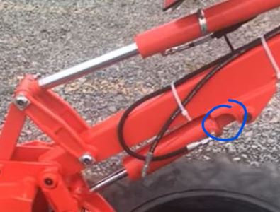

The "stock" Kubota mount has a cutout on the upper flange to accommodate a hydraulic cylinder. From what I've seen in other threads, some have had to modify the cylinder so the hydraulic connector is pointing in the right direction.

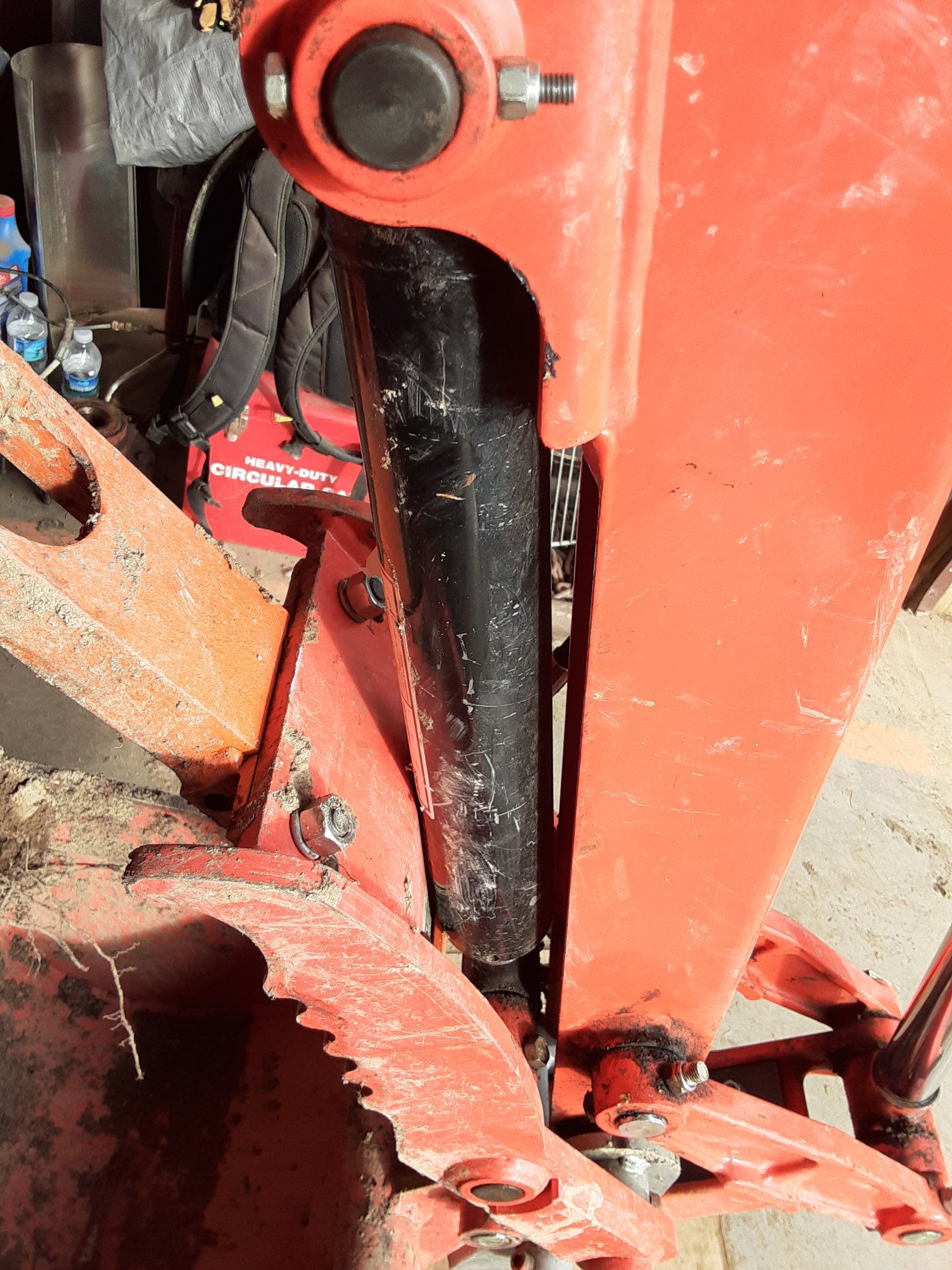

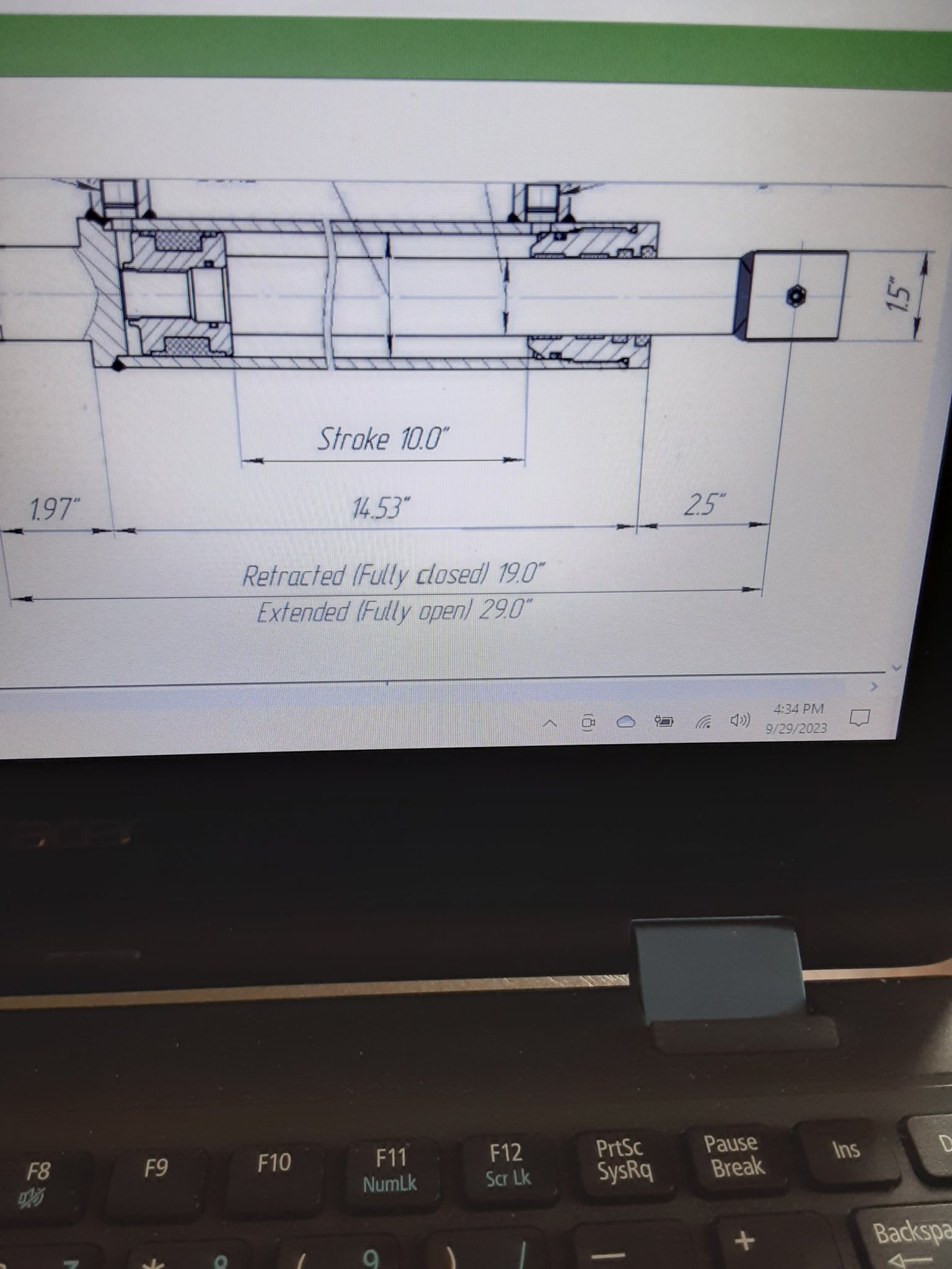

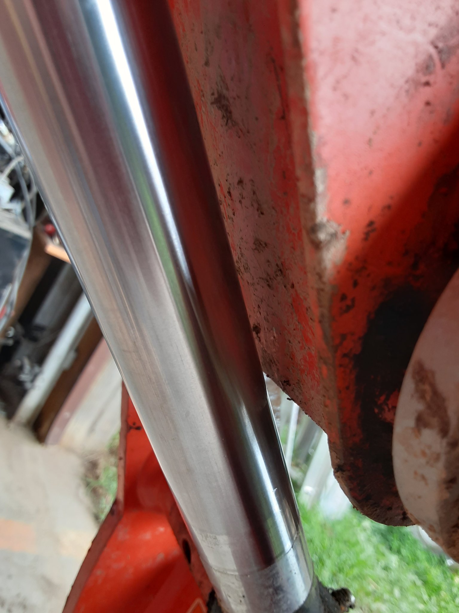

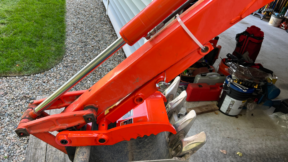

If you use this cylinder it has the fittings clocked to the side. It is almost perfect length and the shaft end fits the thumb perfect too. When i used it to get the thumb up tight I plugged and welded the base end to rebore the hole about a half inch shorter if I remember right. You will want to chek this like he is doing with it held up. Then I welded a 1" shaft collar on each side. I had to mill a little off each side to fit the spacing but it really works nice. I was able to snake 1/4 hoses thru with the other ones.
Bill
I checked and measured my work. I relocated the base end hole about 3/16 to a quarter, shortening the mounting pin spacing from 19" to about 18-13/16". I did this for 2 reasons. to make the thumb tuck up tight to the cylinder and keep the shaft from touching the dipper arm when fully extended. Now it misses the end of the dipper by about 1/4" which if it was to contact would damage the rod for sure.
I tried to take some pictures but I am having a hard time downloading to my computer from my phone. If I can get them I will add them here.
Bill

I think if I was doing what the OP was doing I would position that new mount at 19 center for this cylinder to save altering the base end. But in my BH77 instance that wasn't an option as the mount was already welded on. The base end is 1.5 wide like the shaft end and the mounting area for the base is 2.5" I welded on a spacers to get it to that so it wouldn't be slopping around and or bending the pin. One last thing was I mounted the rod end with the grease fitting up so it wouldn't get packed with dirt.. It is accessible for grease when it is down.

This may help, or not. BH76 and my add on ram

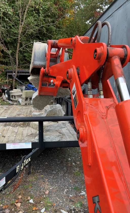

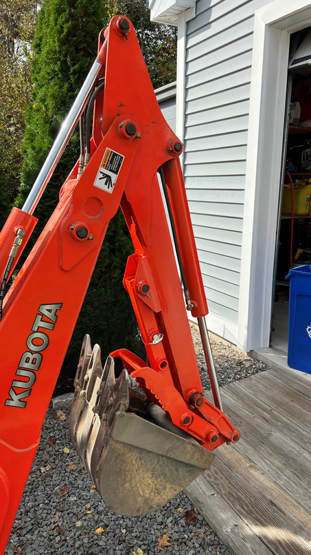

It's finally done!!!!
Really happy with the way it came out.
I decided to not cut out the sides like the factory mount. I think it's stronger, and not necessary to hook up a cylinder. I could always have it come out the back side like Tarmy did. The reality is I don't see myself going to a hydraulic thumb, it's not something I use that often.
I did have some concrete to move...and the thumb worked as expected!!

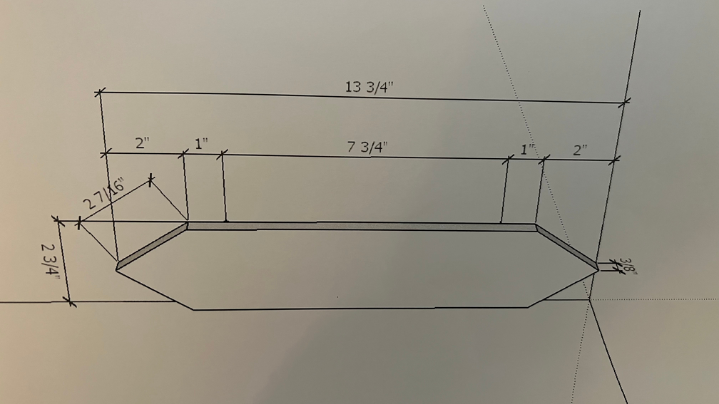

I was using my thumb last week redoing a small frog pond we have by the driveway. A lot of rocks and to be able to grab those bigger ones is a back saver. I put a bxpanded quick change on last year and find they mess up the thumb/bucket where they come together. I made a extension for the thumb that helps
Out of 3" channel and it comes between the center teeth of the 16" bucket.
