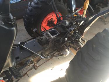

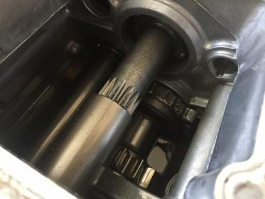

Thanks for the input, it was very helpful. I was 4 bolts from making a discovery. Looks as though the 2nd gearshaft with 13T-18T gears has stripped 3 teeth off the 18T portion of the gear. I have provided an image of the damage, and a screenshot of the diagram in question. I also have provided a photo of the stage of disassembly I***8217;m at. Just curious to know if I can split the thing further back (at the HST Pump) without disturbing more than necessary. Thanks for your time and advice. Not sure the images worked, I will try again. The diagram I am referencing is on pg.198 of the WSM.

Hello,
I was curious to know if anyone could advise me on how to move forward with this repair. Following the manual it appears I would have to separate the clutch/bellhousing from the engine, remove the steering wheel, fuel lines, etc. I’d like to know if it is possible to separate the tractor closer to the HST. Looking to see if anyone on the forum has had to make this repair. I’d like to confirm my suspicions before following the procedure outlined in the manual. Any input is appreciated, thanks in advance.
Dale
33,855
9,075
I don't see any reason that you can't split it right at the hst, It does just bolt on, you will need to get the roll pin out of the coupling on the propeller shaft and the shaft to the front wheel drive, before you split it.
Also make sure you have disconnected all the linkages.
