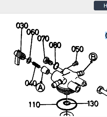

The pic is front the 7100 manual. I think, from the bleeding screws. When I close the fuel off, it stops, but when I open it is pretty steady, but hard to tell were from but it seems the bleeding screws to the "ficture"
35,007
10,251
I put the pic of the parts and it should one of these parts that are leaking.

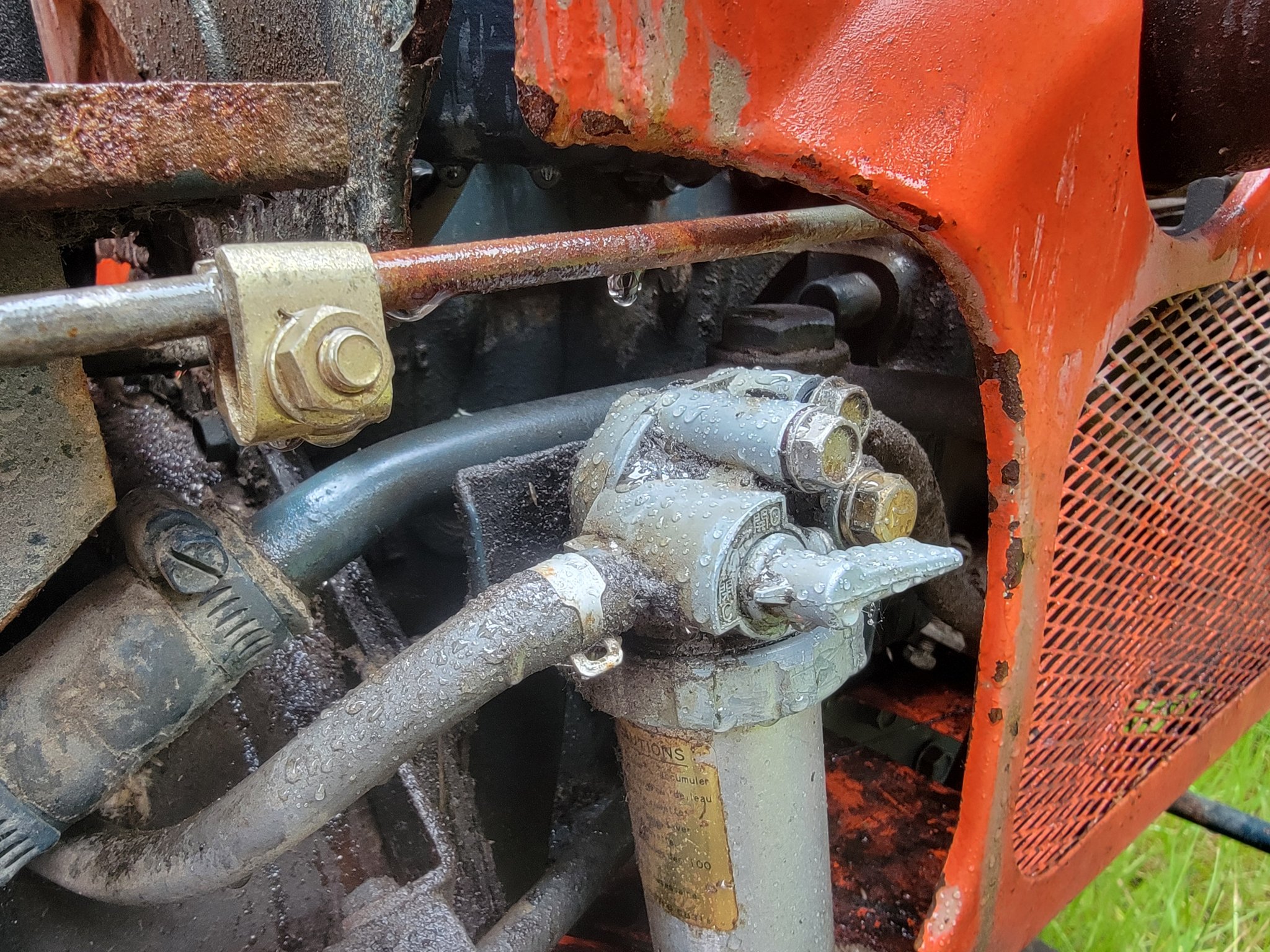

Here
Sorry I am away from the tractor a bit, but https://www.manua.ls/kubota/b7100hst/manual?p=40 shows closer to what I see, where there are 2 10mm bolts over the fuel petcock, and 1 12mm to the right. The leaking is froom the 2 10mm bolts. They hand tighten to a point, and then just freespin. The 12 mm bolt tightens just fine.
This does not match the parts diagram at https://www.messicks.com/catalogs/kubota/b7100hst-d-old-type-s-n60163/fuel-system/t05900-fuel-filter or https://shop.kubotausa.com/oemparts...6000-fuel-filter?lid=6076dff24f231b5030d5ad1a which is also different from the one you screenshot. So maybe I have a different fuel system installed?

This is what I have you can see 2 10mm bleeder screws above the petcock, those on the ones that are not tightening and therefore leaking.

To close this thread out, turns out both bleeder screws were stripped and it required a new housing, so I sent it to the dealer. I found this out by remove the screw completely and noticed metal shavings on the thread, or there the thread used to be.
