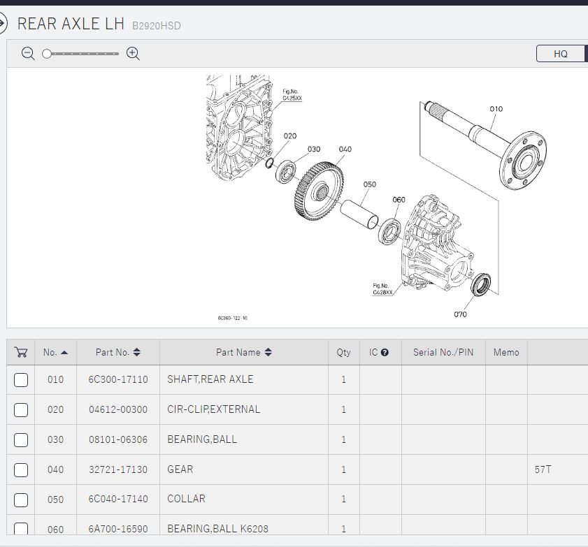

Just a thought. Moving the wheel out that far from the axle shaft creates a cantilevered load.

Hello Henro,
I guess that the design engineers could provide a detailed scientific explanation, but looking at it as a common sense answer..............................................the bearings (part 060) will have a shortened life, and when they fail, the oil seal (070) is likely to fail. How much shorter a life? Who knows, only time will tell. There are several people offering 6" spacers for sale. I guess that they wouldn't be selling many if you put them on, and the following week the hub sheered off the axle when you hit a bump.
If you put them on, let us know how you make out after some time has passed. We will all know the answer then.
Good luck with it!
Hello Henro,
I guess that the design engineers could provide a detailed scientific explanation, but looking at it as a common sense answer..............................................the bearings (part 030) will have a shortened life, and when they fail, the oil seal (070) is likely to fail. How much shorter a life? Who knows, only time will tell. There are several people offering 6" spacers for sale. I guess that they wouldn't be selling many if you put them on, and the following week the hub sheered off the axle when you hit a bump.
Good luck with it!
Thanks for the reply. For some reason when I clicked on the link it did not work, but I see you image as part of your post.
Interestingly, I remember reading a post somewhere that said the likely bearing to fail was the one on the inside, #30 in your image, rather than #60.
I think this was because #60 was a pivot point. Don't know, but interesting non the less.
Just something I remember and have not resolved in my mind...
