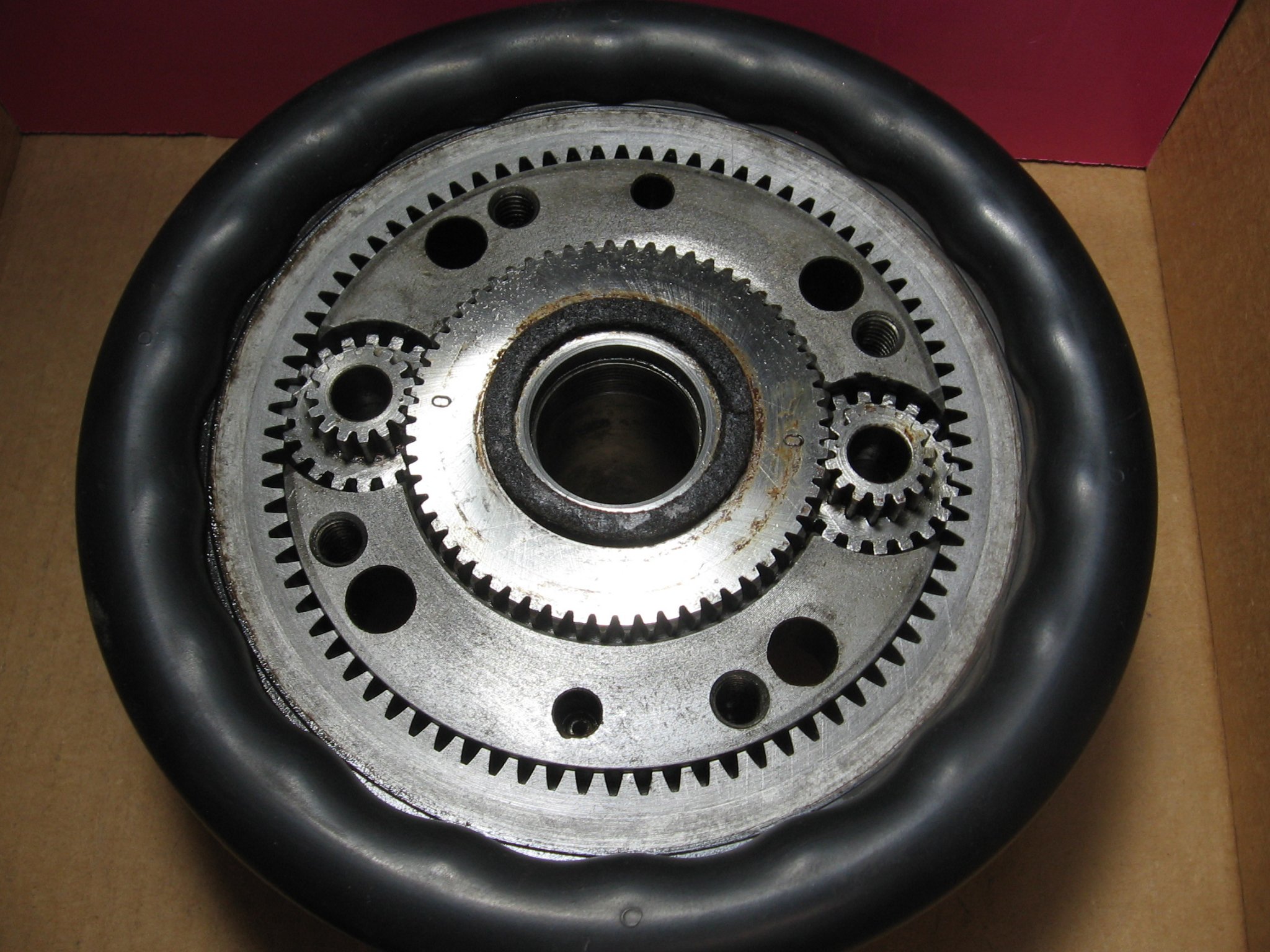

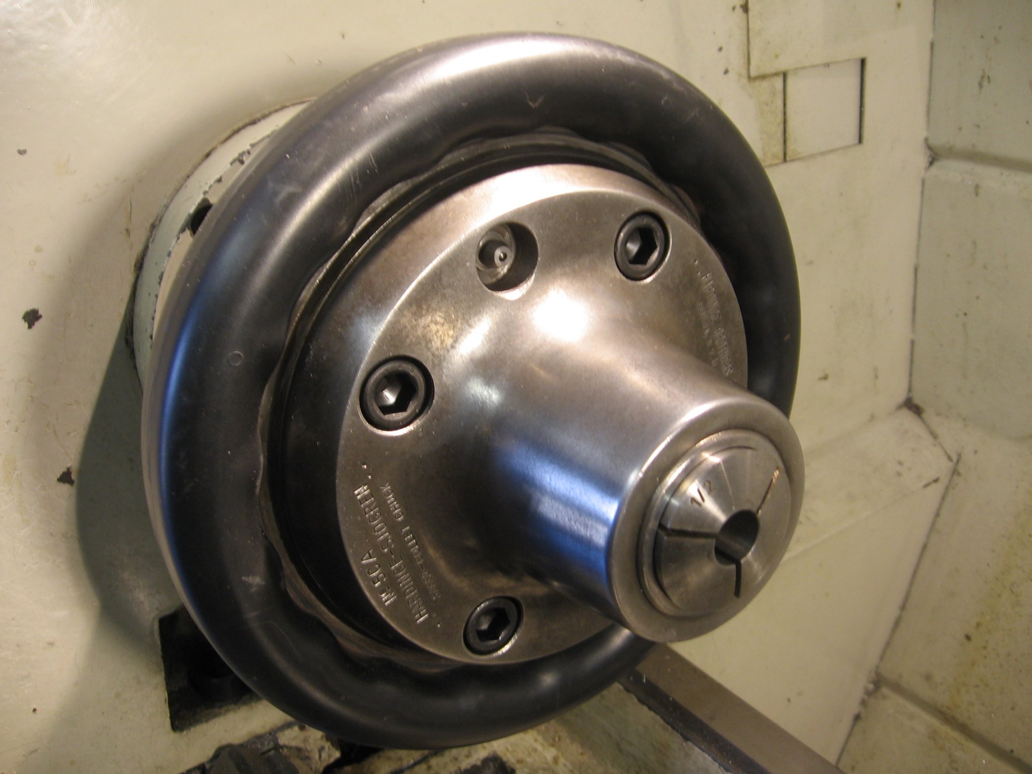

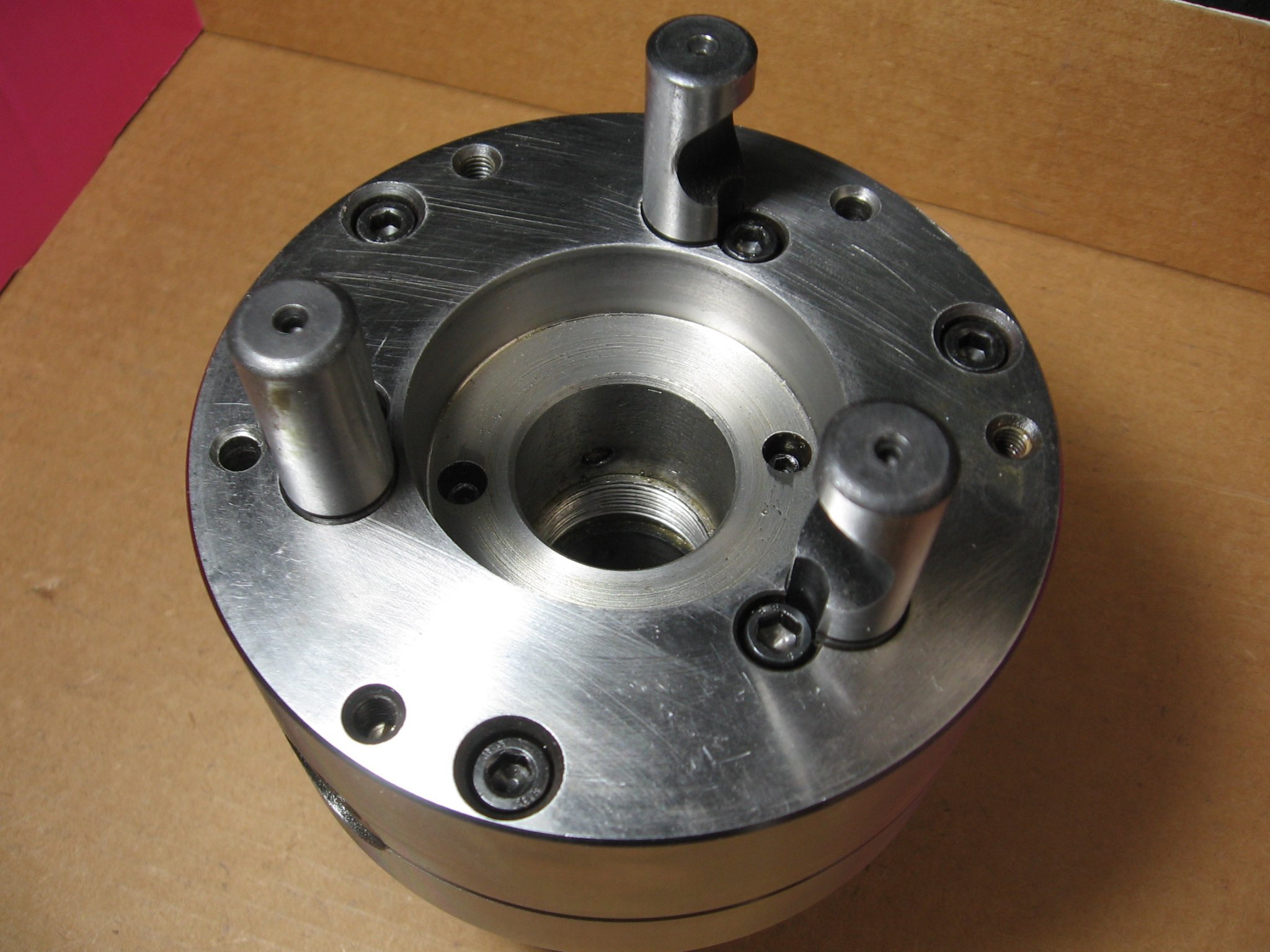

I recently picked up a Hardinge Sjogren 5CA plain back chuck. My lathe has a D1-4 spindle, so I found a machine-to-fit D1-4 backing plate on eboy. First, I disassembled the new (to me) chuck for cleaning & re-lubing. All parts looked good, so it was reassembled.

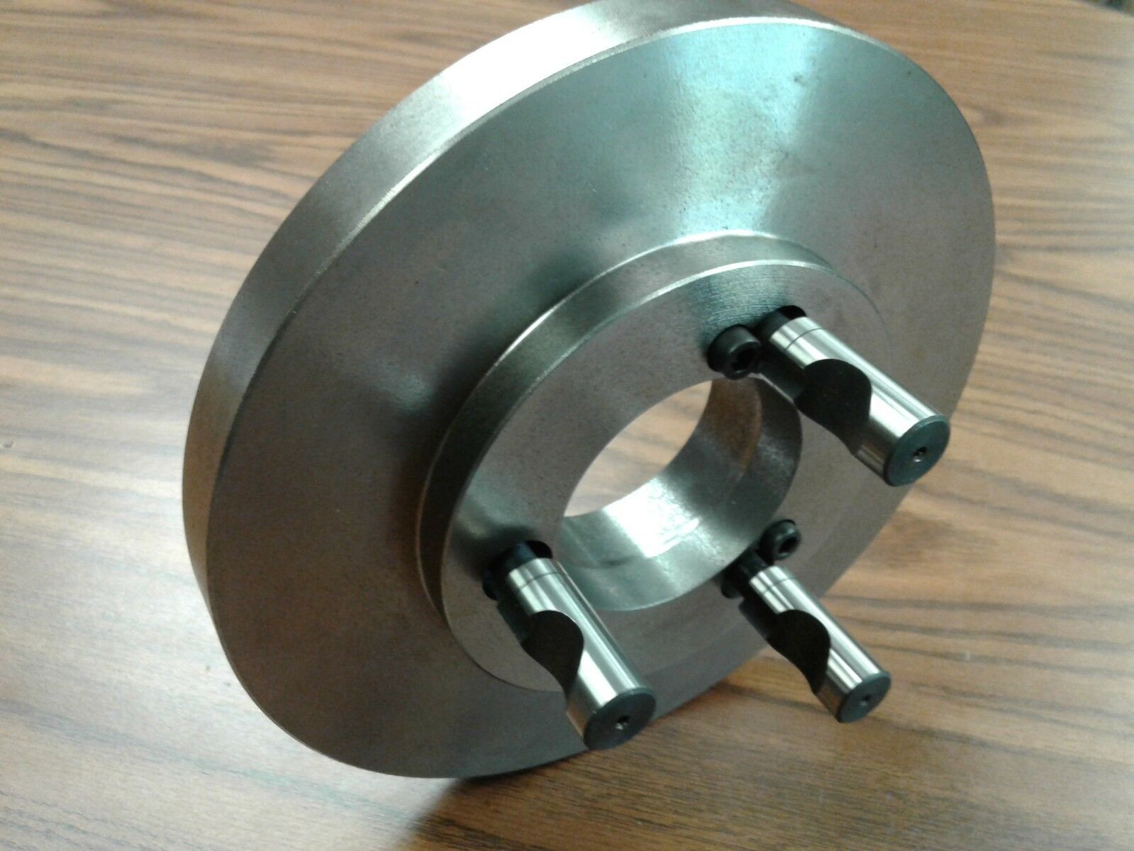

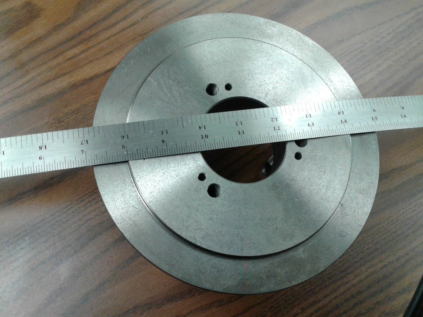

Then I machined the backing plate. Normally these are cast iron, sometimes mild steel, but this one was 304SS. Kind of a PITA. Reduced the thickness from 1.125" to 1.000", reduced the OD from 8.100" to 5.500", drilled and tapped (4) 7/16 x 14 holes on a 4.125" bolt circle, then turned a 4.9995" x .190" s-l1600-1.jpg s-l1600-2.jpg s-l1600.jpg register to fit the recess in the back of the chuck.

Nice score Bill! I am truly jealous. Bet the run out on that guy is just a few tenths.
7,301
2,260
You're right, .0002 to .0003 depending where I measure.
