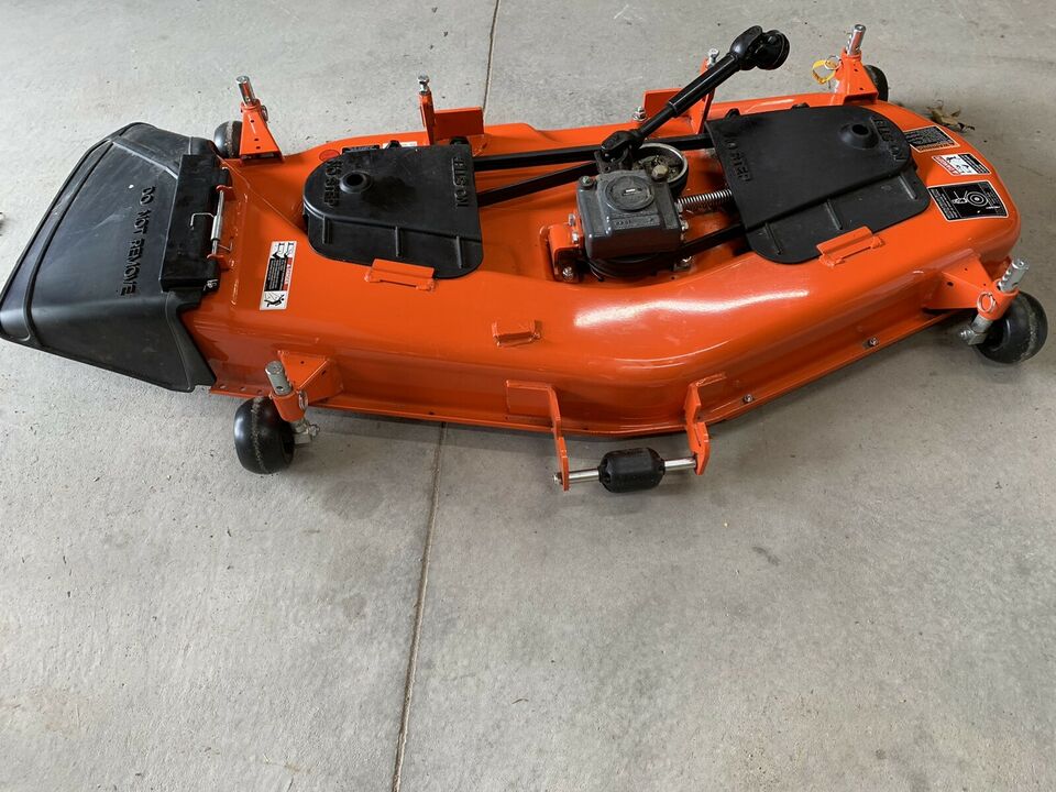

New here with a problem: I have a G1800 with a rusty deck that is barely worth patching and have been lookign for a good replacement but all the decks I have seen are for PTO shaft comin gin from the rear of deck, mine is from the front. mine is a RC54-G20 model , most of the ones I've seen are RCK54-23BX. it looks to me like the gearbox could be rotated 180 degrees and if this is possible I could use one of these decks. I woudl love to buy a shell and use all my parts on it, but since thats not an option I have to find one. I'm new to the 4wheel steer and love it. I'm trying to be pre emptive here before my deck tears itself apart .......................... thanks in advance. this is a pic of the deck i'm looking at it doesn't seen as heavy built as mine but isn't rotten. this is the rck54-23bx

Something to consider is the direction of rotation of the PTO shaft to avoid the blades spinning backwards.
This one appears to have the blades run CCW by design:
