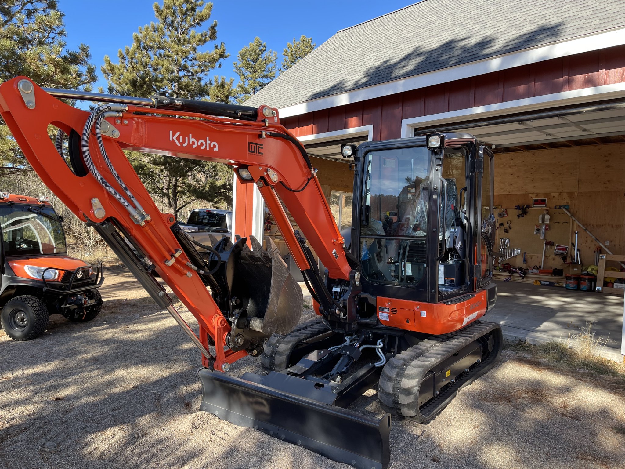

Delivered today. Brought the manuals in so I can run through everything just in case. Not my first tractor, but it is my first excavator!

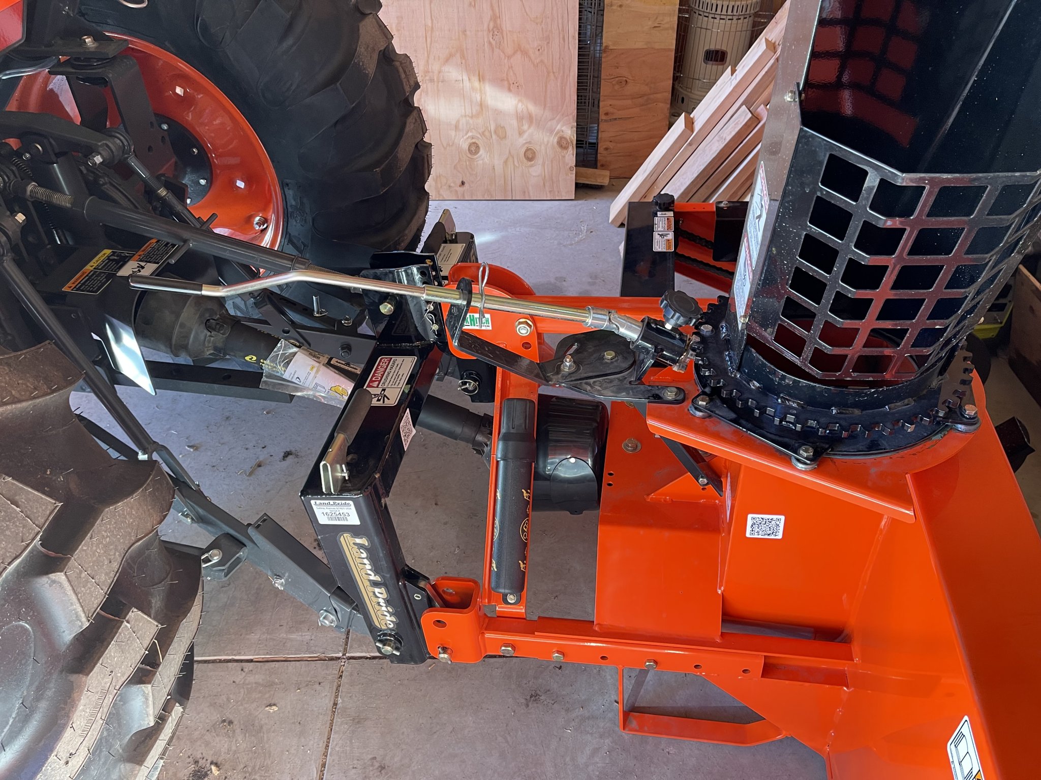

Dealer also threw in a QH15 because he didn't want to have to cut the PTO shaft..not bad. However it doesn't look level with the Blower attached, and the bushings are too thin to completely cover the pins under the bottom QH hooks. Ill remove, level the QH and replace with full length bushings.
