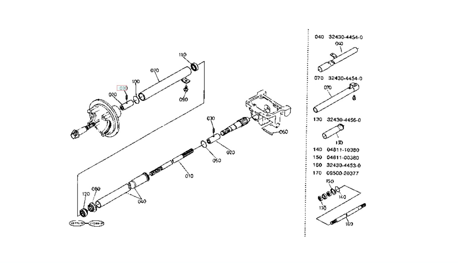

Look at the splines under item #20. Take the shields off. Remove the roll pin, slide the coupling, notice the condition of the splines on the shaft and and the splines in the coupling.

The couplings get worn more than the shaft and will slip if worn too much. ;)
