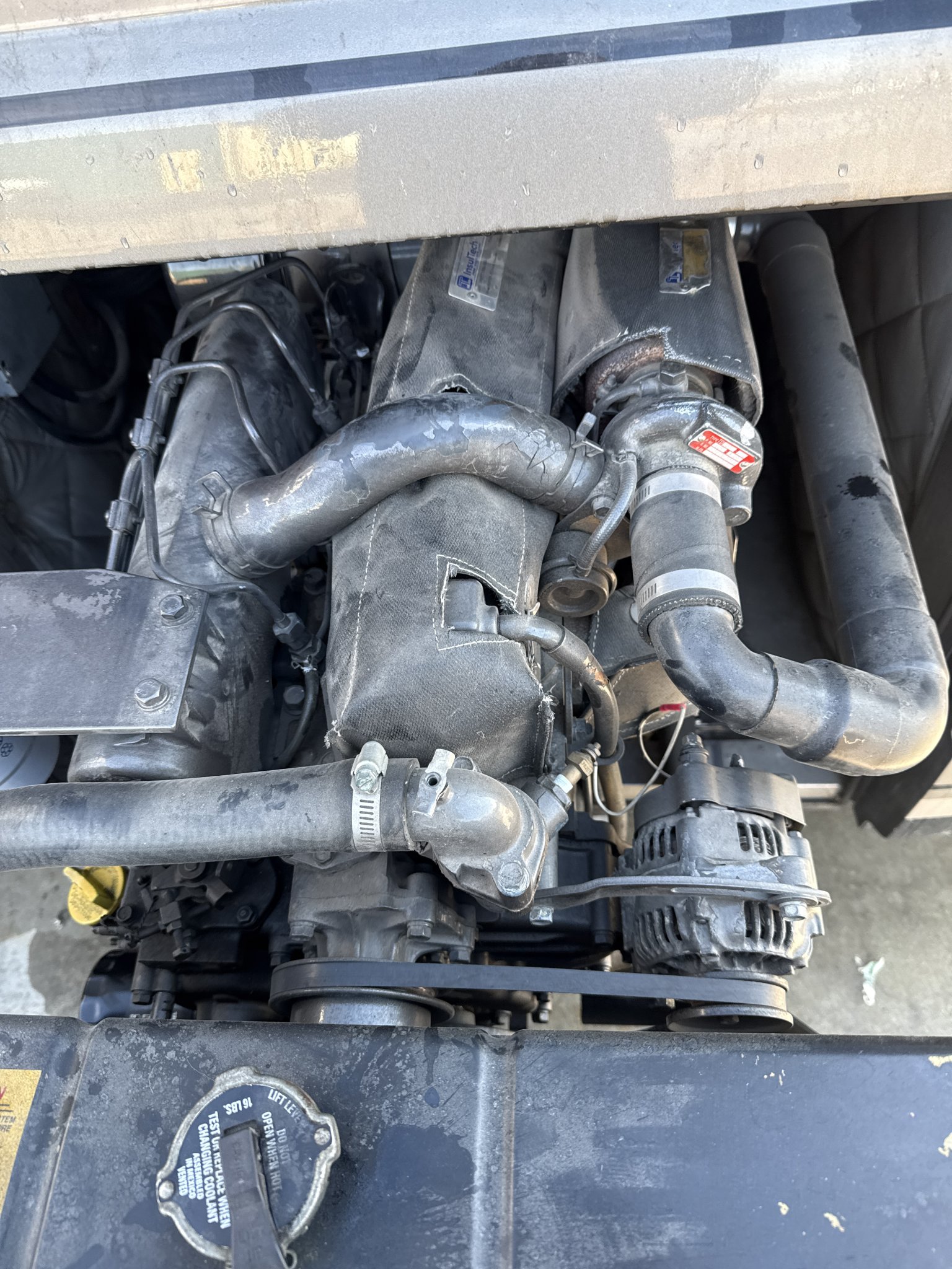

It’s a 20kw unit from powertech on a 2002 Newell coach. I’ll look harder tomorrow, but I was unable to find any data tags. I initially thought it was a yanmar engine, but after talking to someone familiar with Newell and sending a pic they told me it was a Kabota.

Try to get some pictures of your setup and any ID tags on the motor. Will help with helping you.

That’s a picture. I took a couple of days ago when I get back out to the motorhome I’ll see if I can get some better pictures or maybe find a data tag.
