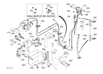

ED I have no idea I think it is Kubota but the print out doesnt say LP or K. The switch part# is7j5684152 and is 190 on the parts drawing. Tom I will try to get a picture of the drawing and of the switch it self.

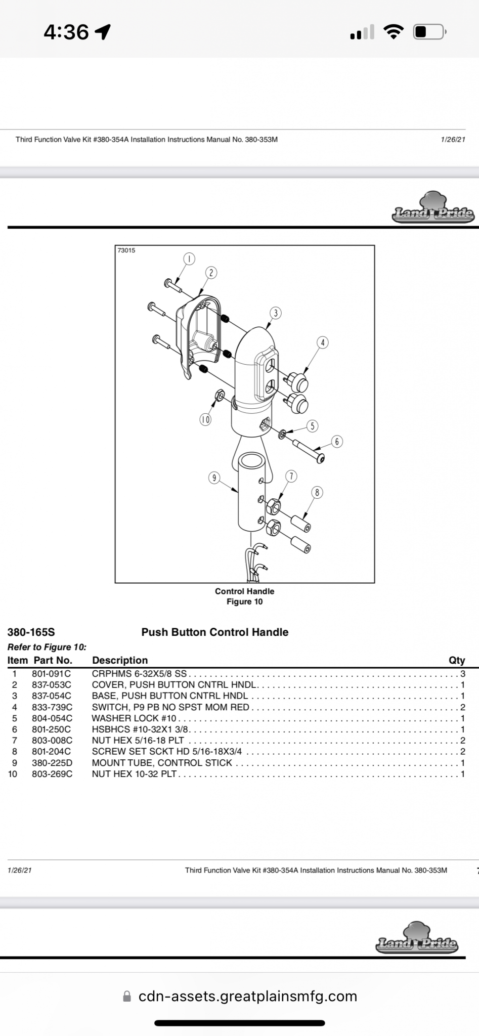

If it’s a land pride it’s should look like this

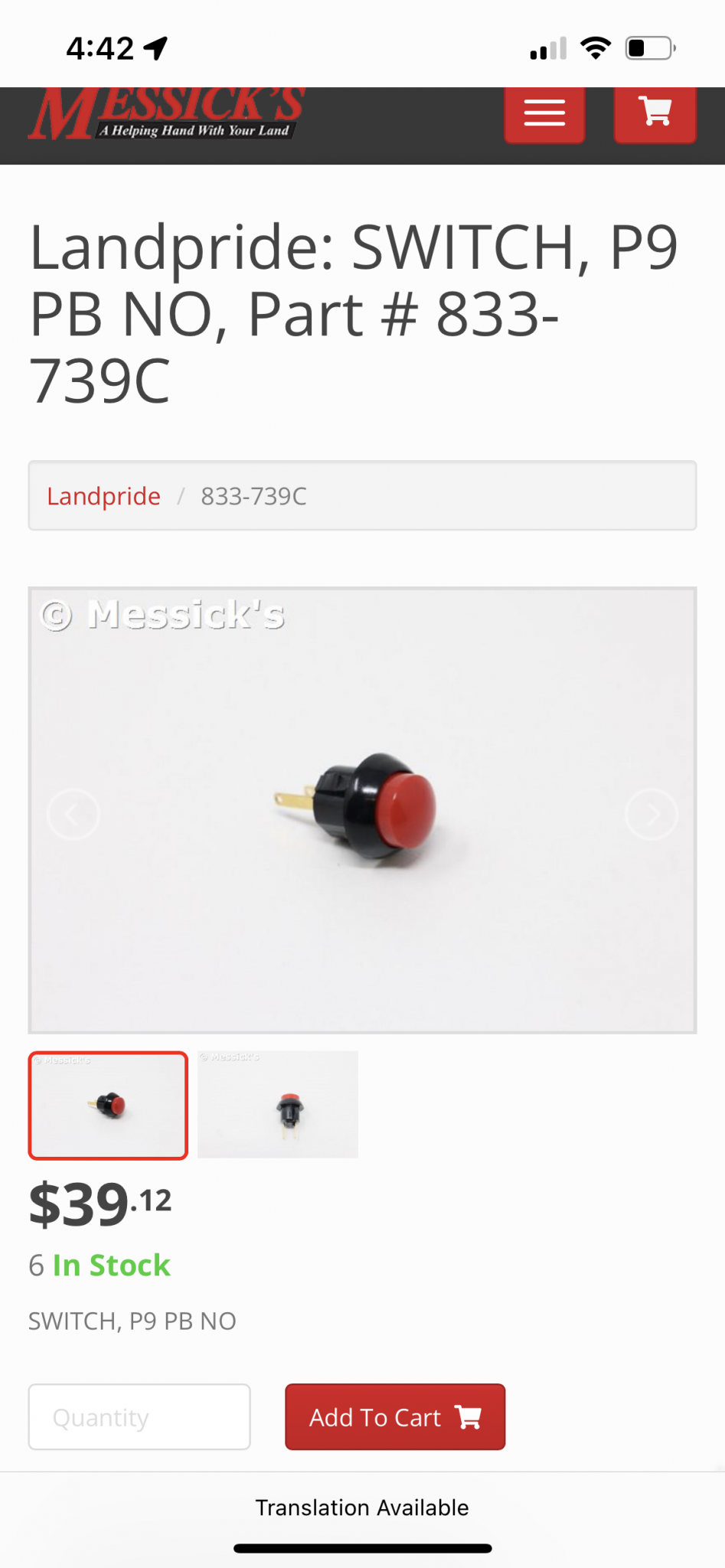

Apparently you have a Kubota kit that includes an on-off switch, other kits stay on all the time. You should be able to find a switch at places like Allied. If you can fit one from an electronics place you will free yourself from the high priced nonsense in the future.
