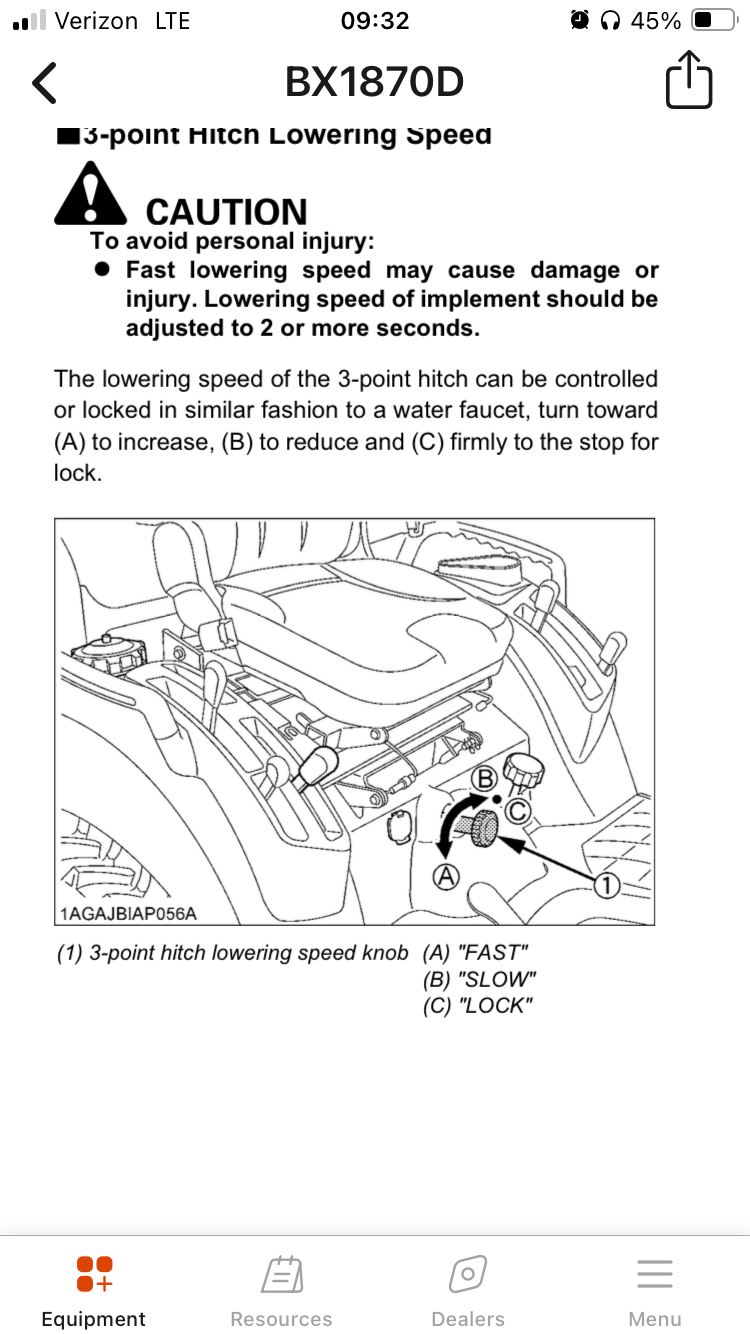

Have you tried adjusting the lowering speed knob?

On the one Ford an three Kubotae I've had. UP speed was pretty much the same with different implements. DOWN speed varies a lot with the weight of the implements. The adjustment knob mentioned is what I use to get the DOWN speed desired and prevent heavy ones from slamming to the ground.

I've played around with the speed dial. There is a point where the implement is a certain distance above the ground and goes from slow to just clunk drop. No real fine control below that point. The old NH compact had multiple holes on rocker arm and lower arm for positioning implements and meeting load requirements. No hole option for repositioning the rocker arm on the lower arm on the BX. Just need to adjust my "technique" and develop a better feel. Using the box blade for tearing out wild blackberry and leveling the area was quick and easy. My driveway at the transitions from up to down and down to up even with just a back blade has been challenging.

Thanks for the picture. When I get back home, will look as I don’t recall a knob for that, just a knob for the mower.
