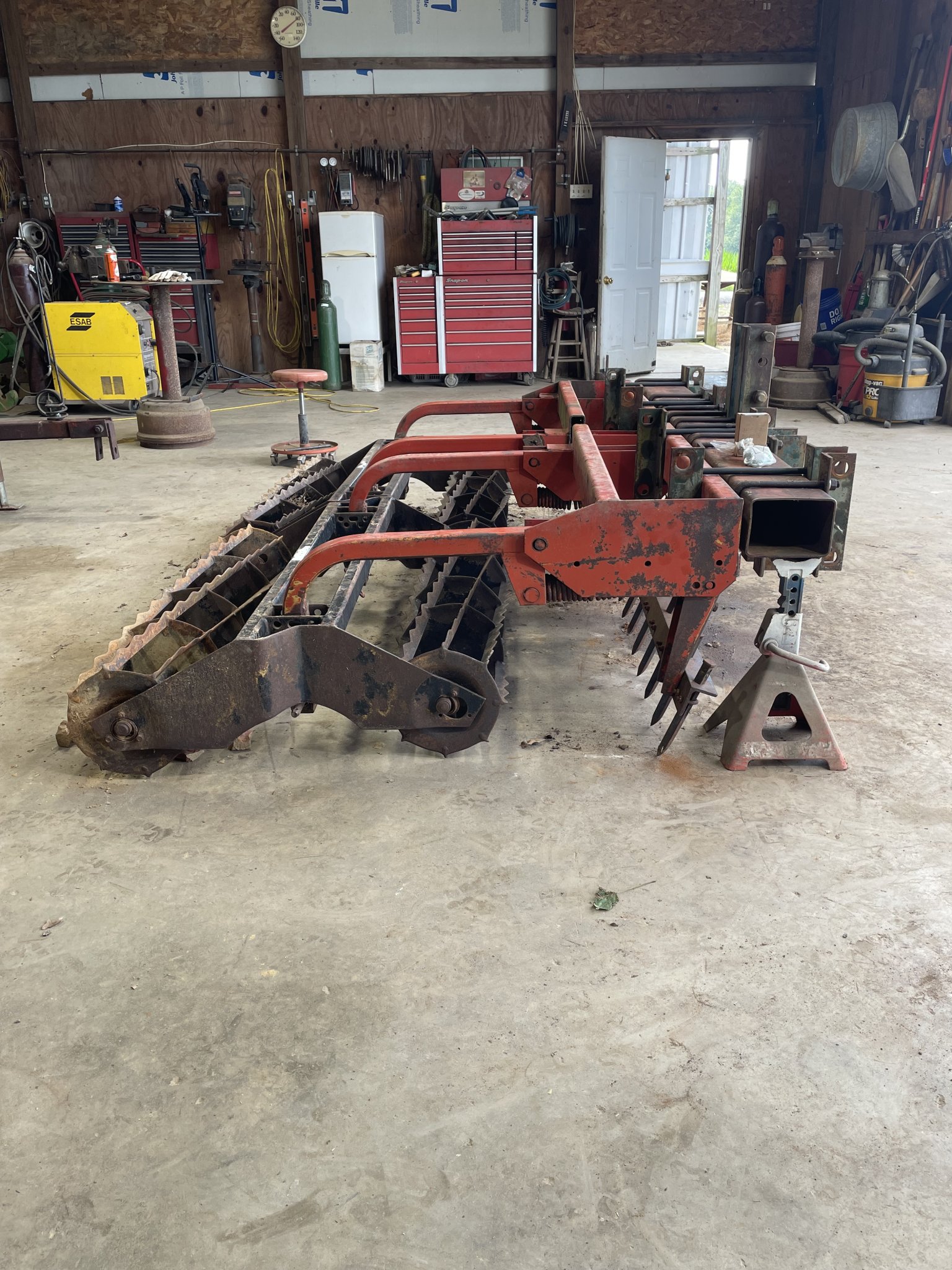

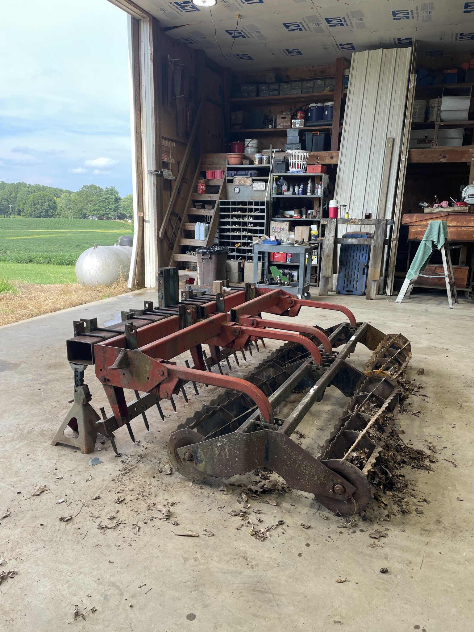

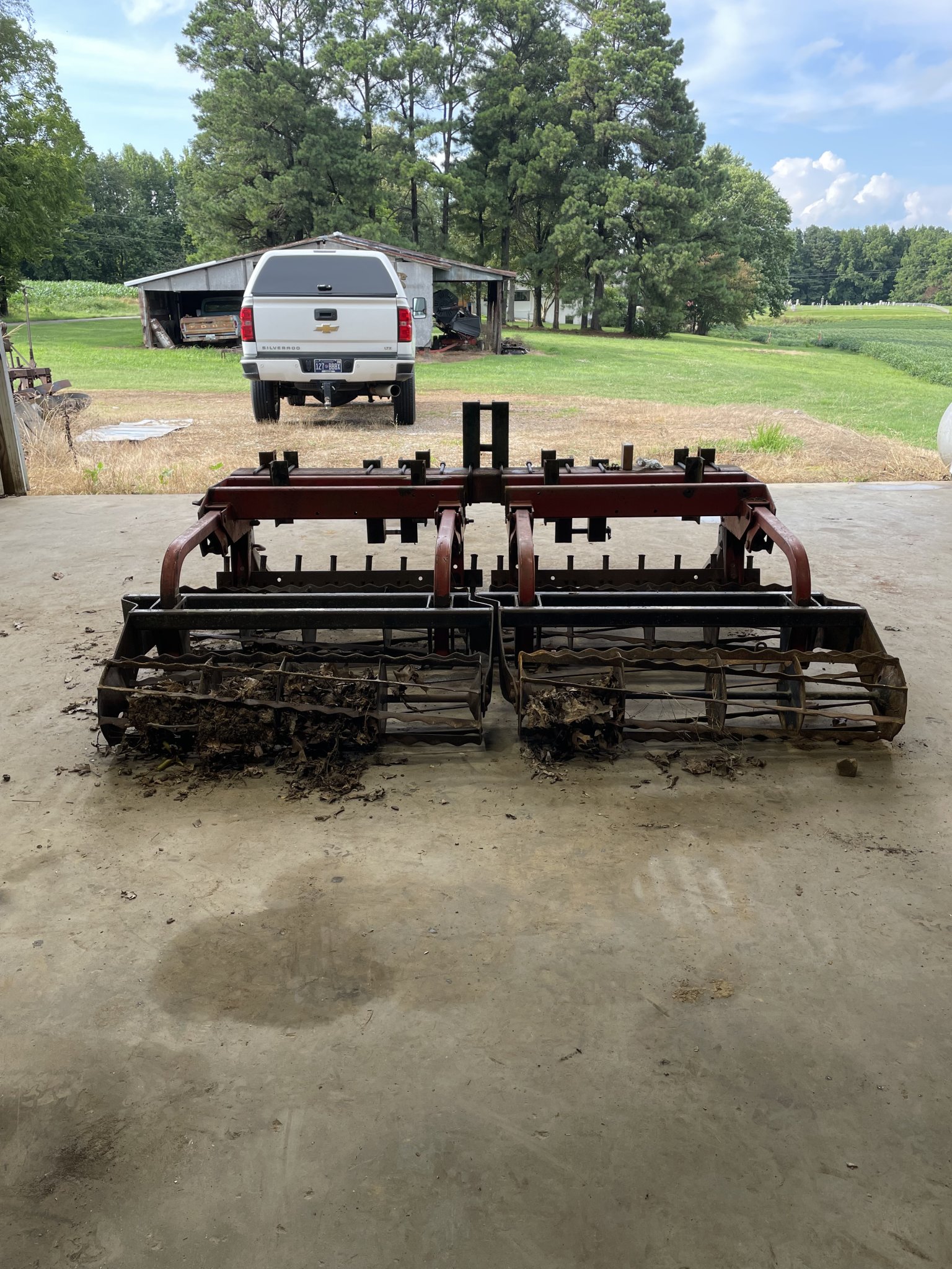

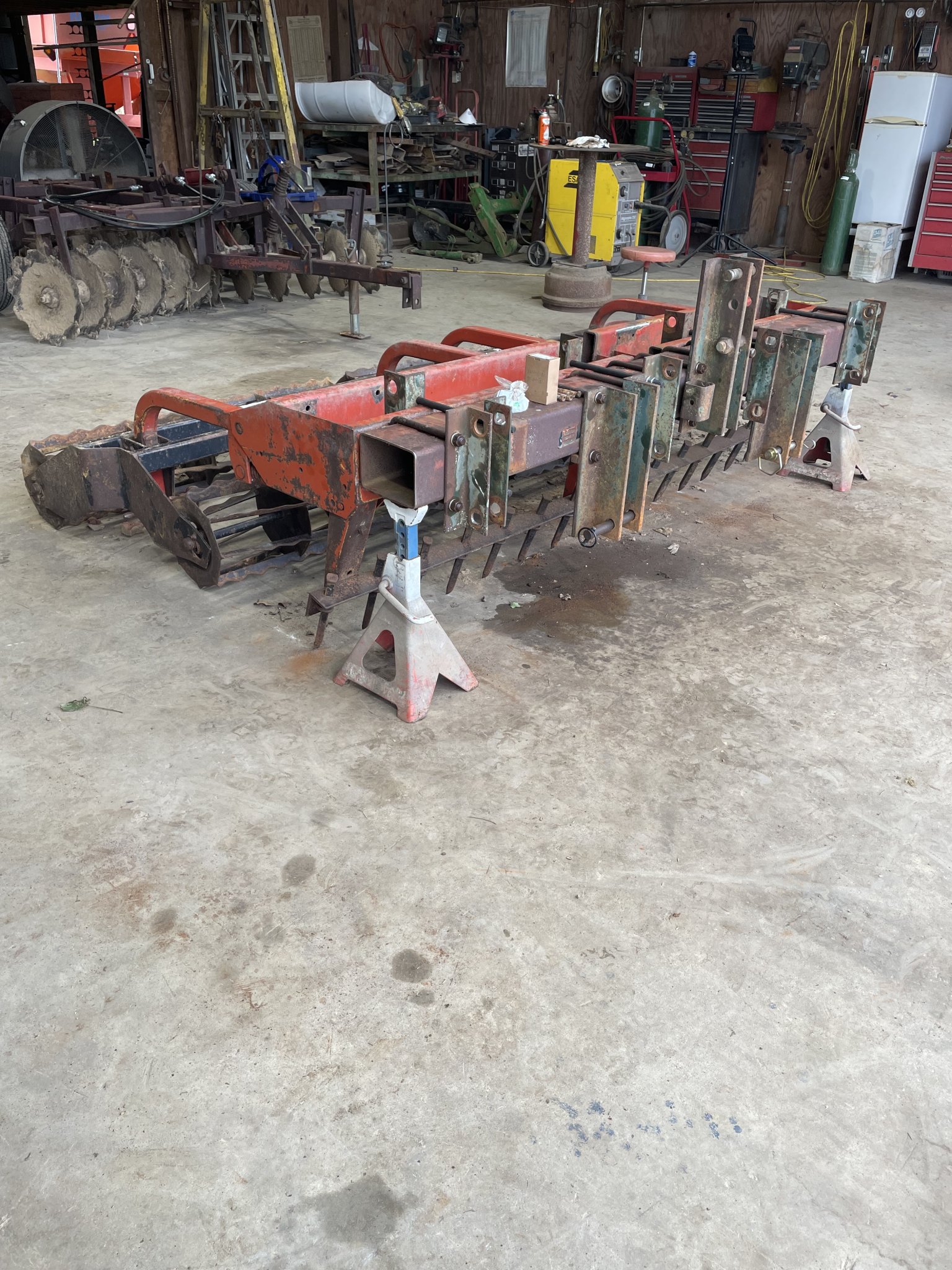

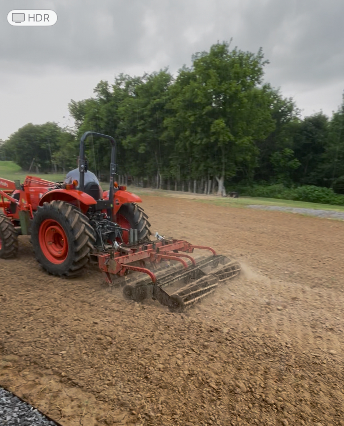

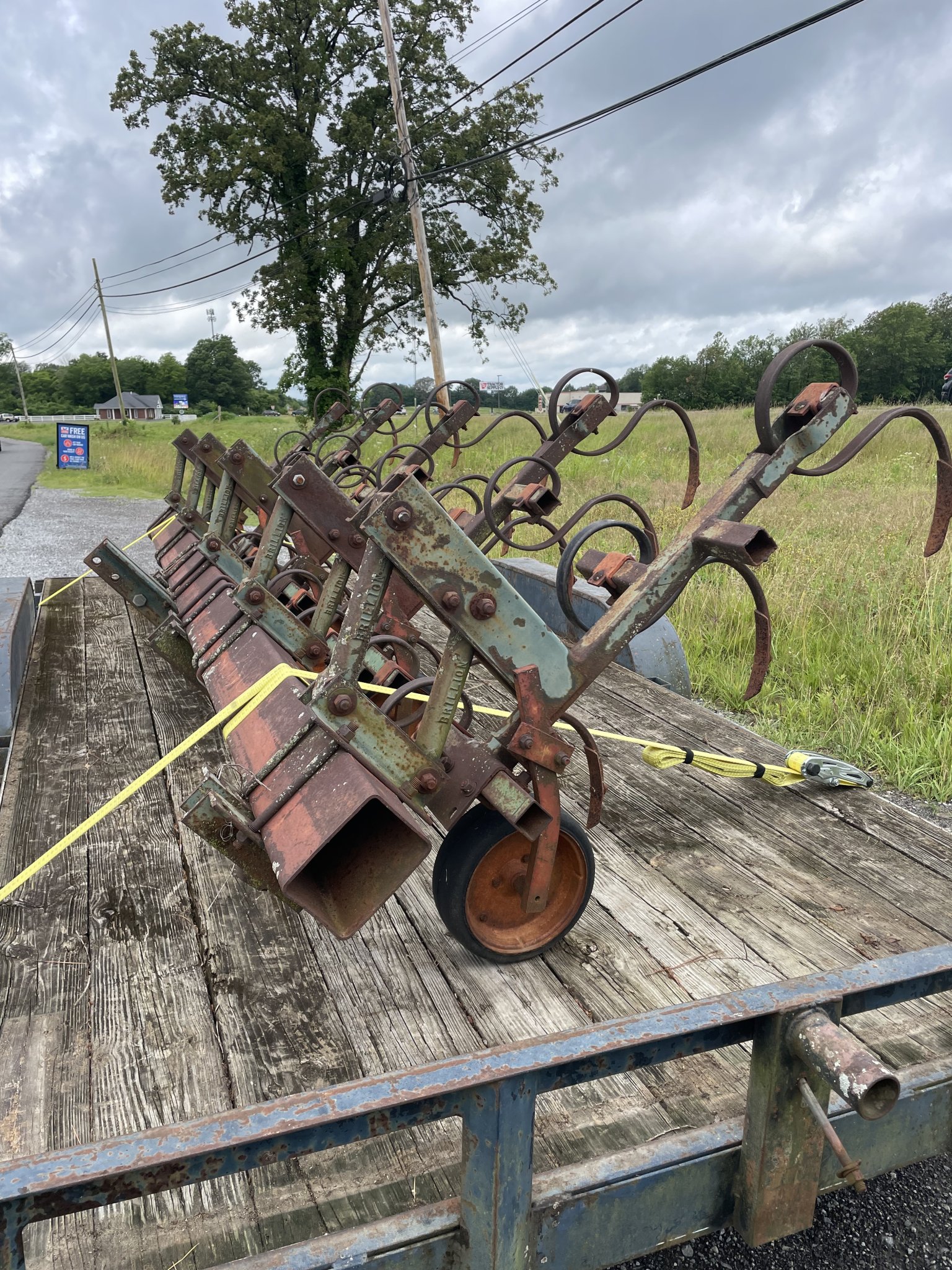

Update on my 3 pt Unverferth rolling basket harrow project. I started with a 4 row Brillion cultivator, removed the cultivator gangs and 3 pt brackets and cut the tool bar in half then remounted the 3pt brackets and added the rolling basket sections. Still need to fab and mount the 2 stands.
Now that I see it’s going to work I need to replace the 8 bearings on the rolling baskets.
Reactions: 11 users

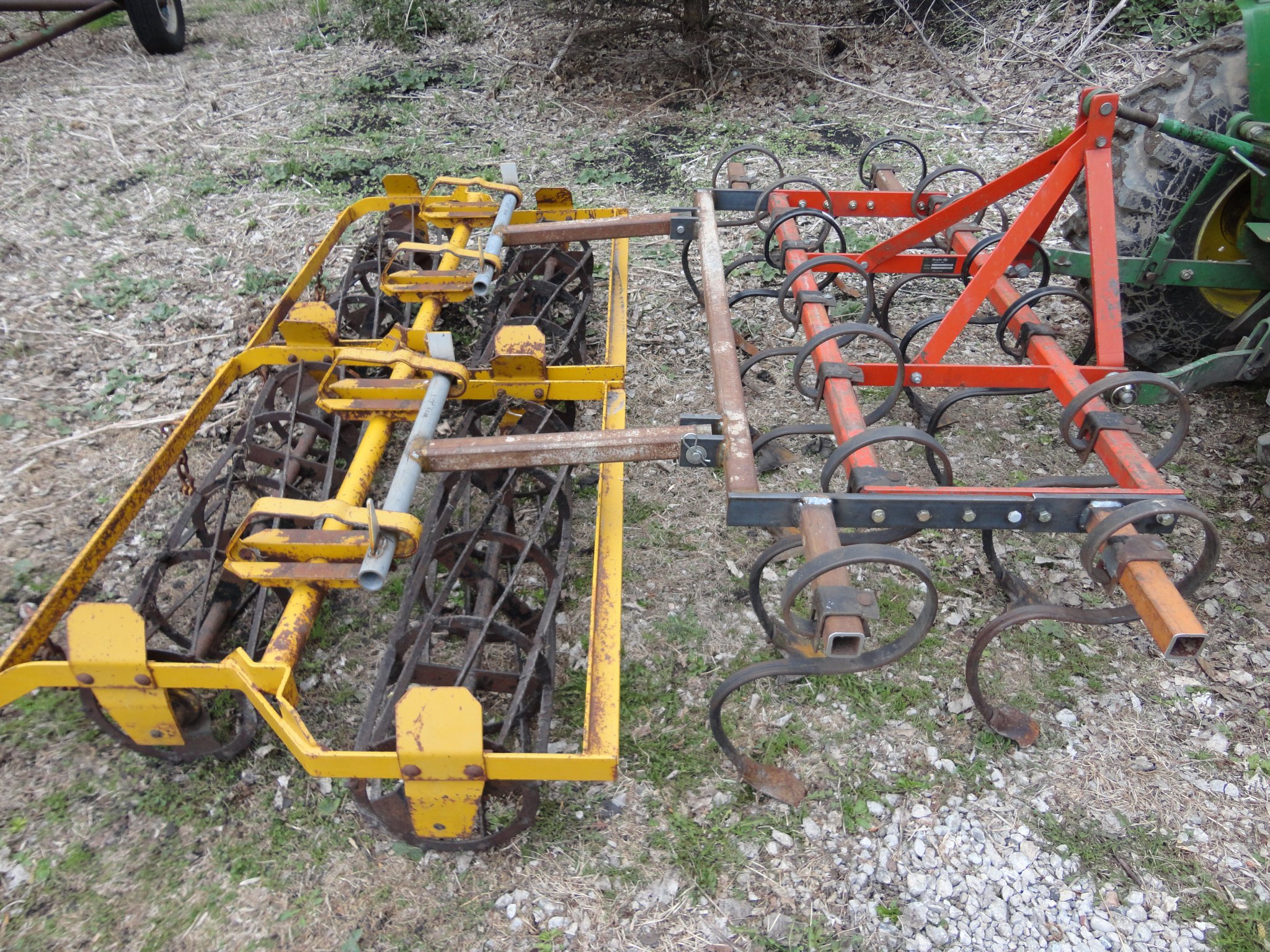

Many years ago, I turned 5 ft cultivator into a smaller version of yours to prepare seedbed for a 3 acre parcel of sweetcorn every year. 2+ ft. had to be added to the cultivator's width to match the pair of rolling baskets that were rescued from heading to the scrap dealer. I sure wish I would've saved more of those baskets!!
Does a fantastic job in our Red River Valley black topsoil.

That looks great. I’ve got 21 “S” tines from the Brillion cultivator that I intend to put on a frame like that.

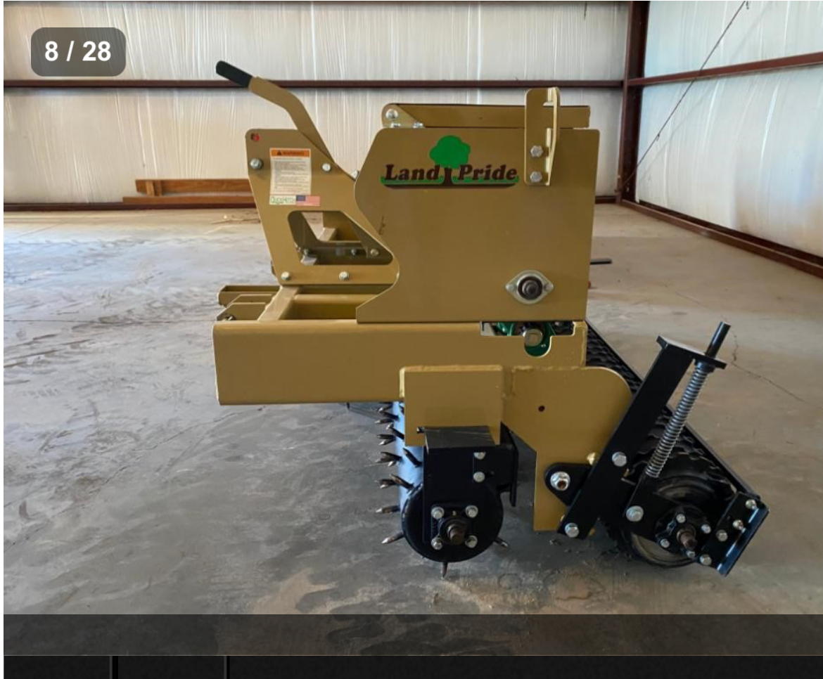

We don’t have rocks in the fields in West Tennessee. Most farmers here pull a seedbed prep tool like this behind a disk or field cultivator. I wanted a 3 pt version to pull behind my M5660 after disking to level and prep the soil before seeding with a Land Pride seeder.

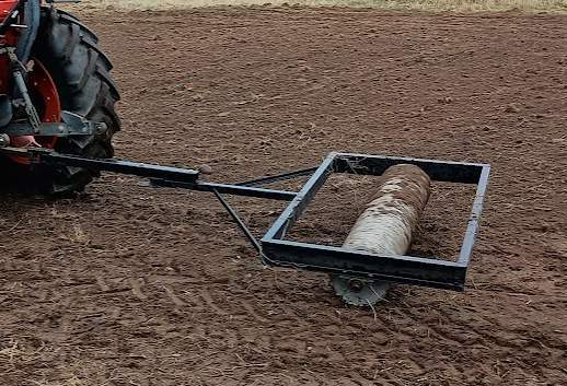

My thought would be to build a 3pt tool frame that the rollers could be bolted to and different styles chisels, spikes or such could be added as desired.. Much like the combo in WilliBills photo... All on the most ...cheap... possible..
My 5 cents of opinion..
