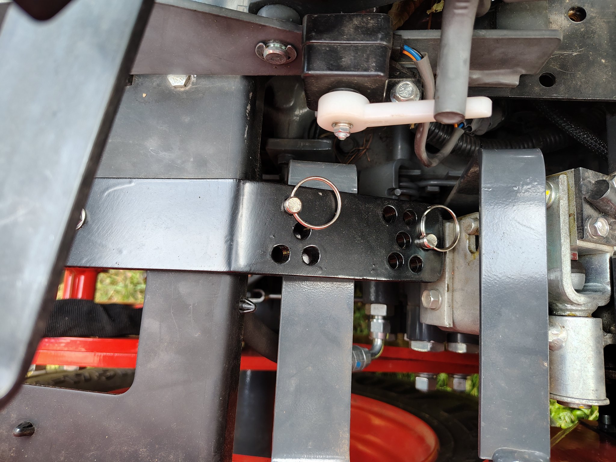

H Hammers Repair New member Equipment LX2610 Dec 8, 2024 2 0 1 Mosinee Wi Dec 8, 2024 #4 PHPaul said: ??? Click to expand... This is a stop I made for the 3 point control Not using the one on the fender (Plastic) It's adjustable

skeets Well-known member Equipment BX 2360 /B2601 Oct 2, 2009 14,650 3,493 113 SW Pa Dec 8, 2024 #5 Yeah thats cool and all but, you know a little more than look what I did, would be very helpful
Hkb82 Well-known member Equipment M7060, Ford 5600, can-am defender Nov 17, 2021 421 344 63 42 Ontario Canada Dec 8, 2024 #6 I do like a good modification but have no clue what’s going on with this one. A few more pics and description would be great.

North Idaho Wolfman Moderator Staff member Lifetime Member Equipment L3450DT-GST, Woods FEL, B7100 HSD, FEL, 60" SB, 743 Bobcat with V2203, and more Jun 9, 2013 30,872 6,901 113 Sandpoint, ID Dec 8, 2024 #7 He's limiting the movement of the three point lever. The black strap is where the Green mark is and the pins are the purple marks.

PHPaul Well-known member Equipment B2650, Pronovost snow blower, Landpride rotary mower, Howard tiller, box blade Apr 2, 2015 1,055 1,043 113 Downeast Maine www.eastovershoe.com Dec 8, 2024 #8 @North Idaho Wolfman Okay, that makes sense then. What's the white lever and the box with the wires?
North Idaho Wolfman Moderator Staff member Lifetime Member Equipment L3450DT-GST, Woods FEL, B7100 HSD, FEL, 60" SB, 743 Bobcat with V2203, and more Jun 9, 2013 30,872 6,901 113 Sandpoint, ID Dec 8, 2024 #9 PHPaul said: @North Idaho Wolfman Okay, that makes sense then. What's the white lever and the box with the wires? Click to expand... Seat switch.

jyoutz Well-known member Equipment MX6000 HST open station, FEL, 6’ cutter, forks, 8’ rear blade, 7’ cultivator Jan 14, 2019 3,094 2,131 113 Edgewood, New Mexico Dec 8, 2024 #10 My tractor and everyone I’ve seen has a 3ph lever knob that limits the downward movement. What does this do differently?
