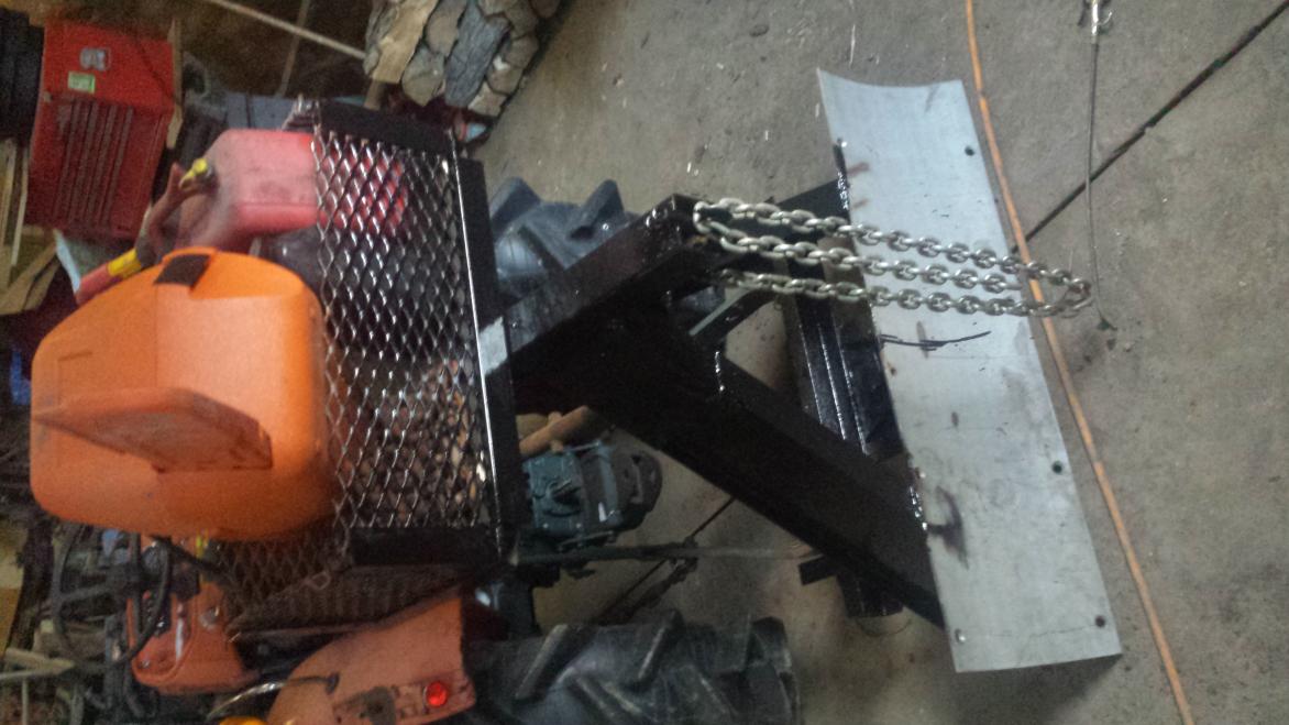

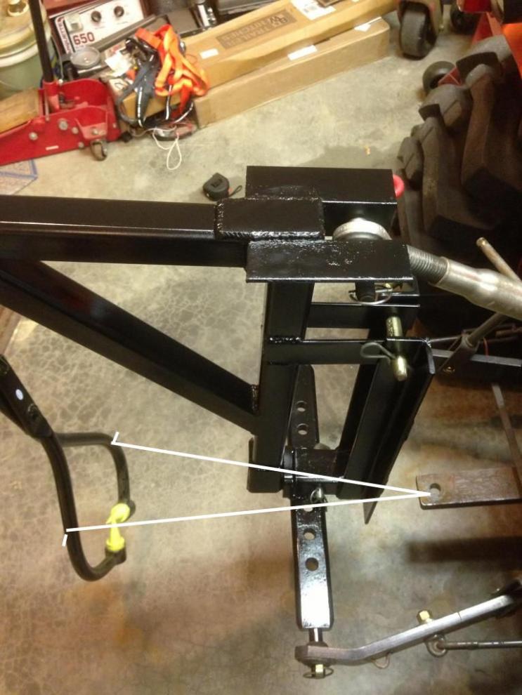

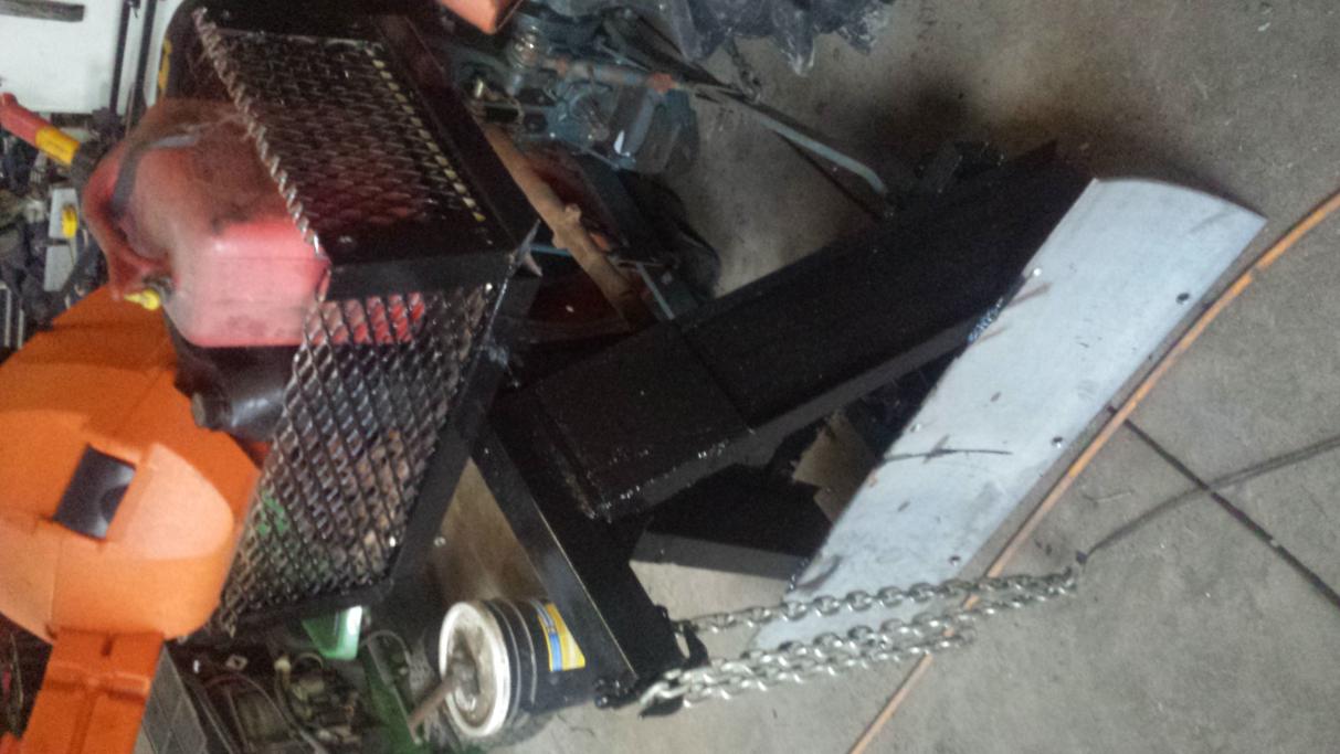

here are some pics of what i just finished up this weekend the rack that the saw an oil an gas can are in slips in an out also the hoods off beacouse the bat died an all i had on hand was an massive marine bat so had to make do the slip in box is also for my next project a front receiver mount that hold a winch an the little rack my property up north has some nasty little hills an mud pits an i figured it always nice to have a spot to hold a saw& tools and a small cooler bag for the hot summer days :D 20150110_162033.jpg

i have a two more pics but cant up load them sorry i used an old house trailer tongue for the frame <-free had the blade off an old 4 wheeler plow i had built my dad never used it he made a snowblower waste of time on my part lol so that was free drove by scrap bin an asked if i can take some of the tube its 3/16 3x3 cost me 20 bucks found the chain on the side of the road score an the mesh was kicking around when my buddy made a trailer cost of that was a few beers going to see how well she works in the am painted it friday in the cold so i let it dry by side the wood stove all day

maybe looking at it wrong but most of pull is on top link. be careful u could go ass over tea kettle

i was thinking that too worst case all add some steel down a few inchs an put chain hook ups lower tomorrow will be the test run:eek::eek::eek::eek: an will see what the rework if any will be lol

well tested it out today worked great no issues with it being top heavy the blade worked great for moving the logs around in to a row and for cutting im happy but the four wheel drive wasnt working :mad: so guess i know what the next project is :confused::eek::eek:

Looks like you did a good job at building it, and it sounds like your getting out of what you want.
The real reason that they put a "blade" on the back of a skidder is to keep the tractor from being pulled backwards when it's winching a log in, but since your using a chain not much purpose of the blade. ;)
