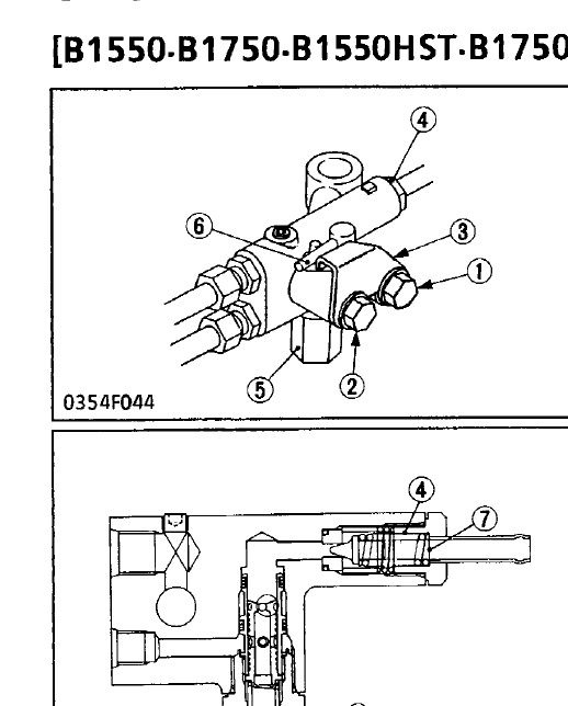

Did a little google search.. not sure what you mean by divider, as there is probably some kind of priority valve/divider for your steering circuit and im not sure whether you're talking about the same thing i'm talking about here, but..
There certainly appears to be a valve there, with a bolted cover preventing it from migrating on its own. Since you have a loader that bolted cover might be gone and the loader hooked up there. Did you try turning this valve?
yes that is the valve im reffering to, on the bottom side there is a divider valve for the PS versions. i did change that selector, which closes off the ports to the loader. it appears thats all it does. it may have made a slight improvment not having fluid flow to the loader but barely noticeable. #5 in the schematic you posted is the divider im reffering to. the parts schematic shows that port being capped off with no valve on MS versions. im thinking this valve works to give priority to steering if the steering is called for while the 3 point is also calling for fluid? im thinking there is where my problem is. maybe it's not allowing any priority to the 3 point at all but im not sure how to comfirm this?

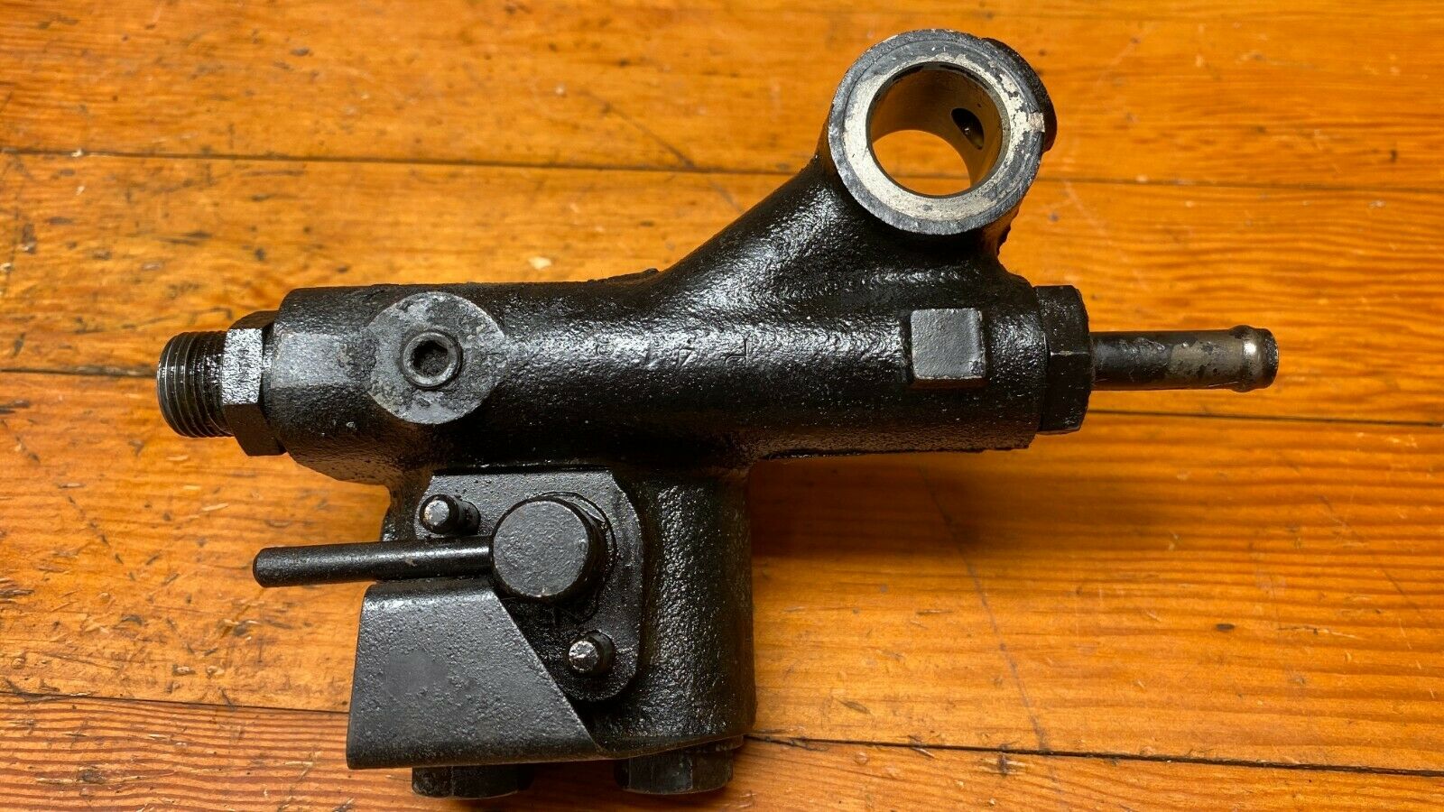

I have disassembled the 3pt valve completely. Everything looks in tact. Spool moves freely, no blockages, springs in tact. The linage for the lever and feedback rod under the front cover are operating the spool correctly. Confusing part is I don't have any pressure getting to the back end at all. I have been around hydraulics a long time but this is stumping me. Oil delivery to the back is there but even the line that feeds the rear won't build pressure. I removed the feed line on the 3pt valve, ran the tractor and was able to plug that line with my finger. I would think the pump should easily build enough to blow the fluid right past my finger but it doesnt

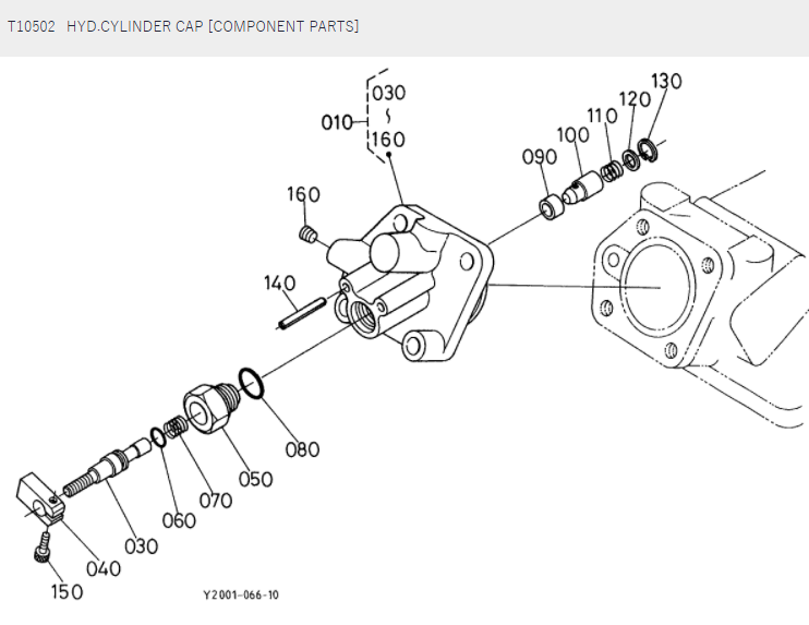

No the cylinder cap has the system pressure relief valve in it, not the diverter valve in the front.
You will need to give me the tractors serial # for me to give you the right Cap diagram as there was three different ones used on that model.
i dont have the serial number handy, but the cap is this one
if there were an issue with the valve in the cap wouldn't the 3PH drift under a load? it will hold weight for much longer than i would ever expect it to...
No it's not the control portion, it's just the pressure regulating portion.
The control portion is on the side, I'm not saying you don't have a problem there.
You will need to pull the cap to see if the poppet is stuck or contaminated.
