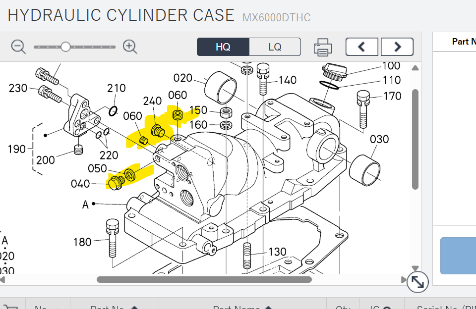

There is mutiple ports on the three point that could possibly go straight to the cylinder to be able to add an accumulator.

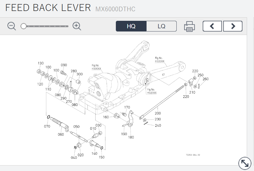

Now here in lies the underlying issue, feedback linkage.
Everytime the three point goes up the linkage tells the valve to go down, and vice versa.
So on every bounce it trys to recalibrate the three point position.
Adding an accumulator would throw that process all over the place.
And more than likely just cause it even more bounce.

thank you! will look into this....is it the san=me for the HST model?? because we have exhasted looking for a port in the hst version, DT might be different?.....
There is no DT version of that tractor, it was only offered in HST and HSTC
